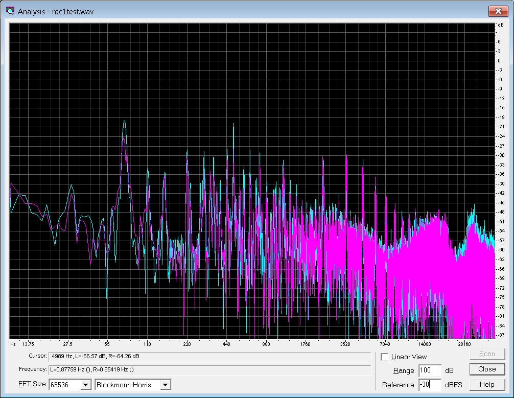

Here is the spectrum of an unequalized LP (a fairly "hot" Italian film score with a mix of synthesized and acoustic instruments) at a fairly middling point of dynamic range. The hottest points struggle to get 35db between 20Hz and 20kHz. Hard to argue the lows are getting a lot fewer bits than the highs. BTW the recording is DC coupled, the digital RIAA had about 10000 lsb's offset, and the sound is not "obviously this can't work". Music has a spectrum that falls as some low power of frequency that mitigates the raw 40dB of the RIAA curve. 1/f would simply halve it to 20dB and it starts to be a don't care.
