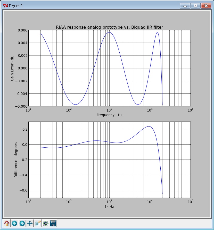

Is there any difference btn a certain analog filter and it’s digital IIR implementation?
Very little, the z transform is an analog of the Laplace transform in the s domain. In the limit of infinite sampling frequency they are equivalent. For finite sampling frequency the poles and zeros (including the zero at infinity) are "warped" to a best fit. See below RIAA at 96k with single biquad IIR. Of course the error increases as you approach Nyquist but even at 44.1 only two biquads fit impressively out to 20k.
