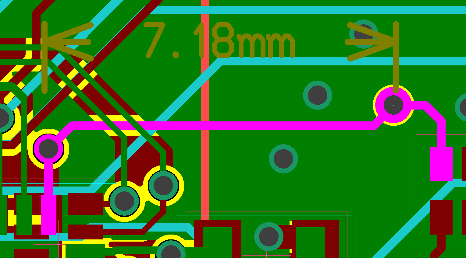

I have been commenting on this on many clock modification threads, considering how critical clocks are it breaks my PCB heart to see the poor signals being abused so.....

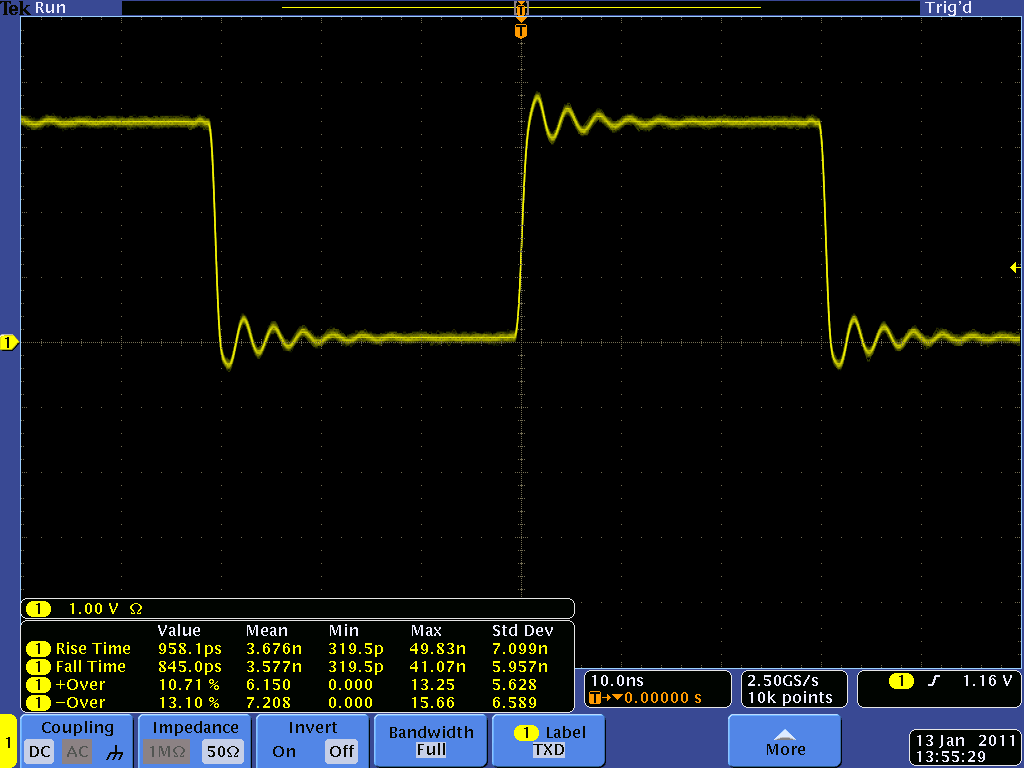

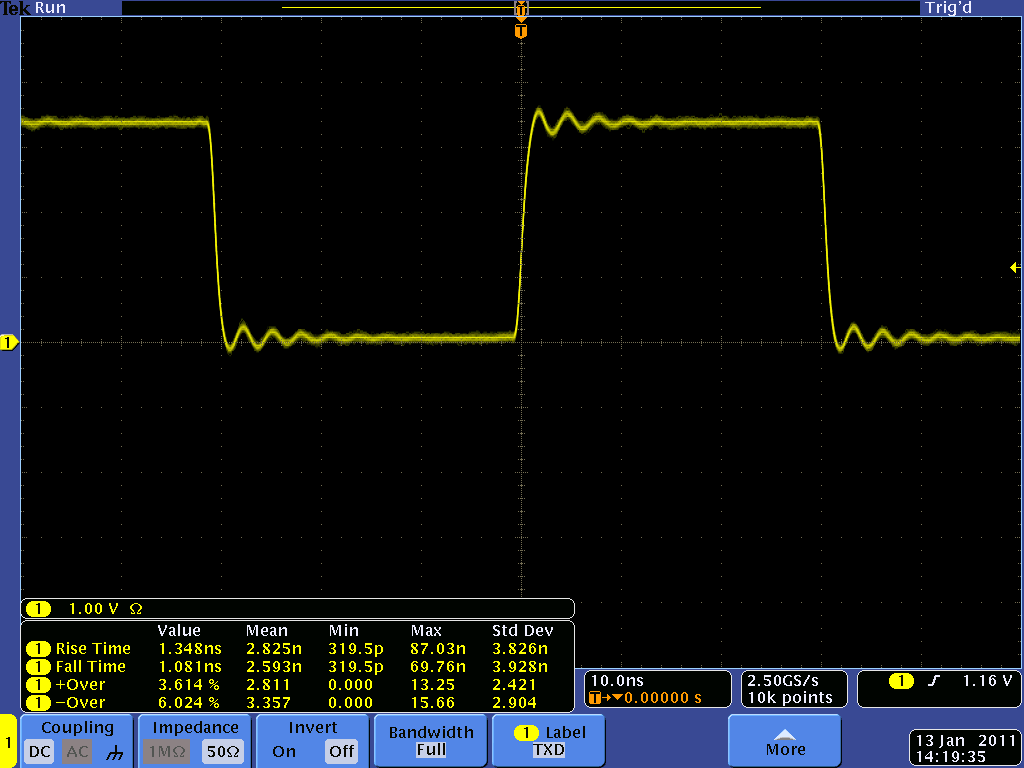

My point is that, before you make comments from the 'high up in the industry' bla bla, 'I know better', 'see my medals' and so on, you should at least once get your sleeves up and try it in practice.Now your point is?

Anyway from up here in the high and mighty world of electronics are some screen shots and a picture of a layout showing even with slow clocks and short distances you can have problems. In this case the oscillator was driving directly into the resistor in the pack and going to the IC a few mm away. The problem was the drive strength of the clock signal, the plots show the effect of changing the series termination resistor value and its effect on the waveform.... I could get my hands dirtier but don't know whether I am worthy😛 as I have more such practical info.
