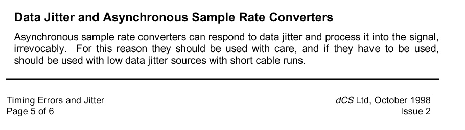

.. what is the most likely #1 jitter bug to fix and how?
Interface between a digital source such as a CD/DVD/Flash player and the D/A converter.
Fix #1 - use 'all in one' unit.
Fix #2 - put the master clock inside the D/A converter, close to D/A chip and slave the playback device to this clock.
N.B. I don't think your Benchmark is the right tool to evaluate jitter, it has two ASRCs on the input. Sorry.

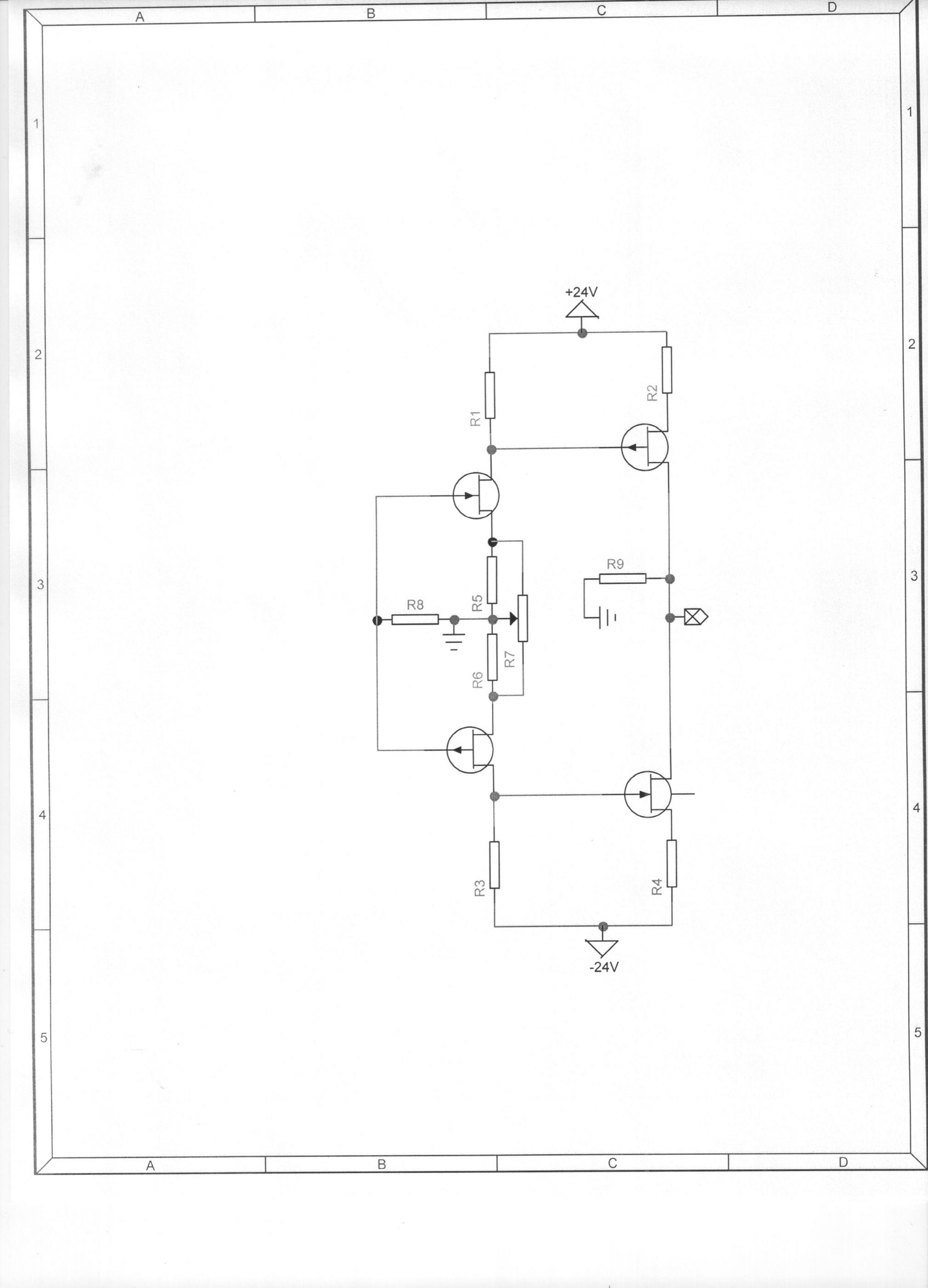

OK, here is an alternative input stage, that is actually more practical, and 'forgiving' when it comes to making it work. The second stage can be jfet, bipolar, or mosfet. All will work with a little resistor adjustment:

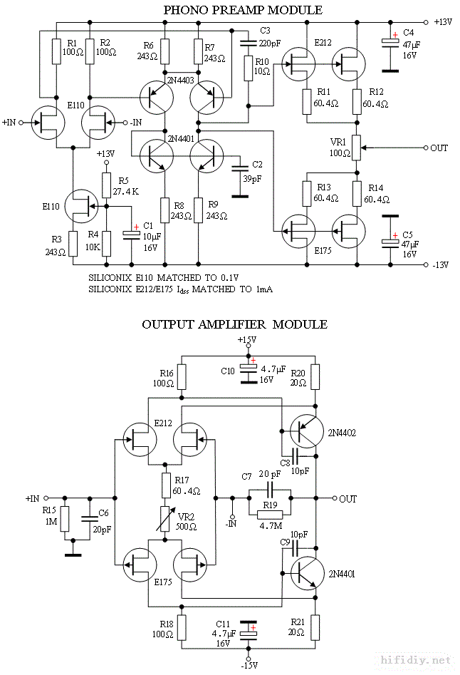

I can't help that P channel jfets are more difficult to find and are more expensive than they used to be, I will only recommend circuits that use them. All of my discrete designs use them, and this has been so for more than 40 years.
Personally I think that this 'easier' design while the common input for many popular amps and preamps, is actually too 'touchy' for everyone to use successfully, and I recommend a Levinson JC-2 type circuit instead.
