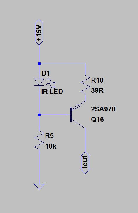

Distortion and DC drift are secondary to changing the supply voltage. However the supply resistor would have to increase to 600 ohms or more to keep the Idle current of both the first stage and the cascode stage about the same current.
Let's see if any of you can recommend a QUIET 25ma current source, that will replace the supply resistor without adding noise. Any suggestions?
This current source would work IF you don't care about input noise. Unfortunately, current sources have noise gain, and it would probably overwhelm the noise contribution of the input stage since they sum together. Think of the current source and the input fet as part of a mixer where both contribute their noise.
reconfigure circuit for self bias.
