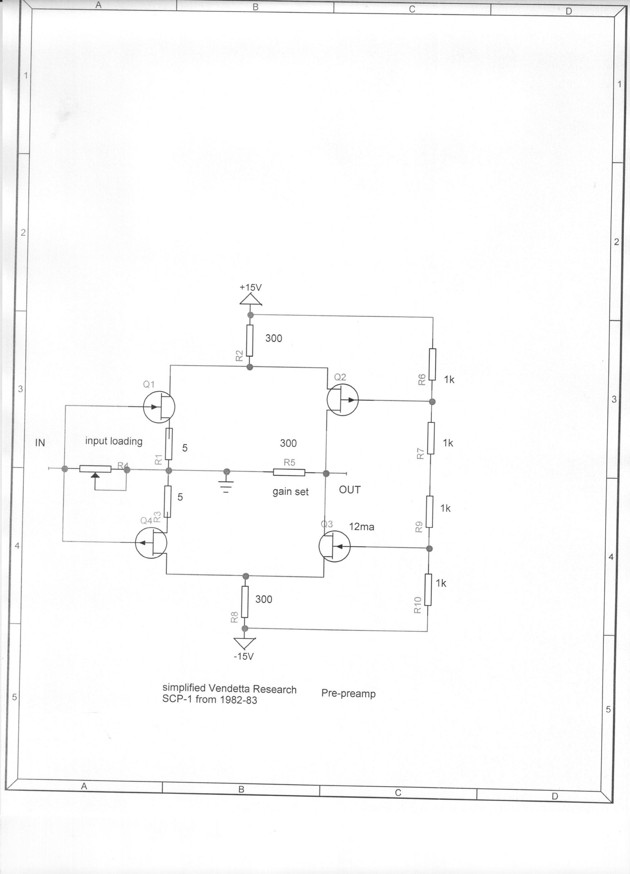

I am going to start with a sample of what I often use as a phono input stage. It is simple, but it is elegant as well. Let's go through it as 'engineers', piece by piece. You know, the good, bad, and elegant! '-)

One suggestion. Concerning PSRR and distortion. CSS to replace drain resistances ?
And a question about the need to pair active devices (expensive).

Ok, let's look into this circuit with more detail:
First, it is a potentially VERY quiet input stage as both input devices are in noise PARALLEL, not noise SERIES like a diff pair.
Second, the circuit has little or no cap multiplication, because the second stage is actually a cascode of the first stage.
Third, the complementary circuitry will attempt to null out the even order harmonics developed by the input stage.
Fourth: The dynamic range of the input stage can actually be extended by using even higher voltage power supplies, if necessary.
This is the essence of the Vendetta Research input gain module. It has been very successful for more than 30 years.
Later, I will address the 'downsides' of using this sort of circuit. But let's discuss the circuit, in general, first.
