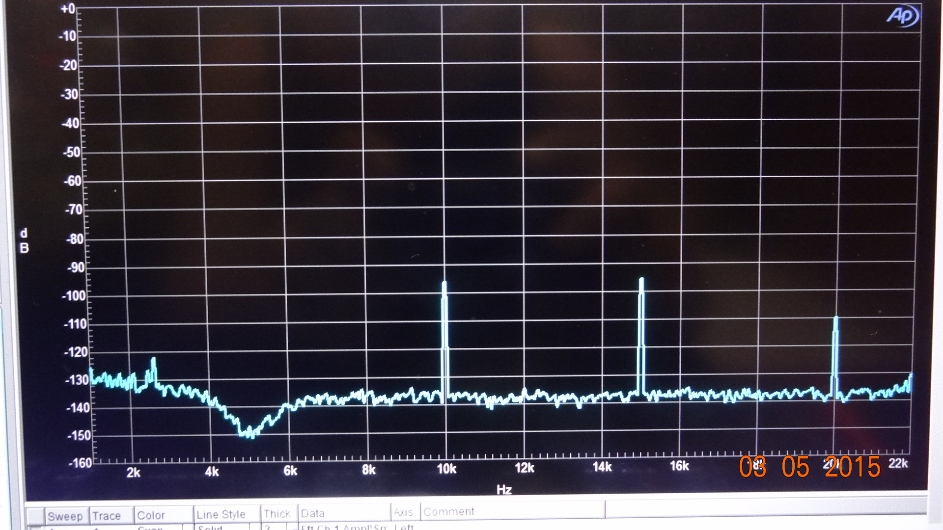

DADOD's DIY amp on another forum at 100W/8, 5KHz THD = .0024%
Pretty nice. BUt the distortion was 10X higher until I rearranged the various grounds... always seems to be a problem with testing.... using isolation transformer on A-P and battery on the PC etc. Then you get lowest data on FFT tests.
Makes me wonder again if distortion will be higher when used in a complete audio system. Thats why I use isolation transformers along with filters on ac line.
THx-RNMarsh
Richard, how did you connect the loudspeaker (load) ground wire, to the PCB connector or to the common star ground?
I don't expect higher distortion with the amp assembled in the proper case and with proper power and ground wiring.
BR Damir
