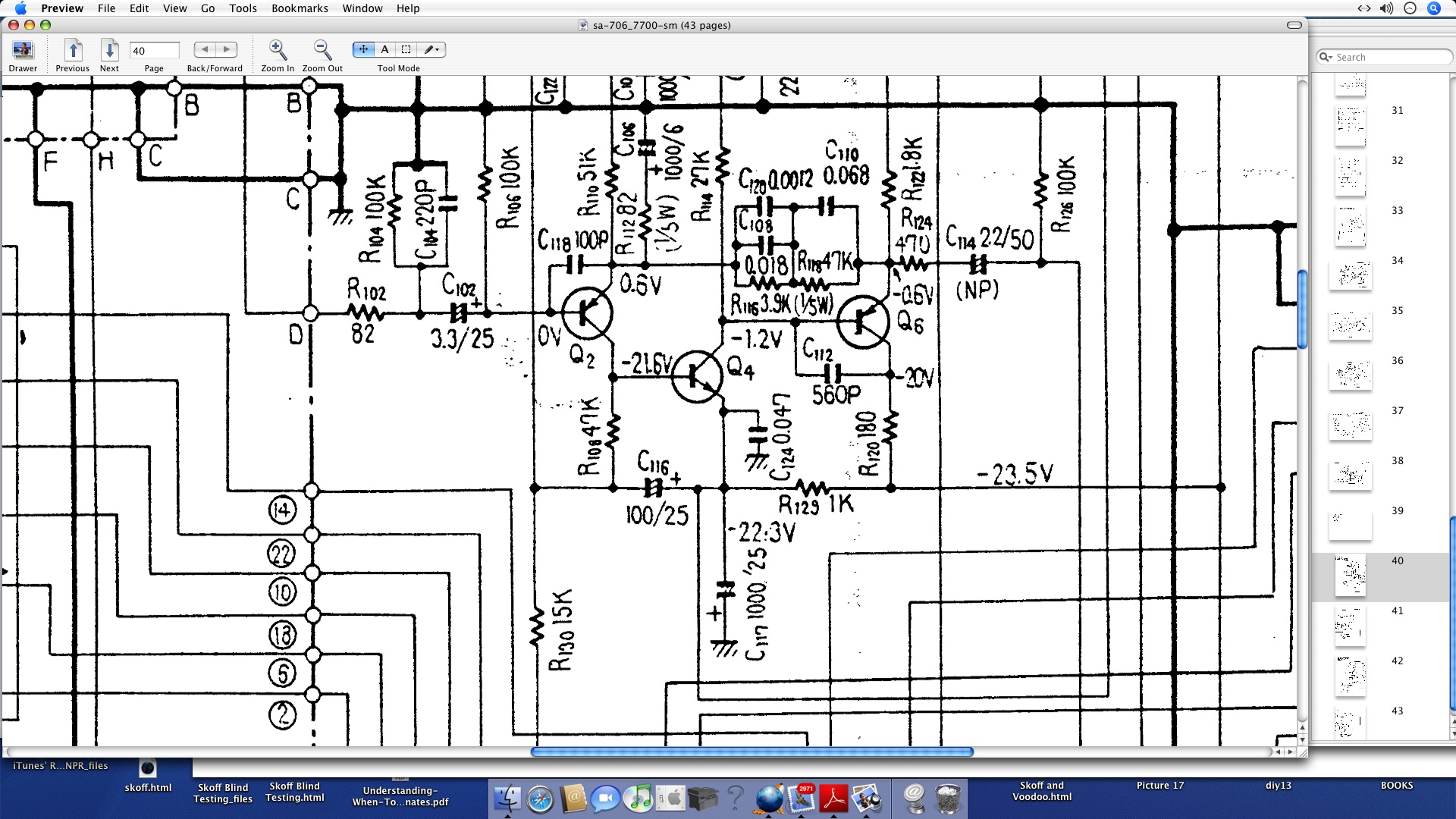

Here is SE's reference phono stage from the Pioneer.
Pretty good for 1968. Ampex would have done the same. Anybody want to emulate it on LTSpice? '-)
Note the electrolytic caps.

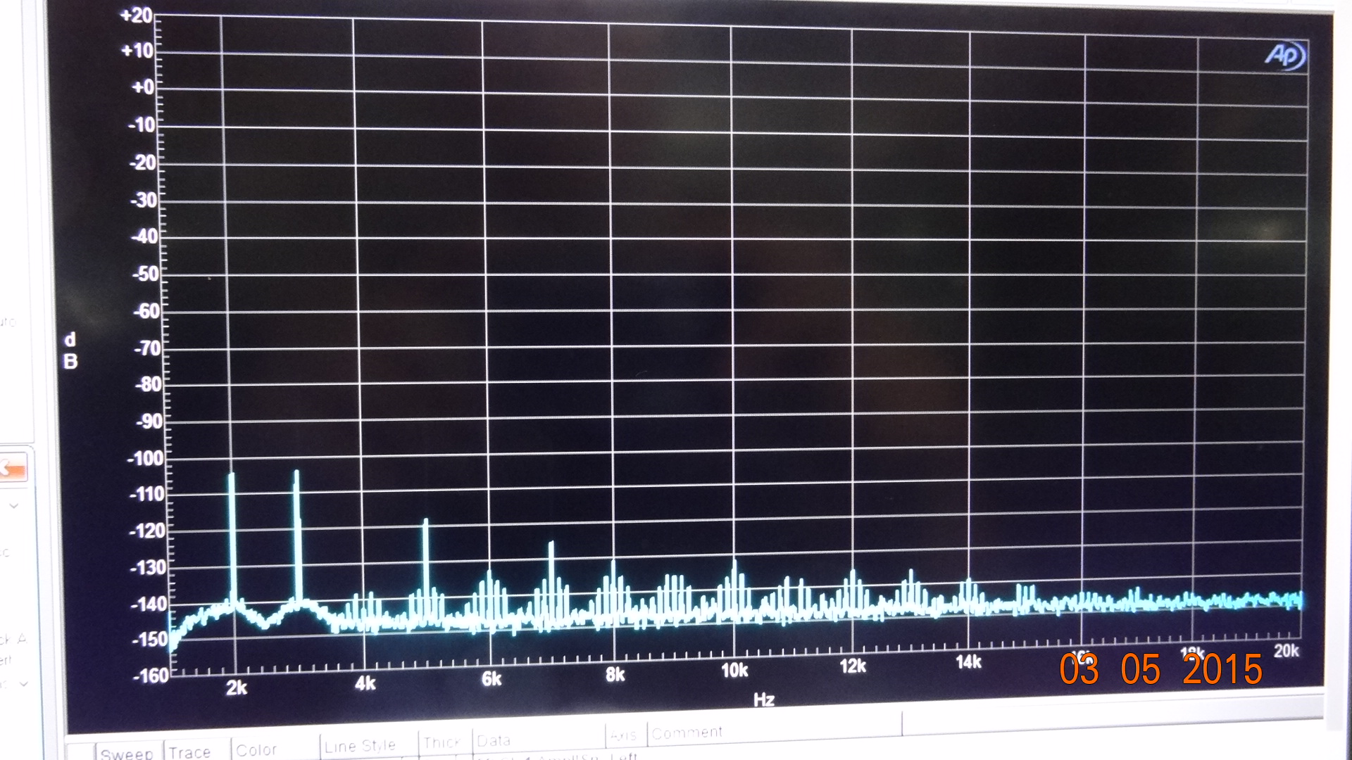

While SE is saving the world from his perceived and imagined evil doers .... the audio axis of evil conspiracy, I have been measuring Dadod's new power amp. It does not increase but a very small amount from 1W to 145W/8.
Here's just the latest sampling -- 145W/8/1KHz FFT >
1w is below -110dB 2H/3H.
Some PS ripple/modulation freq might be in there as I use two SMPS (at -135dB).

Eeewwwww...Second attempt: This is the phono stage for the Pioneer SA-7700, clone it if you will:

Eeewwwww...
OMG!!!
Now we know what we ought to be using instead as the Grand Master -SE- has blessed it for our use.
No Cred at all left. Better stick with selling expensive wire.
