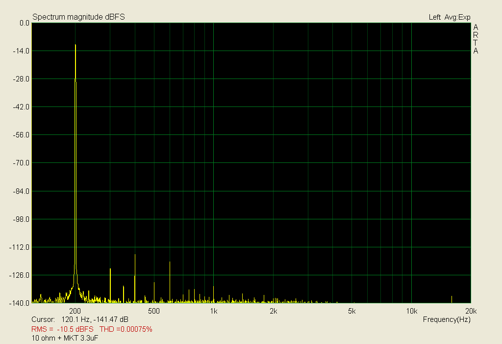

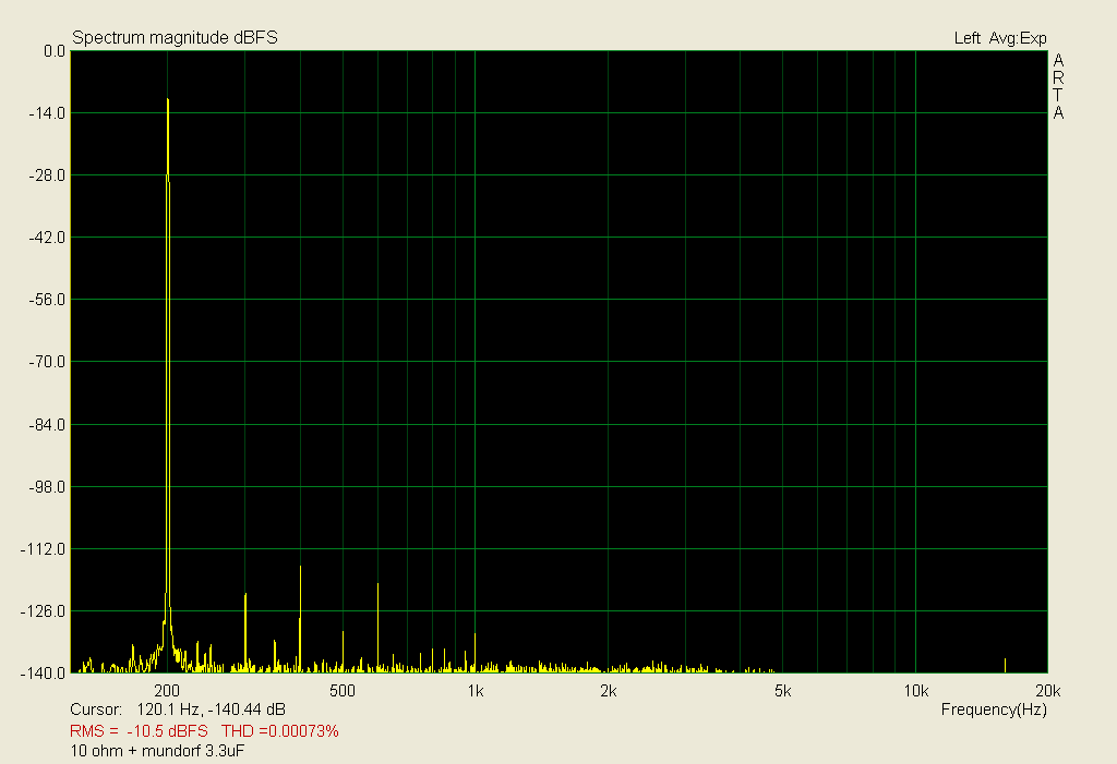

Tried something more practical, R-C filter, 10 ohm + 3.3uF, at 200Hz, capacitor voltage is 5Vrms. I have checked Mundorf MCap Zn and Roederstein MKT, both 3.3uF. Both are excellent, distortion is below 0.001% and is affected by the method, so the capacitor distortion is probably even lower. So even MKT (polyester) caps will make a good job in a speaker filter.

Obviously your results are flawed, because they show that same spike I often get in my setup between 10-20K. 🙂. However it seems you either found a really good pair of capacitors and/or you are at your limit of testing.

I am at the limit. When I measure voltage across the resistor (previous measurement was across capacitor), distortion is slightly higher, about 0.013%, but again same with both capacitors, and again acceptable for use in crossover filters.
THD vs. frequency, measured across the 3.3uF capacitor, was below 0.002% through whole 20Hz - 20kHz range.
That 15.625kHz spike disappers when I put the filter into a shielded box.
Or put the CRT TV into a shielded box. 😀
