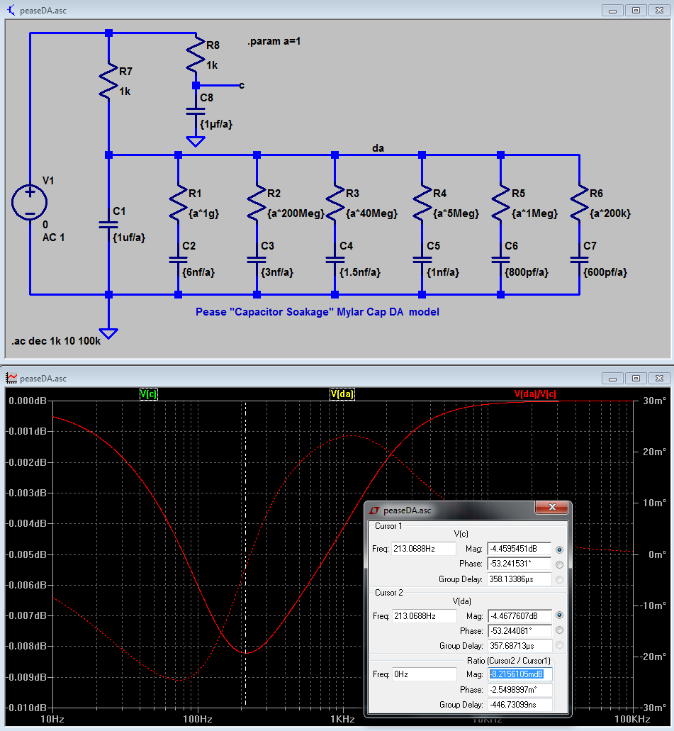

some still seem to hold out for DA "linear distortion" being audible
Pease' Capacitor Soakage article gives a multiple term DA model of a 1.0 uF Mylar Cap
I put that model in a low pass with 1k Ohms ~ 160 Hz fc - not so different from a approximate RIAA EQ
then plot the AC ratio with a "perfect" Spice Cap
as I predicted the max deviation from "bad" Mylar Cap DA result is in the milli dB: 8.2 mDb @ 213 Hz, ~25 mDegrees max phase deviation, ~1/16" air propagation distance group delay deviation

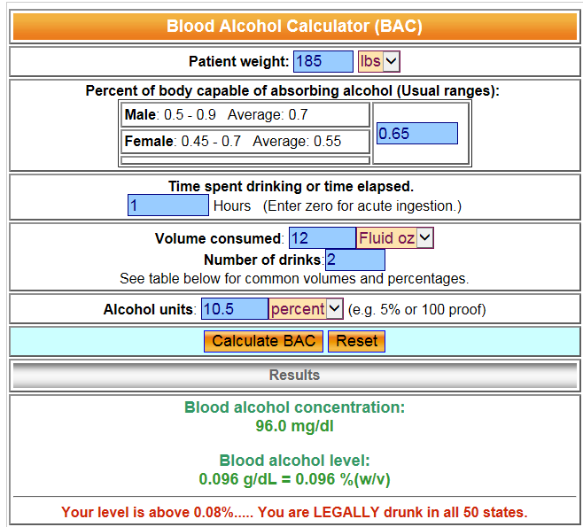

(your results may vary since I had a New Holland Dragon's Milk and a Founder's Curmudgean while preparing/with dinner while working up the sim...)

Did you try it with a model for an electrolytic capacitor as that is what is under discussion.
For the umpty umpth time, the question isn't the measurements, it's the interpretation and the unsupported claim that DA is the source of nonlinearity. Why is that so difficult to understand?

Of course, the external signal seen when DA is present will depend on the external impedance present. This is because the DA in the cap is driving the external circuit, from a relatively high impedance. If you define DA to be what you see, rather than what is happening in the cap, then confusion is likely.
The net result of the paper seems to be that if you put a low frequency square wave through a filter the output waveform is slightly different from the input waveform. Interestingly, it also admits that DA is "often essentially linear".
RNMarsh said:
the difference lead to speculation it was DA to explain the waveform shape difference..... that led to my DA tester. The conclusion of it all was things just sounded better with film and best with no cap.
Here we go again! Why are people surprised when a filter modifies a waveform? Why do they then conclude that this must be audible and unwanted? Why do they call it 'distortion', and hope we don't ask too many questions about whether it was linear (i.e. no distortion) or nonlinear (i.e. distortion)?
Perhaps there should be a law forbidding people from buying or making sensitive test equipment unless they can first demonstrate that they have the understanding to correctly understand and interpret the results of their tests. Otherwise we will have a continual run of people frightening themselves with waveform 'distortions' which are actually just mild filtering.
My conclusion remains: DA does not cause distortion, but DA combined with asymmetric waveforms may expose existing nonlinear distortion by adding a bias thus providing the needed asymmetry to convert odd order nonlinearity to even order nonlinearity.
