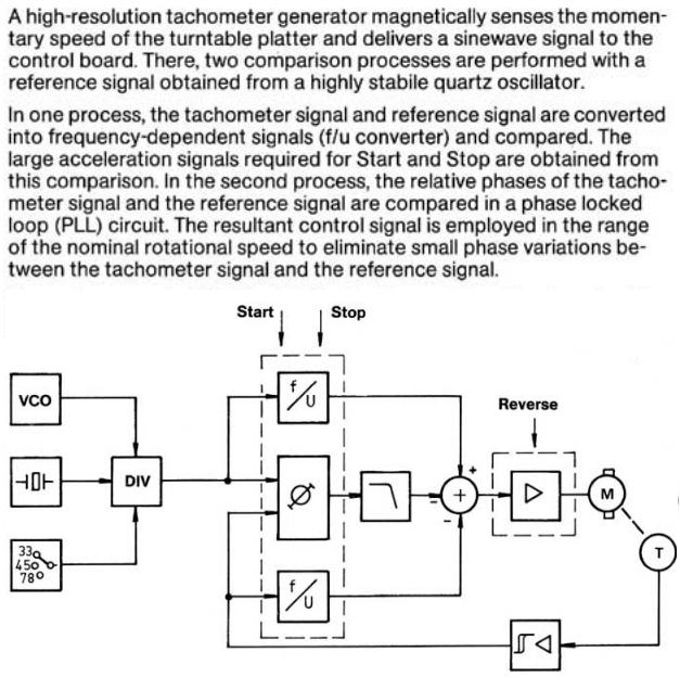

See attachment.
You are right doubting the 0.012% Wow & Flutter number (note the asterisk)
George
This argument is circular (pun more or less intended): if the sensor (typically a multipole magnet combined with a "Greek pattern" [don't know the exact english translation for that]) is imperfect, but the servo system is perfect, this will result in W&F at the mechanical end, with no discernable flaw in the tacho signal.George, as it is direct drive (no added mechanics like pulleys and belts to add effects of eccentricity), what better method than to look at the PLL level to measure the speed errors ?
Anyway, if I cannot hear any wow, it is good enough for me ;-)
I am sure the tacho system has been made with great care and accuracy, but it cannot be perfect.
The only way to properly assess deviations is to use a completely independent measuring system (but then, the specs will be dulled to some extent)

That is a logical question. The answer is as follows:
The number obtained by taping the PLL refers to turntable assy alone, excluding effects of record, cartridge or tonearm but including platter.
You may freak out but Wow & Flutter measurement per JIS, IEC, DIN is affected by arm/cartridge resonance (for a good reason), record eccentricity, wrapping and of course by actual rotational speed variations, the later –ironically- weights only a little to the total number. The reason is that the weighting curve is centered around 4Hz and slopes down quickly on both sides. Read the whole story on pages 6 to 9 in this classic paper

EMT had a platter only apx 200 gram on the 950, but the electronic simulated a 8 kg platter, this way they reached very stable conditions, from 0 to stabel locked in 33,33 this machine had only 200 mS.
( many Experts say this was the cleverst DD ever done).
As with the later models 938, 948 (see attachment)
