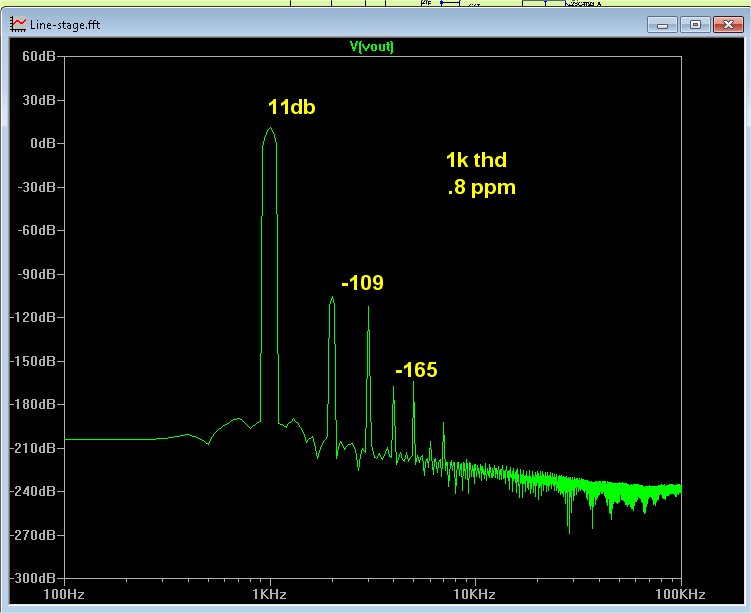

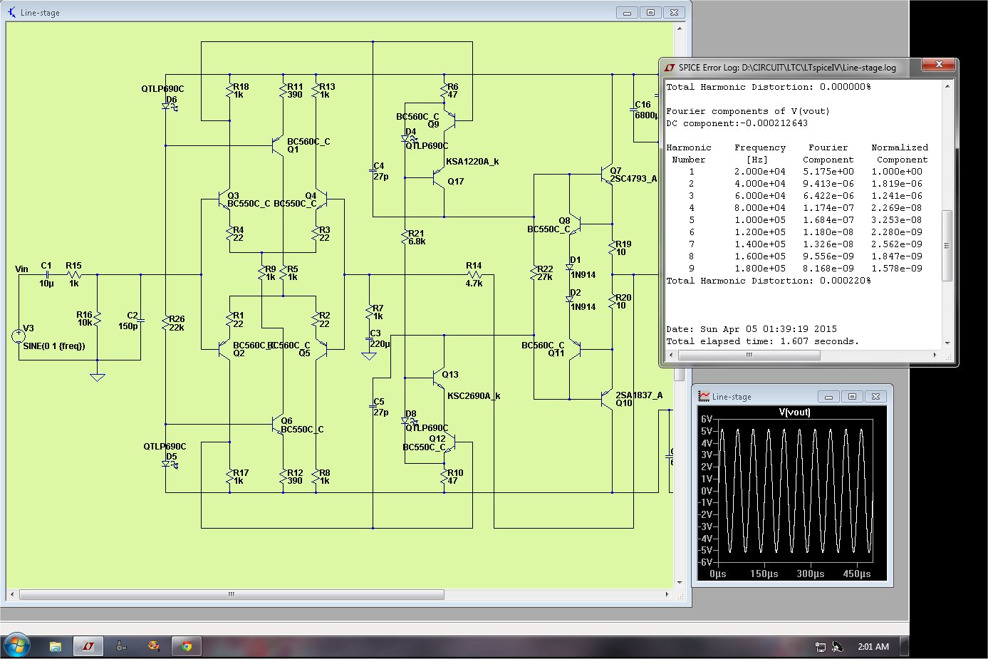

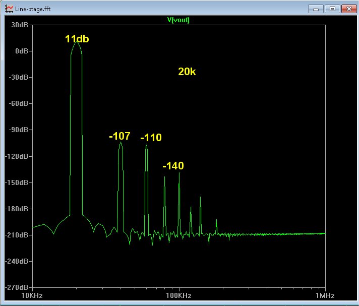

I had lots of iterations of this most copied circuit. I suppose the fact so
many Chinese kit makers copy is the ultimate "flattery".
I could not get the basic JC-2 below .01% THD20. The Jfets and it's utter
simplicity might be the reason for such a "following".
Going from the 200W amps to a class A line-stages was fun. I could run
everything hotter , use low Vceo/low noise semi's .... and have a class A
output. 😎😎
Symmetric is the way to go ... the leach/hawksford circuit did 2ppm-20K !
(below)
Sub -PPM at 1k - a nice 5X "wire with gain".
A Jfet cascode did the same (almost). Jfet models are crap - still <5ppm.
The hawksford was the real change that made the "bottom drop out"- THD
wise.
I'm going to build it ! (any ideas - never built line stages , just big amps)
OS

Ok, so how does the sim report with variable source impedance...ie, connected to the wiper of a volume pot, say 5k, 10k, 20k, 50k at differing pot positions ?.I'm going to build it ! (any ideas - never built line stages , just big amps)
OS

Some thoughts from following along your journey in topologies ---- one thing seems never got resolved was the Slew Rate and what differences it made to subjective results.... using very low thd (<-100dB) and same topology. High SR vs minimum (.5v/v - 1v/v).
jFET models are crap and so are many compliment jFEt parts available. A real problem for symmetrical topologies..... causing circuits to get more complicated for low distortion.
Never- the-less, selection of jFETs in the simple circuits is absolutely a requirement for lowest distortion in practice. Relatively simple circuits have produced -120dB levels (measured) with selection and trim. This isnt practical for mass production but it is for DIY or limited production HiEnd construction products.
Since, you, myself and others have shown you can get 'The Numbers' in many forms of circuitry, the circuitry/topology with the fewest parts while maintaining highest performance levels, wins IMO.
