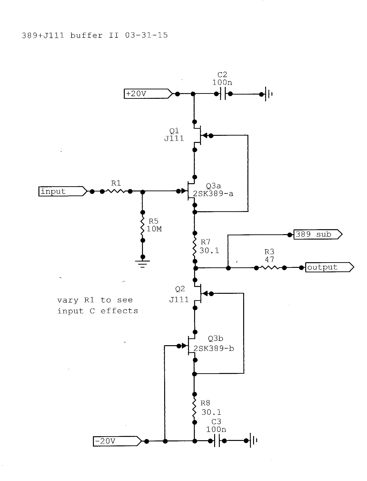

buffer schematic

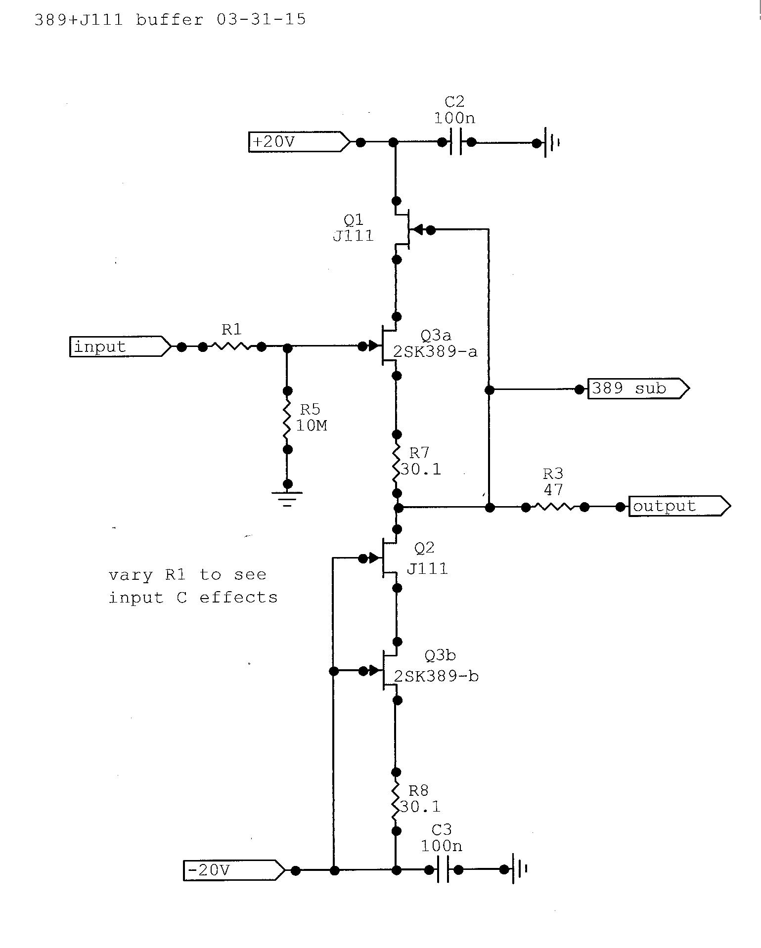

Here it is.I'll get round to a schematic soon to clarify.
cascode Q gates should connect to the respective cascoded Q's source - not the far end of the degeneration/current set R
and are you even getting 2 V Vds on the 389 with the J111? - adding some green or blue LED and few uA pullup in the J11 cascode's gates to up the V may help more

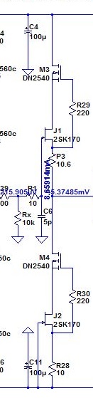

Maybe better to cascode with depletion mode mosfets?
I'm seeing about 4.8V Vds on the 389V, for this particular batch of J111s. So that is well above pinchoff, although a little higher would further reduce Cdg. The quiescent current btw is about 6.6mA.cascode Q gates should connect to the respective cascoded Q's source - not the far end of the degeneration/current set R
Yes, I agree the cascode gate might do better tied directly to the 389 source. I'll get to that when I have some more time, and see if there is a noticeable effect. Nonetheless, the main point of this was to see if the substrate drive helped or hindered, and for me it certainly does help. Fortunately it's easy to separate the distortion due to output loading from that due to input capacitance effects.

This is not presented as a buffer amplifier design, just a breadboard to investigate the behavior of distortion as a function of driving impedance, an often-neglected area. No PCBs are anticipated 🙂
Brad
Yes, the DN parts are also an option, although I worry a bit about the body diodes. The DMOS will have a lower impedance presented to the 389 drains owing to the high transconductance, which is a benefit for the removal of Cgd effects in the 389. I'm using some Diodes Inc./Zetex enhancement mode parts in another design and biasing with a current-source-excited parallel R-C, and they seem to work well (ZVN2106, ZVP 3306).Maybe better to cascode with depletion mode mosfets?
Made that change (in fact I'd had the lower J111 gate tied to the 389 source already, it turned out---as I say I have trouble seeing this stuff).cascode Q gates should connect to the respective cascoded Q's source - not the far end of the degeneration/current set R
Essentially no change in the performance previously reported.

For what amounts to an open-loop buffer the performance is pretty decent, but loading will spoil it in a hurry unless load compensation techniques are used.
The distortion is indeed distortion + noise, but the amplitude is swept from 100mV to 10V rms, so the curves start coincident regardless of frequency; that is, they show the predominance of the noise, which is measured independently to be consistent. Since a 100k resistor at 300K is about 40.7nV/sq rt Hz, it overwhelms the noise of the buffer, which from the Toshiba curves and the operating current, would be expected to be about 1.1nV/sq rt Hz at 1kHz for a single device, and raised about 3dB by the noise in the lower device. So in any event it's the resistor noise that dominates the overall noise.
Once out of that you see a divergence in the THD+N for the different test frequencies, with the 10kHz a good deal higher than the 1kHz. This is consistent with the voltage-variable capacitance accounting for the nonlinearity.
Also as expected, the distortion at high levels is virtually all second harmonic. Thus in a balanced design with two such buffers this would mostly go away.
If the buffer noise needed to be lower, one could use a quieter current generator, but thereby require some alternate temperature compensation for low d.c. output drift. One notion I floated a while back in a thread about an inverting current conveyor was to use one half of a dual device to generate a current, use that to develop a filtered reference voltage, and use that larger voltage to be the voltage ref for a current generator with a lot larger series resistor than here. In this way one can get close to the intrinsic noise of a single section of the dual device, yet preserve temperature stability. But usually the contribution of a buffer like these will be small compared to other noise sources.

Corrected schematic with cascode gates to lower sources attached.
Brad wouldn't you call that bootstrapping rather than cascoding?
Jan
A bootstrapped cascode I guess. Walt Jung uncovered the first person to do it, as part of his work on current sources and related to the boxall-baxandall etc. stuff, Gene Csanky, who is still with us.Brad wouldn't you call that bootstrapping rather than cascoding?

Brad, ok I can confirm that it works as you suggest even with the simpler non cascode follower of 15c.
Thd @10khz with a 10KOhm drive impedance at 1vrms out was 0.014pct with substrate unconnected.
Same again but with substrate connected to output, thd was 0.002pct.
This was with the analyzer at a 80khz bw
And at a 100k drive impedance and using the same 30khz bw you used (for comparison...)
Thd @10khz and 1vrms out = 0.39pct (heckuva lot more than your cascoded circuit)
But after bootstrapped substrate:
Thd @10khz and 1vrms out = 0.0063 thd (quite a bit of an improvement for one wire!)
