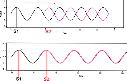

Just for you*, dvv, see what can happen when two sources (S1 & S2) are seprarated in distance. The pressure wave propagate following the red arrow.
In the upper part of the image, pressure from the two sources will null each other (phase opposition) and sum in the other image with an other frequency.
The difference of distances between the listener and the speakers will depend of the angle he his from the axis.
You can reproduce the same effect in electronic, adding a delayed source with the original one. it will only be in 2D, while, in acoustic, you will create very complex 3D figures.

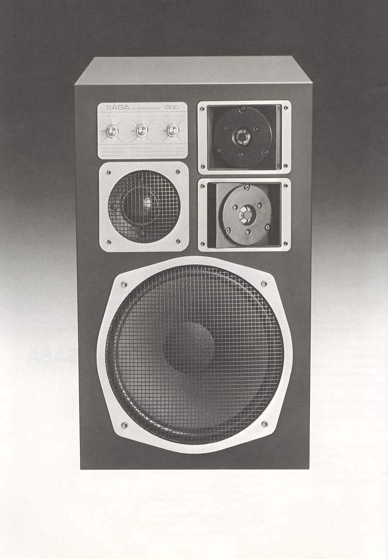

Christophe, these are not sound wave breaking companies, they make "tame" domestic stuff. In case of Tandberg's 5025 and Monitor models, the two domes are placed one above the other, and in case of Saba, looking at the baffle at 0 degrees, one is turned to the left and the other above to the right by several degrees, I don't know how many, but I'd say at least by 25 degrees, probably more.
I suspect their reasoning was to obtain the extra +3 dB (I think?) SPL and to make them share the workload. In Saba's case, appearently to widen the dispertion angle as well.
I have no idea how they are internally connecetd, in series or in parallel.
A question for all of you dedicated speaker people. I know what happens when I connect two transistors in parallel, and I've seen some speakers of old do the same with tweeters, products from Tandberg, Saba and a few others. What are the pros and cons of paralleling tweeters, of using two in place of one?
My guess would be to try to get wider horizontal dispersion and/or greater power handling for selected XO freq.
THx-RNMarsh
Bet for parallel, connecting speakers in serial is a very bad idea, unless you can perfectly pair them.
This said, i wonder why, nowadays, the impedance of the commercial speakers tend to decrease, sometimes under 4 Ohms. During tube Jurassic era, the norm was 16 Ohms, while, for sloid state amps, 8 seems a good compromise. Remembering that a 8 Ohm boomer has often a 6 Ohms resistive moving coil.

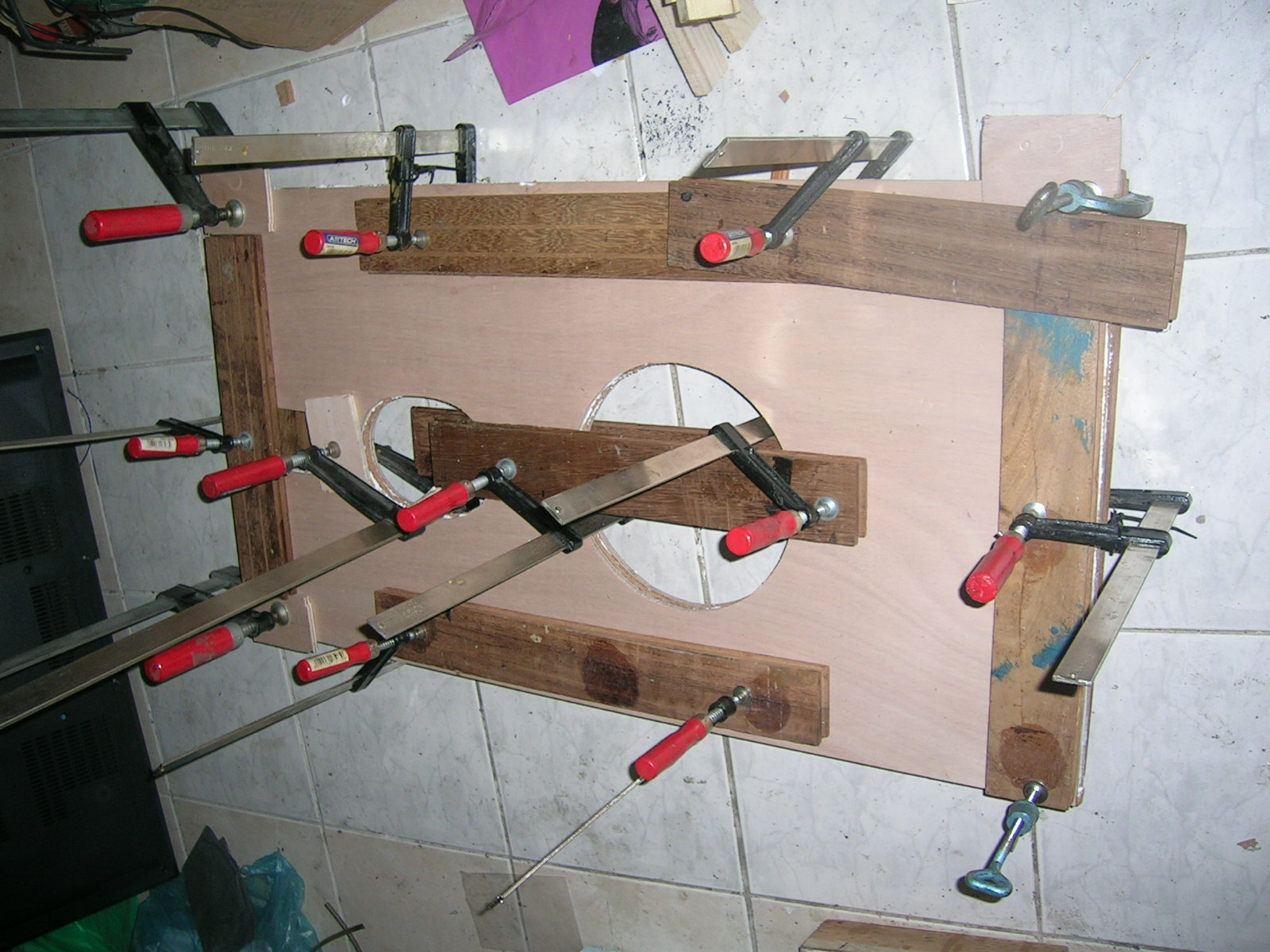

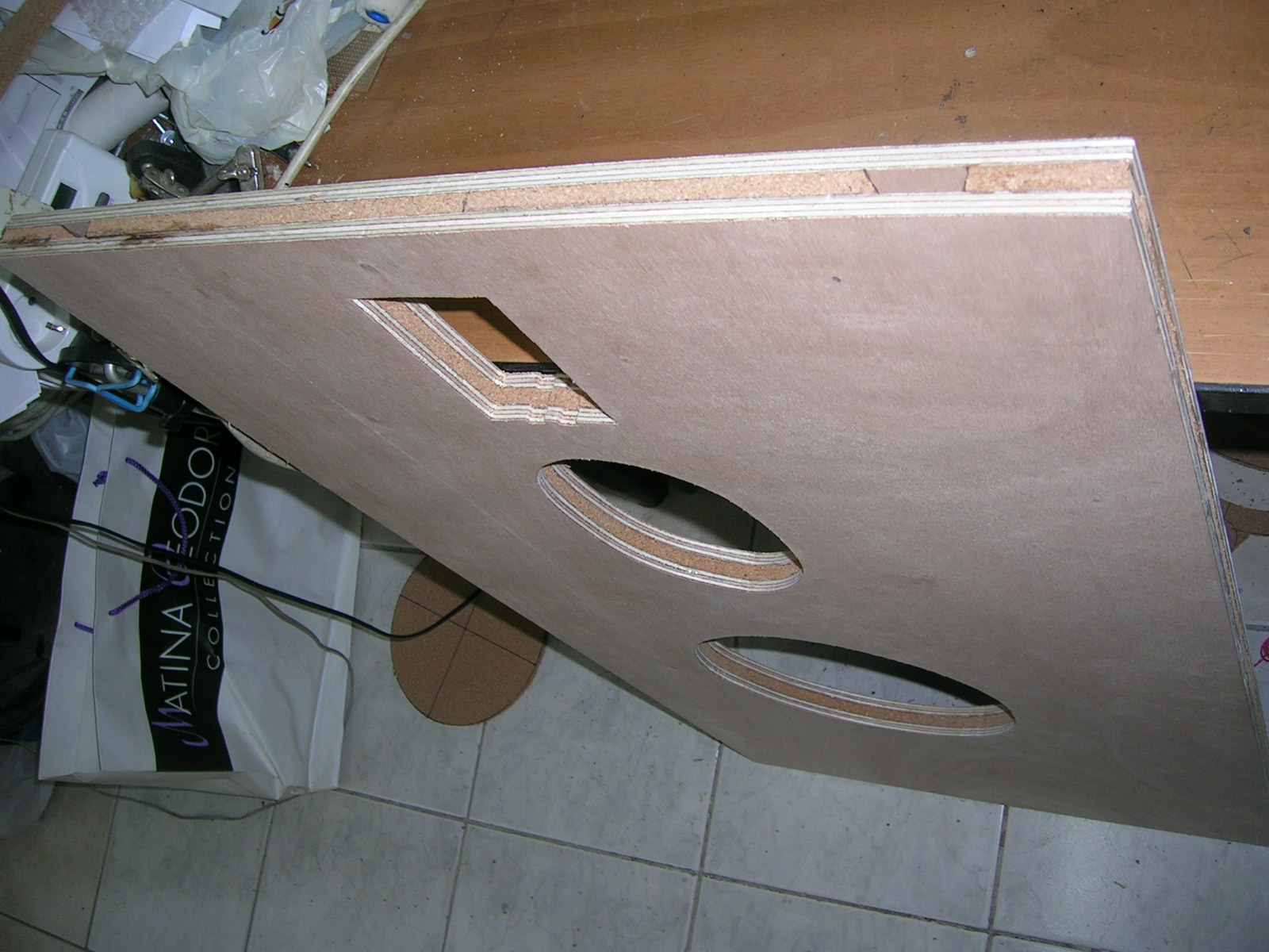

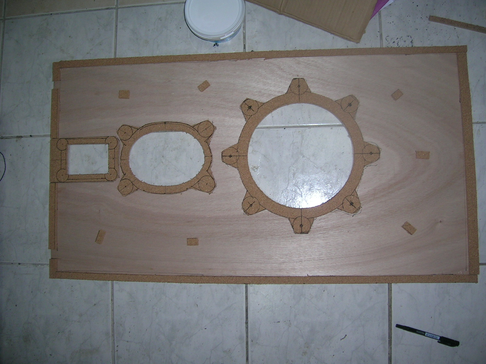

In my enclosure, i used 2 boards glued together. One MDF, one of less density. and a foil of lead covered by Blakson paint inside. it is a big mistake. It is very mat, but so heavy: i had troubles at each of my relocation.
It is way better, on my opinion, to put many cleats between walls inside the enclosure, to dump the walls. Or, and, to think at creating a vacuum between the walls that we can garnish with dry sand...
That is the way i should consider my next horns: two walls in resin filled with sand ? Massive wood is perfect, and good looking, but sooo expensive !

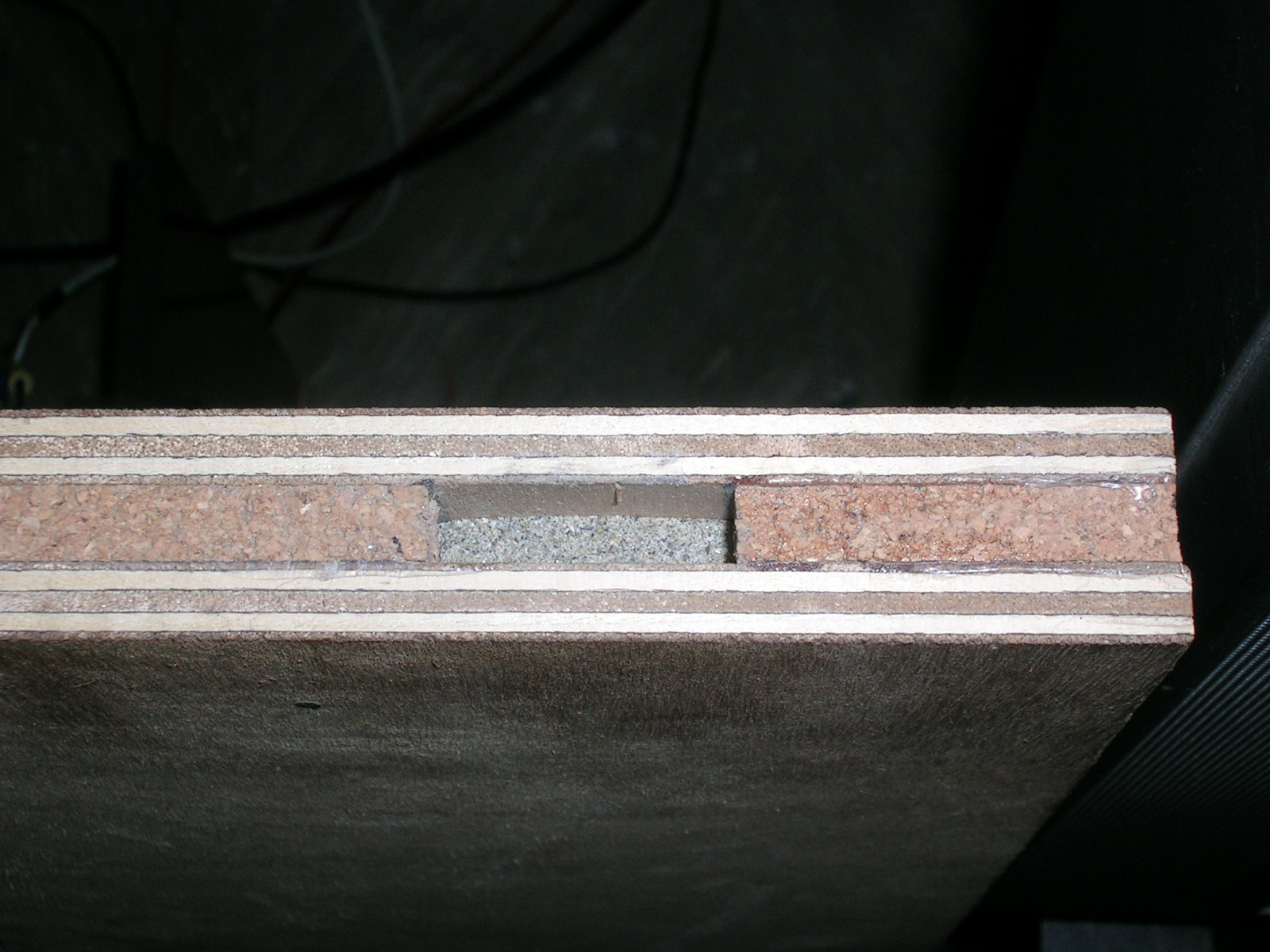

For sand filled construction, the wooden panels have to be thin, otherwise you defeat the concept of sand absorbing panel vibrations.
8mm plywood with cork as spacer works very well. Pour in dry sand while vibrating the panels (a tedious job).
When you plan relocating, you can pour out the sand, so the panels (or boxes) can be lifted and moved easily.
If you mix resin with sand, there is no vibration absorption by sand (you immobilize and isolate sand grains). You only add mass to the resin.
George

George,
A rented concrete vibrator or many other simple vibrators can be clamped to the panels and used to consolidate the sand, makes things easier but it is noisy.
