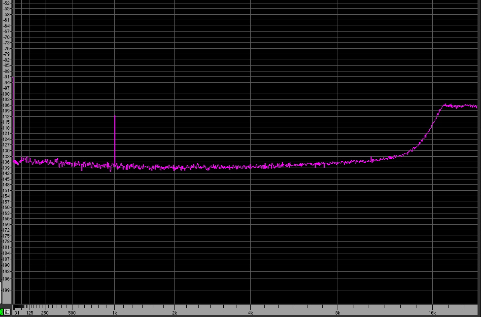

As to the CD as "crippled" release format... 16 bit x 6 dB = 96 dB (DR), right?
Here's the spectragram of 997 Hz -110 dB dithered/noise shaped (for better view) test signal that started life as 24 bit file. It was loaded into workstation, dithered at 32 double precision float and was saved as 16 bit file. All lower bits have been truncated.
Now, where does that -110 dB tone come from? It's a 16 bit file now 😉
