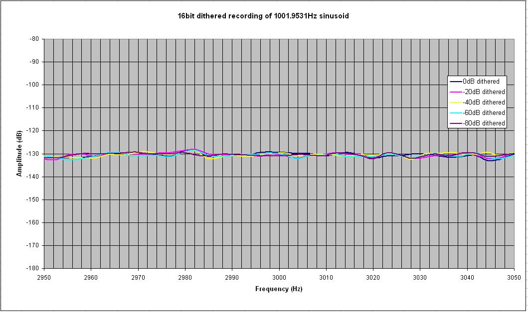

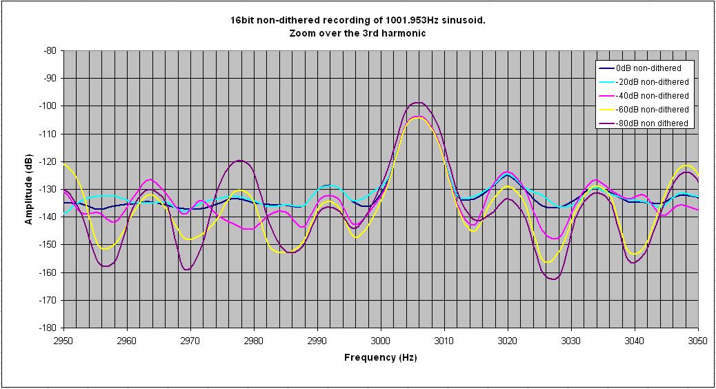

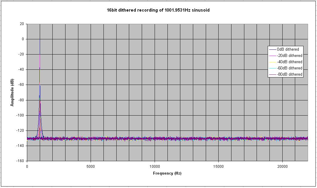

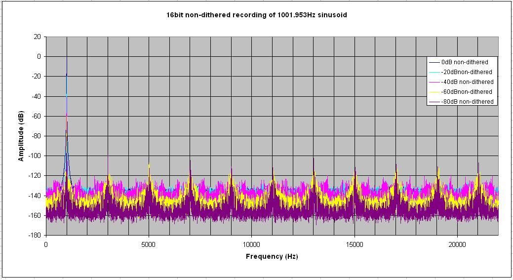

In particular, for a pure sine wave output at say -20dB FS, for a 16 bit PB system what are the consequent differences WRT 0dB FS output.
Dan, please see the four attachments
Generated files: 1001.953Hz sinusoid Mono (0dB, -20dB, -40dB, -60dB, -80dB), 5 seconds duration each, format 32bit, 44.1kHz
Saved as 16bit, 44.1kHz wav first without dithering, then with dithering (Steinberg Wavelab dither: Type Internal 1, No noise shaping)
Then each file was imported to Audacity for FFT (16384 points), then export in .txt, then .txt imported to Excel for data plotting.
George
