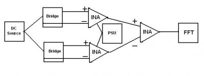

Very low and sub Hz frequency territory (where you are interested at, if I have understood correctly) is not an easy area to work on, as the target 1/f noise -due to the CC resistors- output of the bridge will be of single digit uV amplitude.
In addition to all the ‘close to DC’ parasitic noise sources of the circuit (thermal imbalance, galvanic, dissimilar metals), you have to think of the DC source purity too.
You may have to find a way to monitor and record all the other noises of the circuit except the noise due to the two carbon composition resistors.
Concurrently monitoring/recording two identically built bridges – one with carbon comp R3, R4 the other with metal film R3,R4 with both bridges fed from the same DC source - seems to me a simple way to achieve this.

I am not sure that I need to go to <<< 1 Hz frequencies, but it won't hurt to do so if practicable.
I am also going to try mixing variable levels of LF 1/f noise in with known music in order to subjectively better understand the sonic damages caused.

Concurrently running dual bridge/in amp stages is a good idea, thanks.
I intend to get to the bottom of this !.

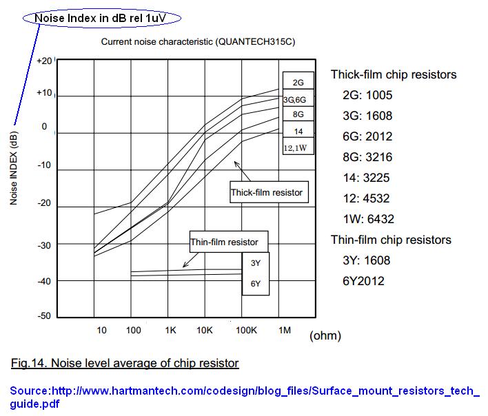

So, I need to hunt down some CC resistors...I'm not sure I have scrap boards with such resistors anymore....CRT neck boards have CC's iirc, I need to do some searching on some bottom shelves, else wise eBay.
I've read many times that thick film SMD resistors are more 1/f noisy than old CCs.
Read this link with some good data (and the references)
CoDesign • Second Thoughts on Electronics • Theory • All the noise in resistors
With proper dual bridge/INAs set-up, many extraneous influences will be diminished in importance.
George
very nice link and the reference that Scott gave tells all by brand and thin/thick/smd/th. Very nice.
I didnt test for as many brands on a Quan-Tech resistor noise test instrument I have here but similar results.
What affect would the higher noise at low freq have on operation at mid and higher freqs?? ...On a high resolution audio ADC ??
