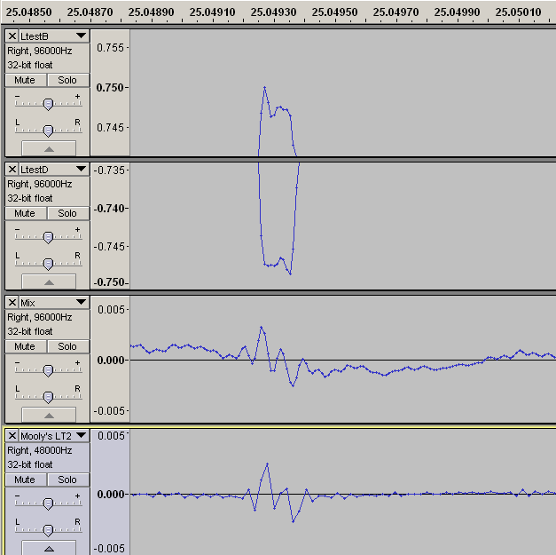

Thanks for the files, Karl, I'll start having a poke around.I'd look at the possibility that internal nodes are current starving. I've also no idea what the thermal time constants are for the small chips inside.

In the meantime, here is a genuine glitch in the original LT2 files - B and D differ obviously - that I'm looking at. Both DiffMaker and Audacity picked it up, and it's occurring at the peak of one of the highest amplitude swings - what's the likely culprit?
