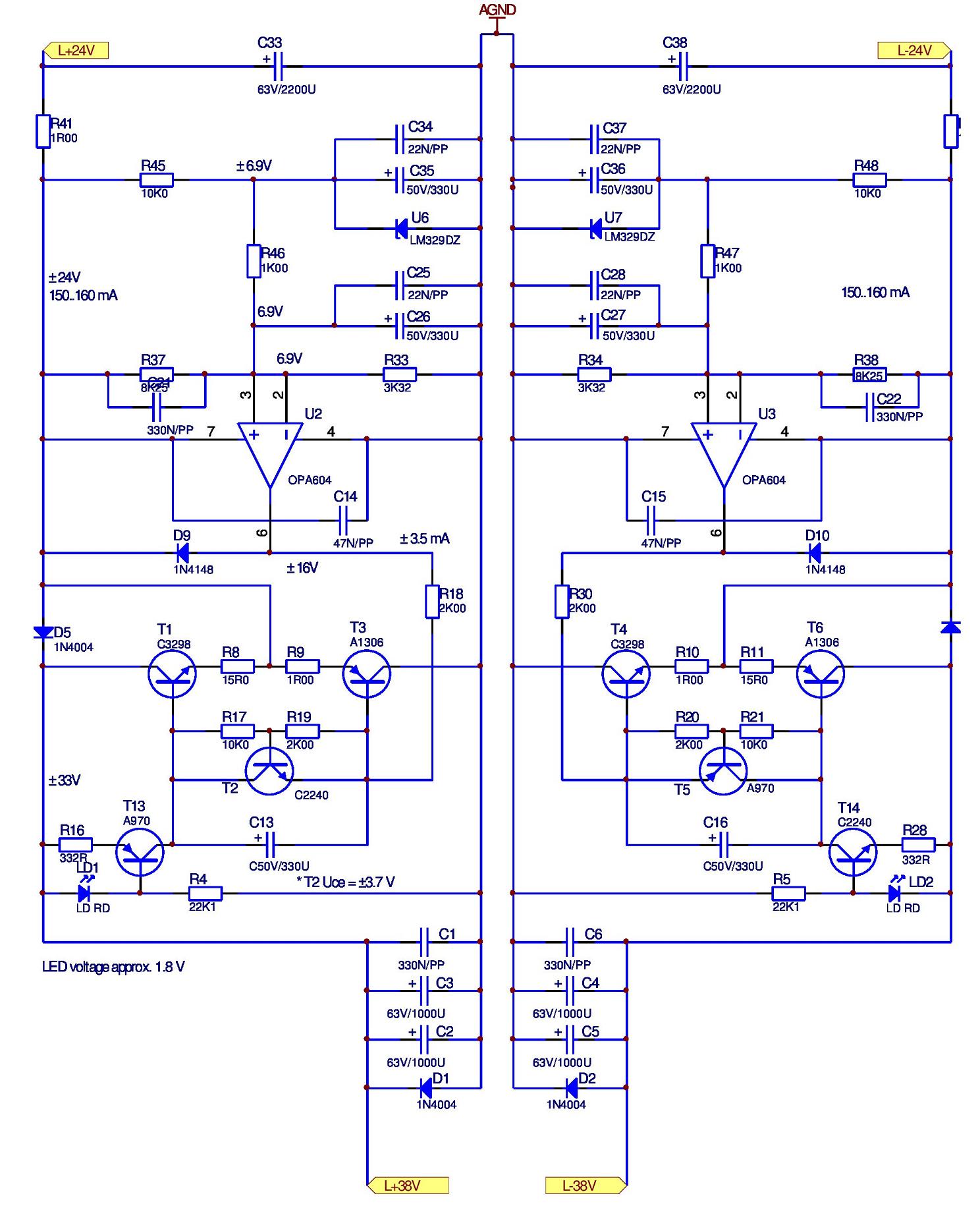

Other OPA604 use of the '90s.

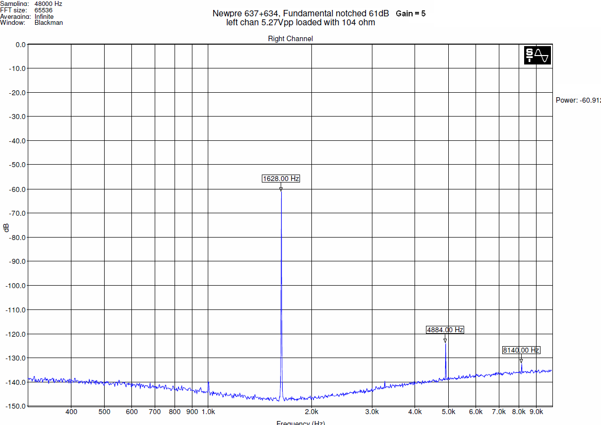

As we were discussing distortion of loaded opamps and buffers, this is the best result I have measured so far. It is for OPA637+BUF634T, overall gain = 5, loaded with 104 ohm. The result for AD797+BUF634T in the same circuit was approaching to this one, but slightly worse.
Nelson, would you mind telling what you faulted it
(OPA604) for enough to discard it?
