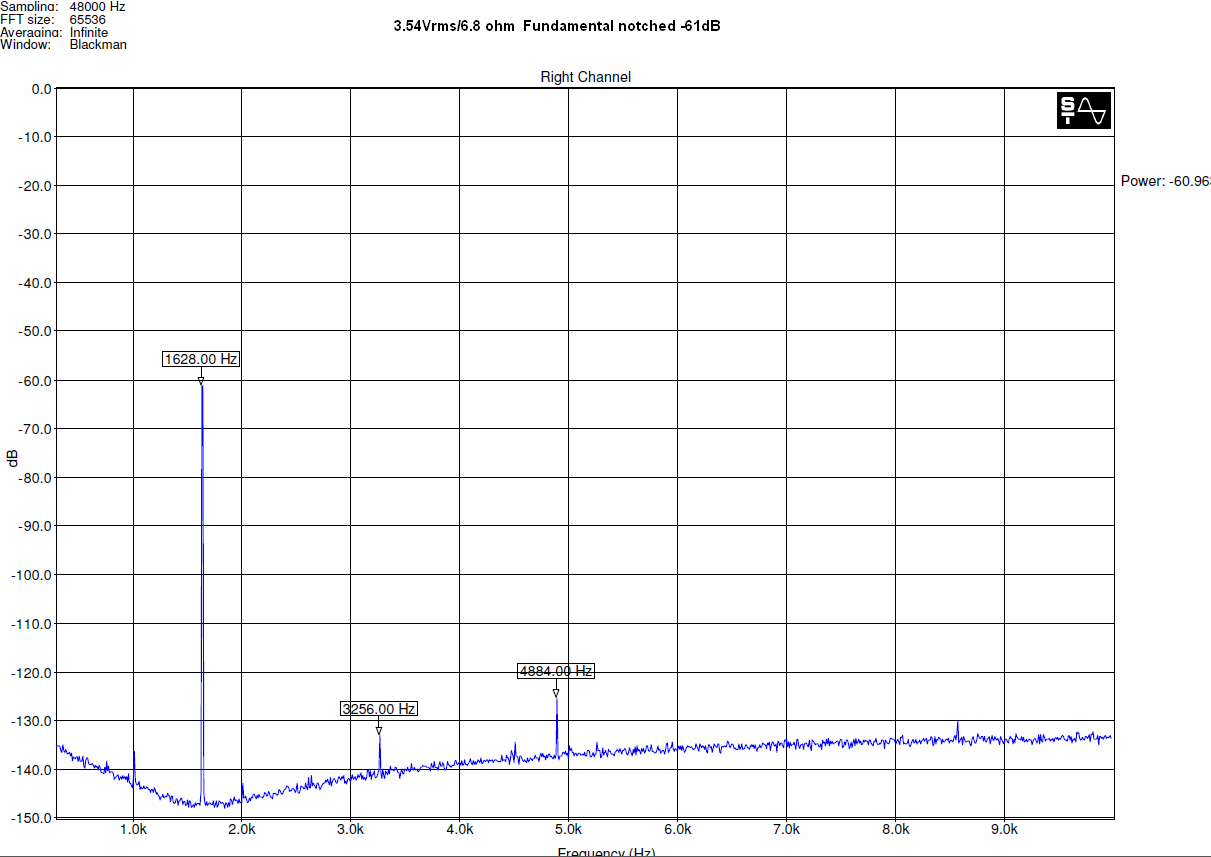

Does anyone have a SOTA buffer to enable <-130dB distortion levels into 50 Ohms at several volts???
THx-RNMarsh
Is this enough? Measured at 3.54Vrms into 6.8 ohm load. With notch filter, fundamental notched of 61dB.
PMA you have changed your mind over global negative feedback for a few times over the years...
Yes, you are right. Needed to get all parameters and measurements near to perfection.

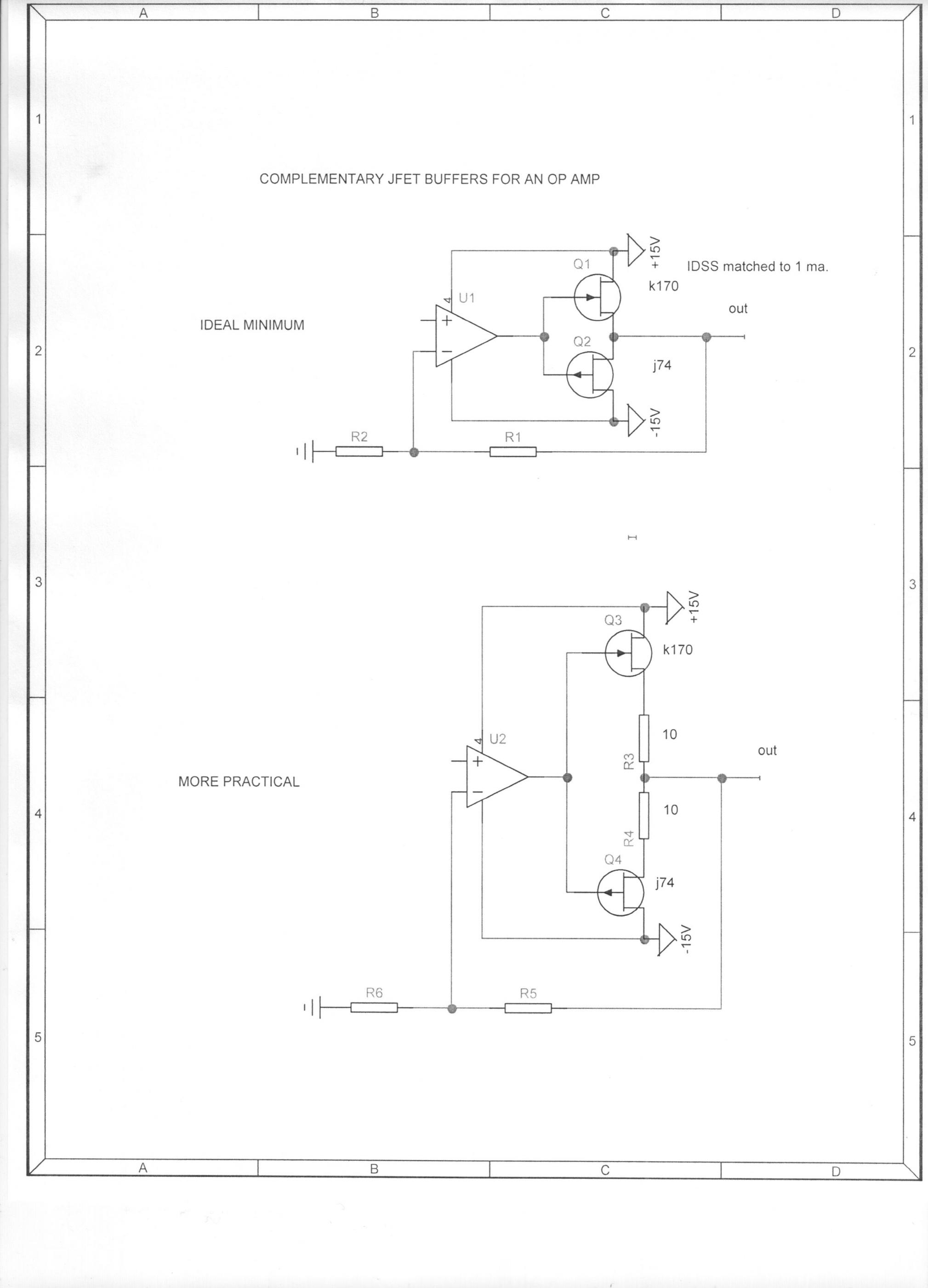

Ideal op amp buffer for medium impedance loads.
There are many op-amps that would measure worse (some much worse) in this circuit.
I doubt it. I would have 10ma or more Iq in the buffer alone. That is 20ma or more Class A, even more in Class A-B. This is not the optimum drive for loads less than 500 ohms, that takes bipolars running equally Class A, but then biasing has to be added, which complicates matters somewhat.
driving too much C loads for some opamps ?
