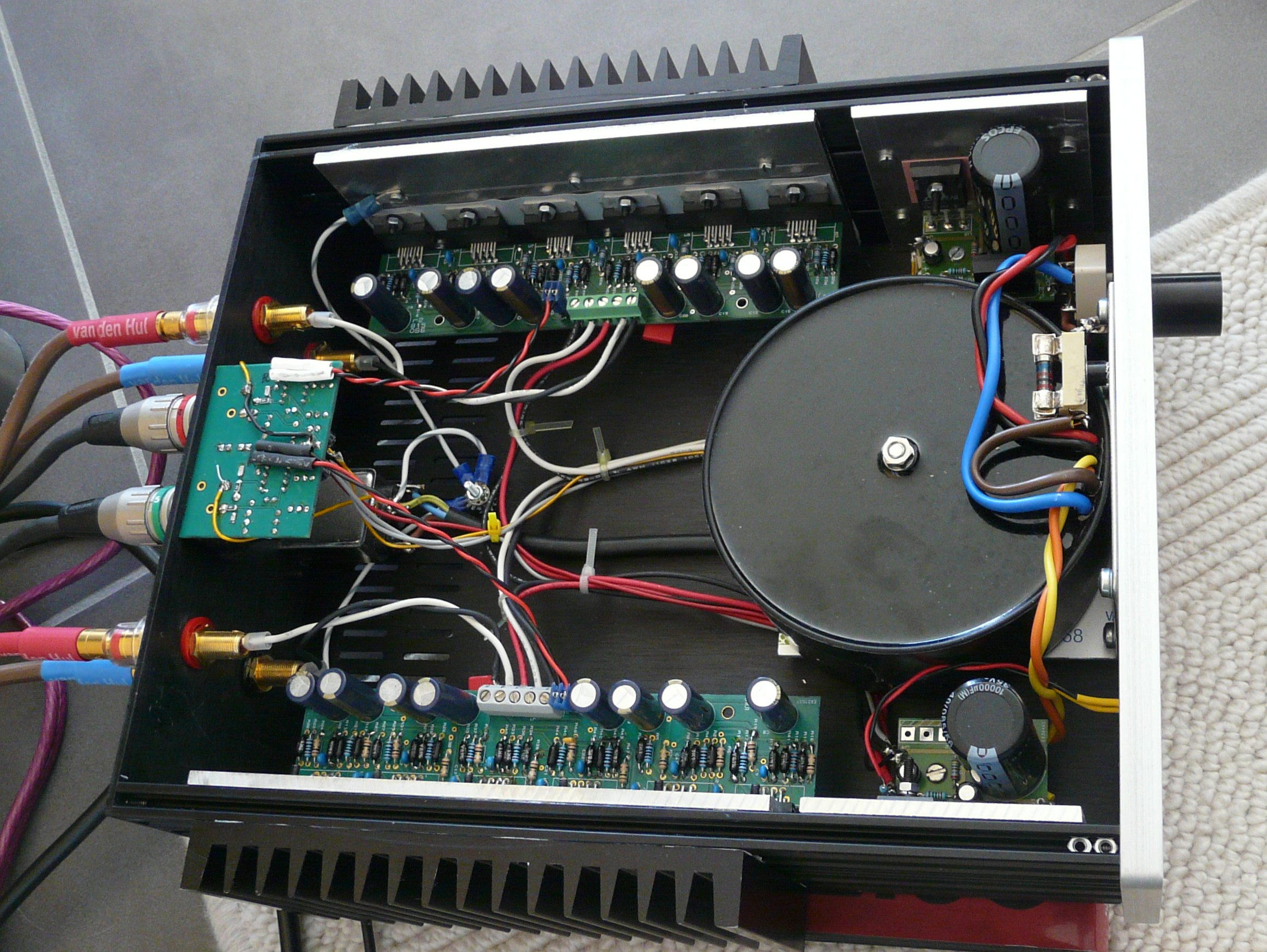

Hey Scott, had an extensive listening session with the AD815 power amp last Friday. Including very sensitive horn speakers. They had to lower the tweeter level which made it clear that his super-duper tube amp rolled off the highs...
Comments on the AD815 included total absence of sibilance and very clean top compared to their own stuff.

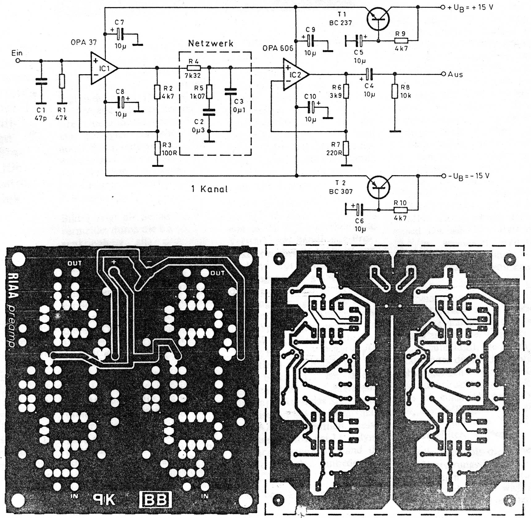

What do you gents think of this?
This design was published in 1990 or '91 in a German magazine. It was designed by Dr Herman Holger, working for Burr-Brown in Germany.
Op amp 1 is OP 37, op amp 2 is a 50V/uS op amp, I don't remember the designation. It's adaptable for both MM and MC.

except the buffer isn't doing anything per the recent discussion - not buffering the input op amp from feedback and RIAA loadsLooks pretty good, dvv.
