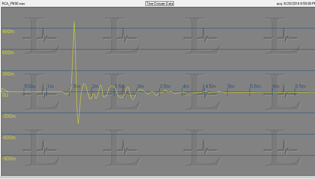

Here is a question, relevant to both speakers and microphones. Many years ago I read that mixing an dynamic mike with a condenser mike on the same instrument was problematic because of the phase relationship of the pressure wave to the electrical output. A dynamic mike has its peak out out at the fastest changing part of the waveform- the zero crossing. The condenser at the peak of the pressure wave, 90 degrees different. I have never verified this, no need to, but it sounds reasonable.
Could the same be true for voltage and current drive of a speaker? And in the current amplifier, is the peak current at the peak of the input voltage wave? The few experiments I have tried in the past had a good phase/amplitude correlation of the current driving a speaker (dynamic and electrostatic) and the voltage wave from a condenser mike in front of the speaker.
This could lead to more angst than getting absolute phase of the playback right. You need an electrostatic speaker for recordings made with condenser mikes and dynamic speakers for dynamic mikes. Or is it the other way? What about carbon mikes?

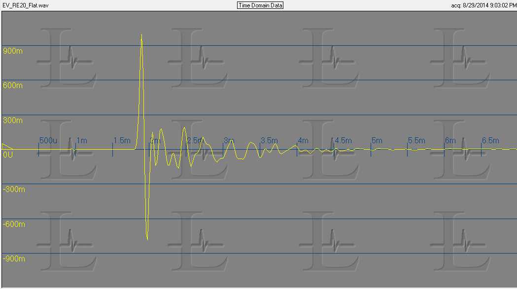

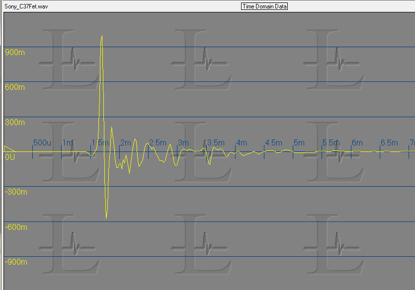

A condensor mic can be used with either voltage or current sensing (I need to think about it a while) Goran any comments? It's interesting that I never came across this issue in all the B&K and Schoeps tech literature. I do know the distortion is different in the two modes.
I'm not sure why the distortion would be different. I know the current mode is part of reciprocity calibration, something I still have trouble fully comprehending. I have found that the B&K preamps seem to limit the distortion potential. I have some HP preamps that measure significantly lower distortion than my B&K preamps.
I found this looking for some info on the difference between dynamic and condensor mikes: Microphone Impulse Response Project and he has impulse responses for a lot of microphones. They are all wave files so they need to be imported into something to see. I plotted the wave files of a ribbon, condenser and dynamic mikes to see if there is something obvious. Since there is not quite enough info to derive all the information like distance to the source etc. but still a start on the efforts. I may try to import the files and do transforms. That's for later.
Some more reading https://www.neumann.com/download.php?download=lect0048.PDF Alternate self promotion Impulse Response
There is a lot on impulse response on the web and a lot of work using captured impulse responses of spaces to modify sounds. Much to explore.
