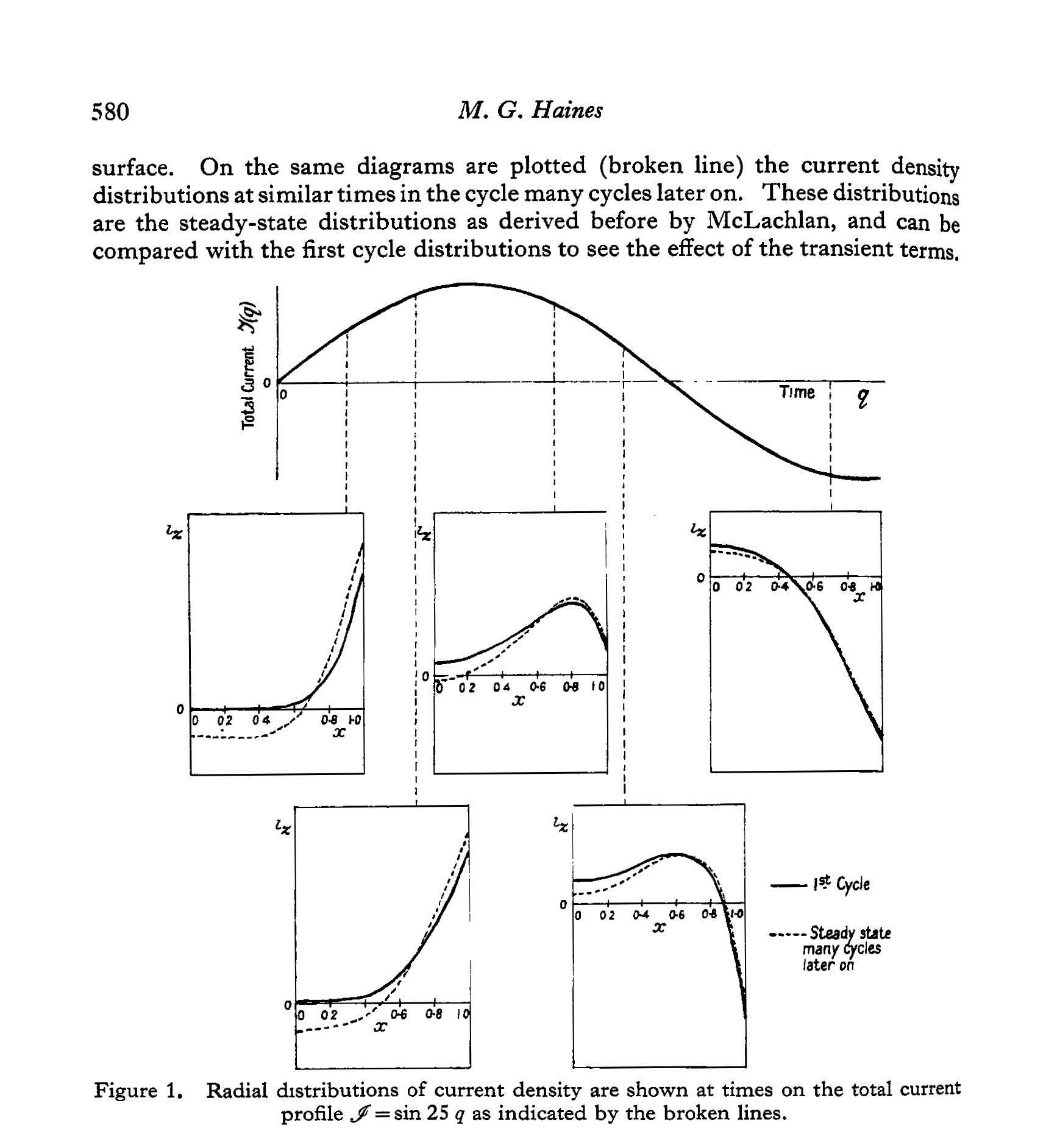

Case in point, a paper from M. G. Haines, Physics Dept, Imperial College, London, 3rd june, 1959:
This is from page 6 (of the PDF), showing the current density profile of a 10 cm radius copper conductor at 546 hz.
Note the inversion of current density at the surface before the overall current has gone negative.
The internal inductance of this system vs time? Lord only knows how to calculate it.
The resistance vs time: I believe simple integration of the areas under the curve should suffice when all current is positive, although I suspect the negative current densities should be subtracted to produce the accurate resistance vs time profile.

Actually, I suspect it may be more accurate to square those current graphs, calculate the integrated power loss, then back into the effective resistance of the conductor. That way the negative current densities are treated as losses instead of subtracted from losses.
