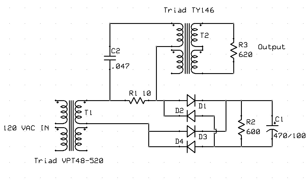

Well since things are quiet again, here is my circuit for testing diode switching noise. Open for questions and comments.

You certainly couldn't measure for CE testing with that setup it just doesn't have the range.
As I am looking at the moment at preamp level power supplies none of the devices make enough noise for CE to worry about. Hooking my rf analyzer directly to the PC Card any switching noise was below my analyzer's noise limit.
So I will have to do the same test on a higher power circuit.

I have an instrument which uses similar idea- transformers for both DMode and CM measurements and presents a low voltage output of what noise is on the line(s). Or, my Fluke 43A sometimes for up to 15th harmonic and PF of 50-60Hz testing. Or, use a wideband clamp on current probe/meter/spectrum analyzer.

It looks like, in effect, you have a current probe. I find a magnetic field probe more useful in both looking at the transient waveforms and seeing how far they radiate. What I see suggests the tank circuit of the transformer self resonance and the cap around the diodes has more impact than the diodes seem to themselves. More distressing is how far the fields can go.
We need some ideas for a decent DIY Magfield probe. They pop up on eBay occasionally but not often.

I started with a magnetic probe!
Yes I am looking at current. The output is reasonably well behaved with the 620 ohm termination resistor. Different diodes shown different results.
The main issue is turn on resonances. Most of the real diode switch noise literature is for switching power supplies. When you have 1000 nS of switch off time on a 40kHz switcher you spray lots of energy into the ether as it has no where to go. At 120 Hz you have about 3% of that energy floating around.
The turn on energy does have a place to go so since it isn't launched into the ether regulators don't worry about it. It instead rattles around the power line at a level ten times as much energy as switch off. Now as the load capacitor is only coupled to the transformer inductance during the charging portion of the AC cycle a lot of resonant energy goes back into the power line. A simple snubber will take care of much of the switch on energy and diode bypasses can handle the switch off in a low current power supply.

I think you saw my two transformer technique to clean up common mode noise.
But the real issue is I am having a very hard time measuring in circuit switching noise from low current power supplies.

Almost forgot a simple mag field probe is shown in an old LT ap note. It is ten turns of 34 gauge wire around a 50 ohm resistor inside a slotted brass tube. One end is soldered to the tube the other end goes to the center pin if a female bnc. The brass tube is ground. An amplifier with a gain if at least 100 is needed. It can be as simple as four AD797s cascaded. Each set for a gain of 3.16 using low value feedback resistors. That should also give a bandwidth of at least ten MHz. (Bypass Bypass Bypass and a bit of interstage shielding wouldn't hurt)

edit: Ed, why the 10 ohm resistor? That tends to dull out the transients.
How about using a nice 100 milliohm zero magfield resistor? I'd be happy to make you one if you wish.

As to the resistor value after getting the range of output values it can be lowered to still give nice pictures. The transformer currently being used is good to about 200 kHz. Now for the next generation of tests I will be able to go to 20 MHz. But for now the data is interesting.

If I am following this last discussion correctly your last test setup is only for measurement purposes. How would you incorporate your thinking into a low powered power supply, would this be a linear power supply you are talking about or a regulated supply, I am assuming for the moment it is not a smps. Can you show a circuit diagram of how you would actually approach a solution in a simple power supply?
