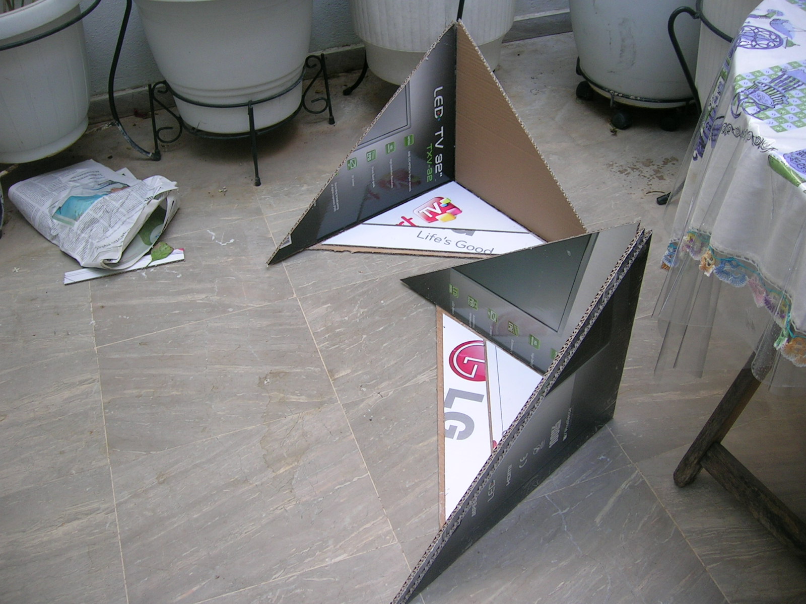

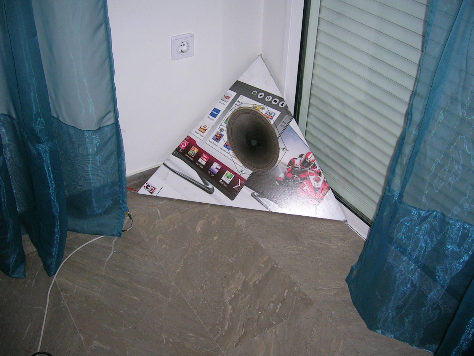

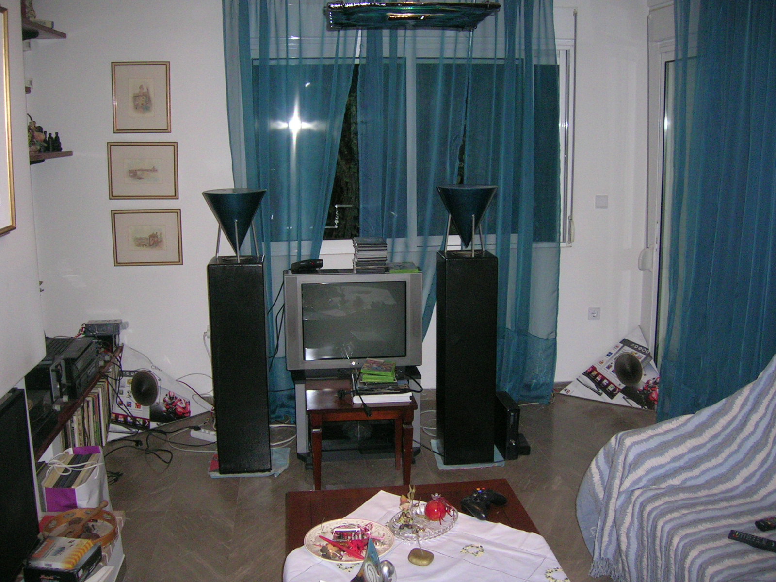

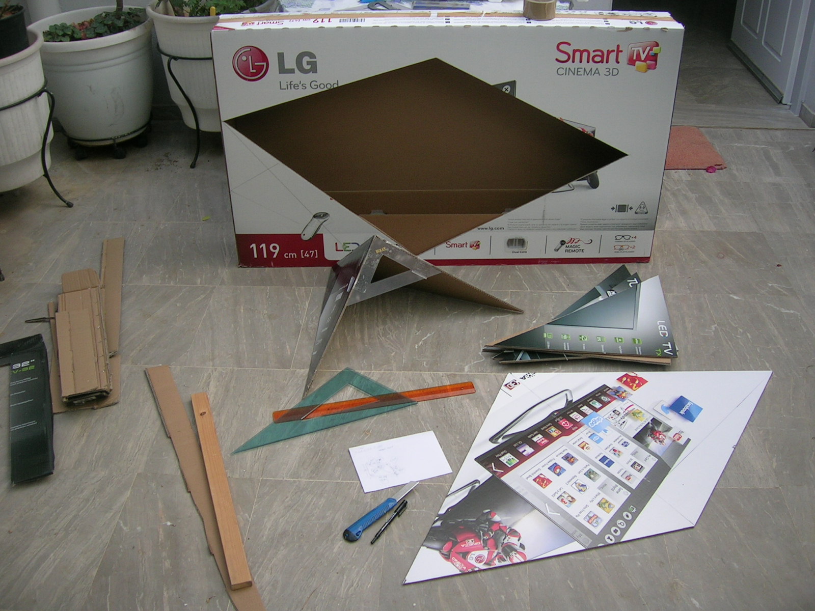

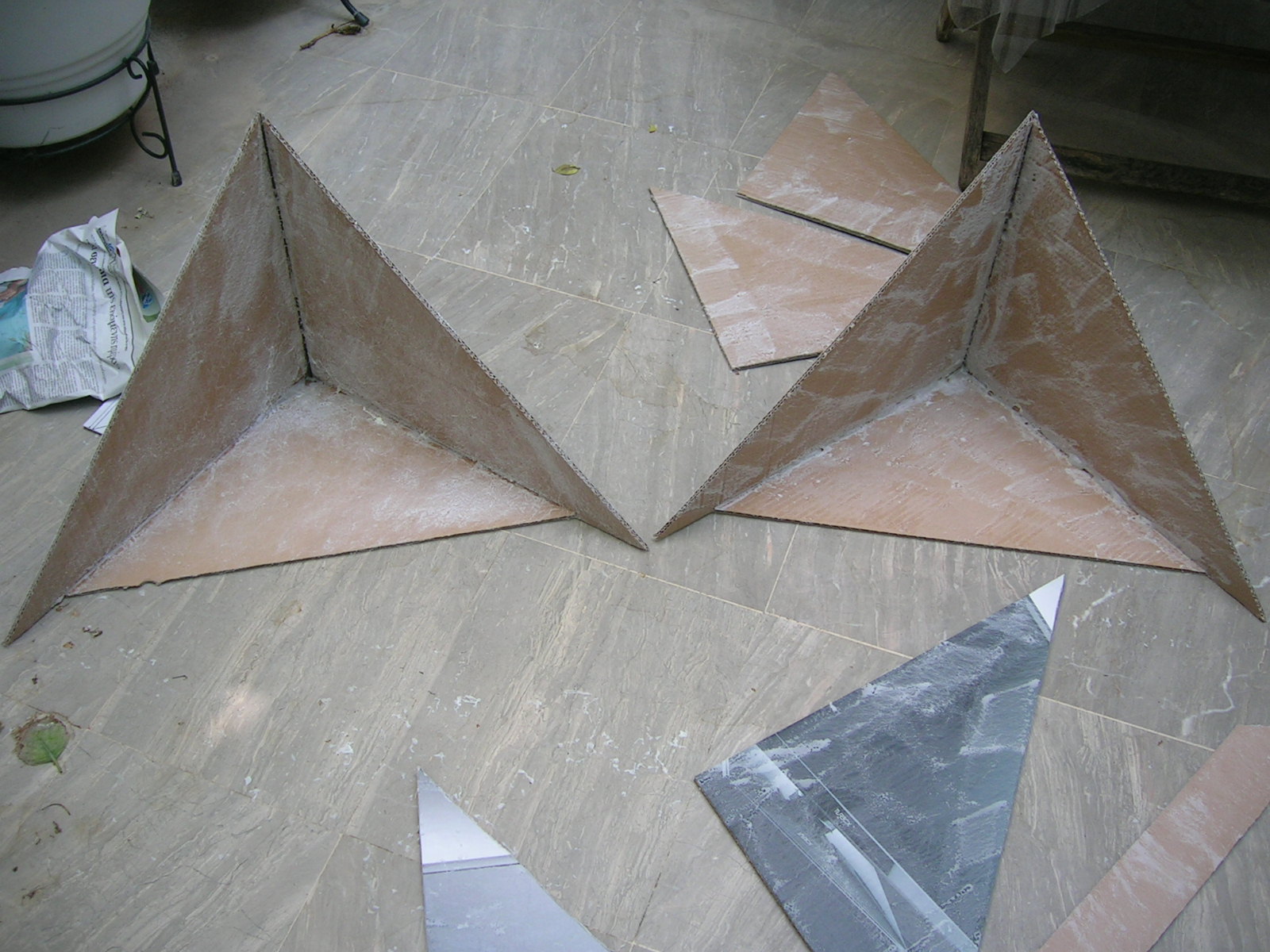

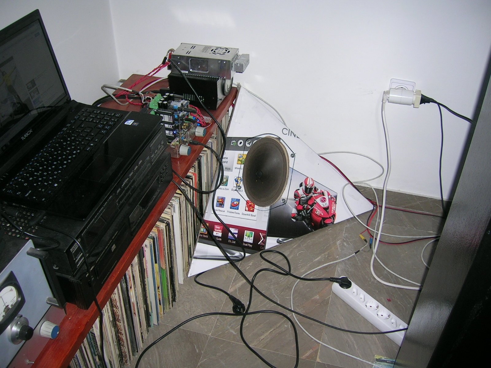

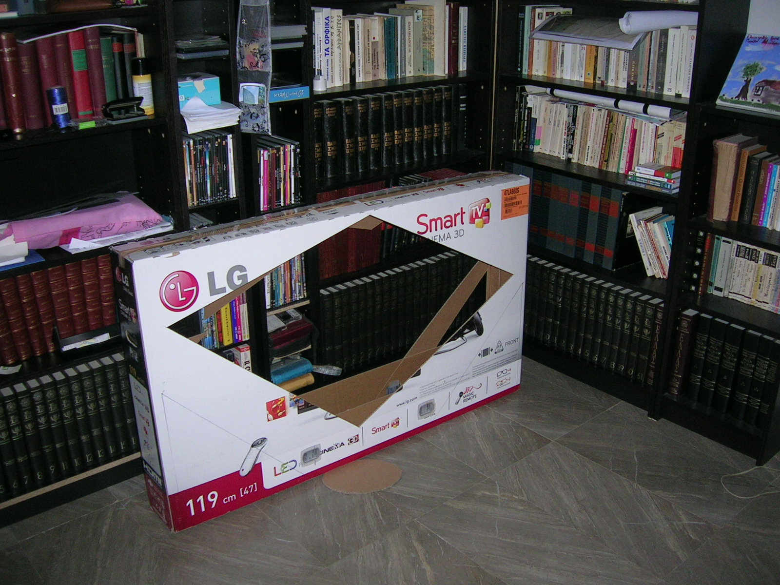

Ah yes. I finished today my corner-coupled speakers. Carlson & graaf flooder mix.
Private audition on appointment.

So that's what they call video speakers?
With drivers like these:Ah yes. I finished today my corner-coupled speakers. Carlson & graaf flooder mix.

You could transcend the diffusers !
It was a self-sarcastic response to dvv post.
But the message is clear. The greatest benefits are to be gained by working on the acoustic problem (speaker-room integration).

I can remember not that long ago it was argued that corner placement of a speaker was one of the worst things you could do as it would excite room modes to an extreme. Now here we are using the corners for just that purpose.How times change our perceptions of acceptable room acoustics.
No. Time does not change our perceptions of acceptable room acoustics.
It is that we have to fight on many fronts and so we have to weight things.
These corner speakers are 48db/oct high passed at 80Hz (the double woofer/sub is behind the tv).
Room mode excitation will not change a lot with shifting the small speakers 1m from the corner, as the wavelength of the room modes in this space is large.
There are some unique merits of such a corner speaker placement.
-No baffle step effect.
-Controllable reflections.
The three reflecting surfaces (two walls + floor) are 0.15-0.20m from any point of the speaker cone. Early reflections start 0.4-0.6ms delayed (that is in the region of any reflection occurring internally to a loudspeaker enclosure) and spread in time, closely separated due to the oblique angle of the walls (my experience with omnis tells me that closely spaced early reflections are not objectionable). If need arises, it is easy and aesthetically acceptable to cover the corner with material absorbing the 1kHz and above.
The fourth reflecting surface (roof) is quite away, producing >8ms delayed sprayed reflections.
-WAF (no useful space occupancy)

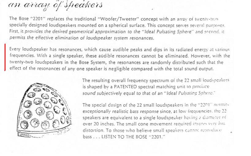

Hey, I found the old Bose manual for their model 2201. It's a hoot.
http://products.bose.com/pdf/customer_service/owners/2201_guide.pdf
I love the comment, to the effect that the resonances for all the drivers are different. Such quality control, it took an MIT Phd to figure it out. Then there's the Indian carvings, a cultural connection?
I wonder if those are the same 4" drivers that they used later in the 901? Fifty watts divided by 22 devices isn't much per unit, couple of watts each.
Scott
You are talking about the low resonant frequency of each speaker unit and the spread of it in a production line, yes?
I would expect a more clear explanation in the brochure.
IMO, the sentence may mean peaks and dips of acoustic energy caused by resonances due to driver-room-sensor placement. When there are multiple drivers –even closely spaced-these dips and peaks due to resonances (*) and reflections tend to smooth-out.
George
(*) one can argue that there are other dips and peaks generated with this arrangement, acoustic comb.
Yes but we have to be careful, as acoustic comb filtering happens with every wide freq range loudspeaker construction.
It is also present within the cone of a single wide range driver. We can’t escape that reality.
Plus, you get the 3dB efficiency bonus you have from any doubling of the number of drivers.
So let´s say these little critters are 82dB/W efficient each, take 22 of them working as coincident drivers, and the total system efficiency goes up to about 95dB/W.
Of course this falls apart at higher frequencies, since the drivers are no longer coincident, but this is where the equalization comes in.
One of the great contributions of Dr, Bose to loudspeaker design is that he realized that the loudspeaker system does not have to be linear, as long as you can correct these non-linearities through electronic means. That provides you with an extra degree of design freedom.
Also, running 22 speakers at low(er) cone excursions would translate into lower distortion.
