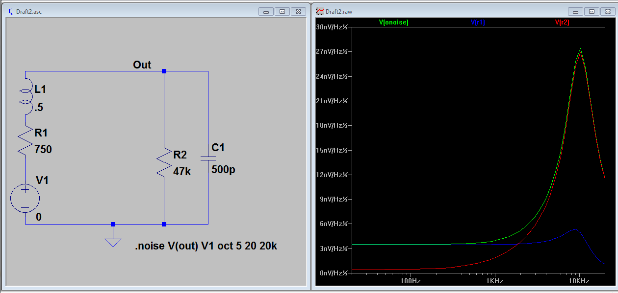

I'm a little lost here on the inductance. Only the resistive component of the inductance can generate thermal noise*. The load R is in parallel with the noise source reducing its effective resistance. The shunt C will attenuate high frequency noise generated but 500 pF won't have a lot of effect.
Maybe the series inductance will attenuate the noise if the load is low enough? I'm not sure it works that way. Even so the reactance is small compared to the load impedance.
*From Pg. 11 of Low Noise Electronic Design Motchenbacher and Fitchen, 1973.
The inductance reduces the shunting effect across the 47k load. The reactance is not small at HF since L is likely to be ~1H.

I went back and modeled the cartridge/input circuit to better understand what is happening.
The sim below explains it. The inductance of the cartridge isolates the shunt of the DCR from the input resistance allowing it to rise with frequency until the shunt cap starts bringing it down. This may be a real benefit of the Barney Oliver circuit since it has an active shunt working with the inductance. Possibly lower noise? Keith Johnson does something similar in his tape head preamp.

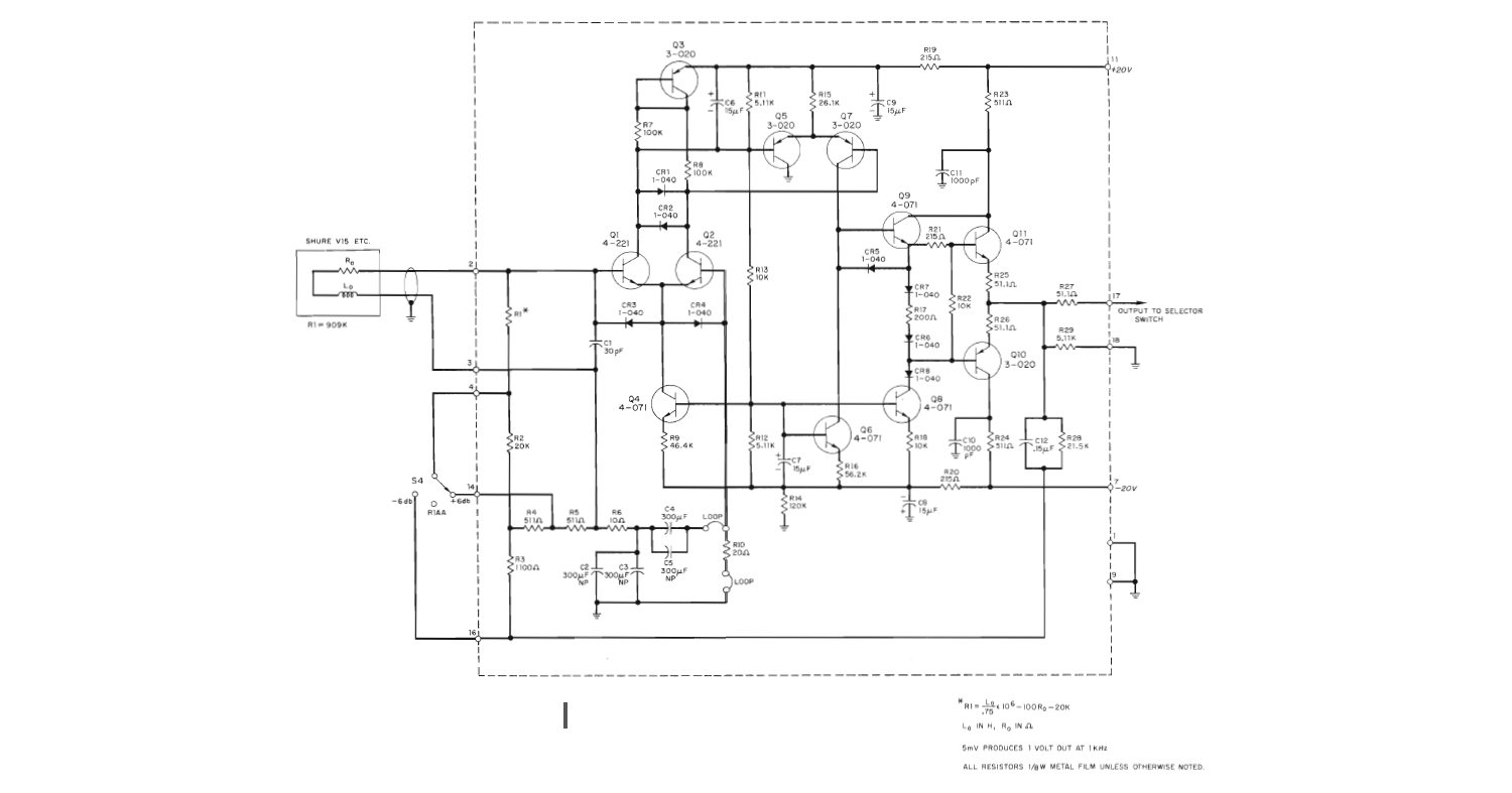

Demian
http://www.hparchive.com/Manuals/Barney_Oliver_Amplifier_Manual.pdf
The article describes (page 9 and page 14) the way to incorporate the resistance and inductance of the cartridge in the formation of the 2120Hz (75us) roll off point of the RIAA equalisation. I can't say if the L is used for lowering the noise too.

I'm a little lost here on the inductance. Only the resistive component of the inductance can generate thermal noise*. The load R is in parallel with the noise source reducing its effective resistance. .
Simply take the real part of the net source impedance, works for any case. The National app note of 1977 goes through the math but leaves out the current noise of the op-amp. One nice thing about the Grado MI carts is that eliminating the source noise is fairly easy without any circuit tricks.
