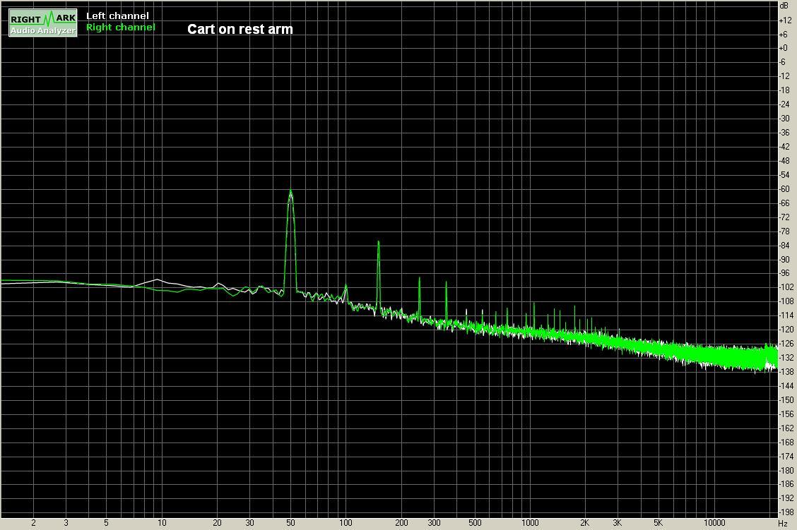

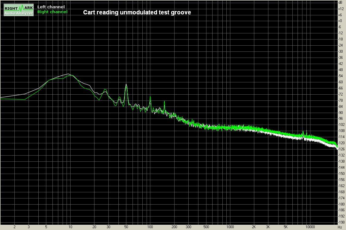

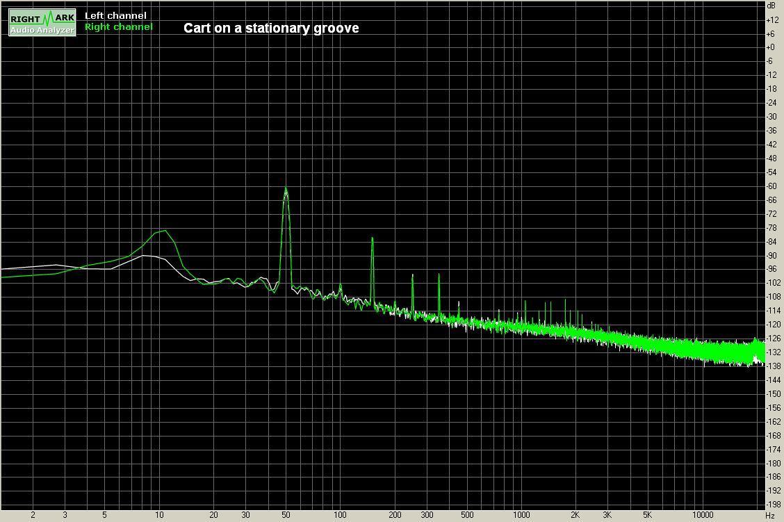

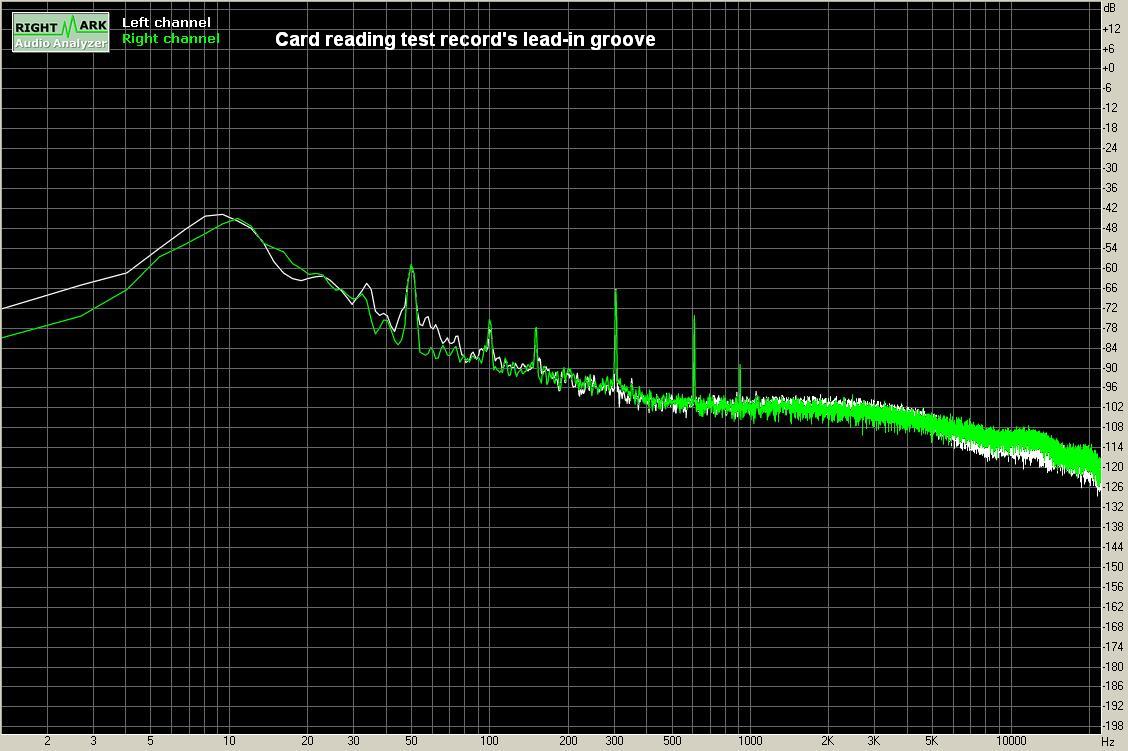

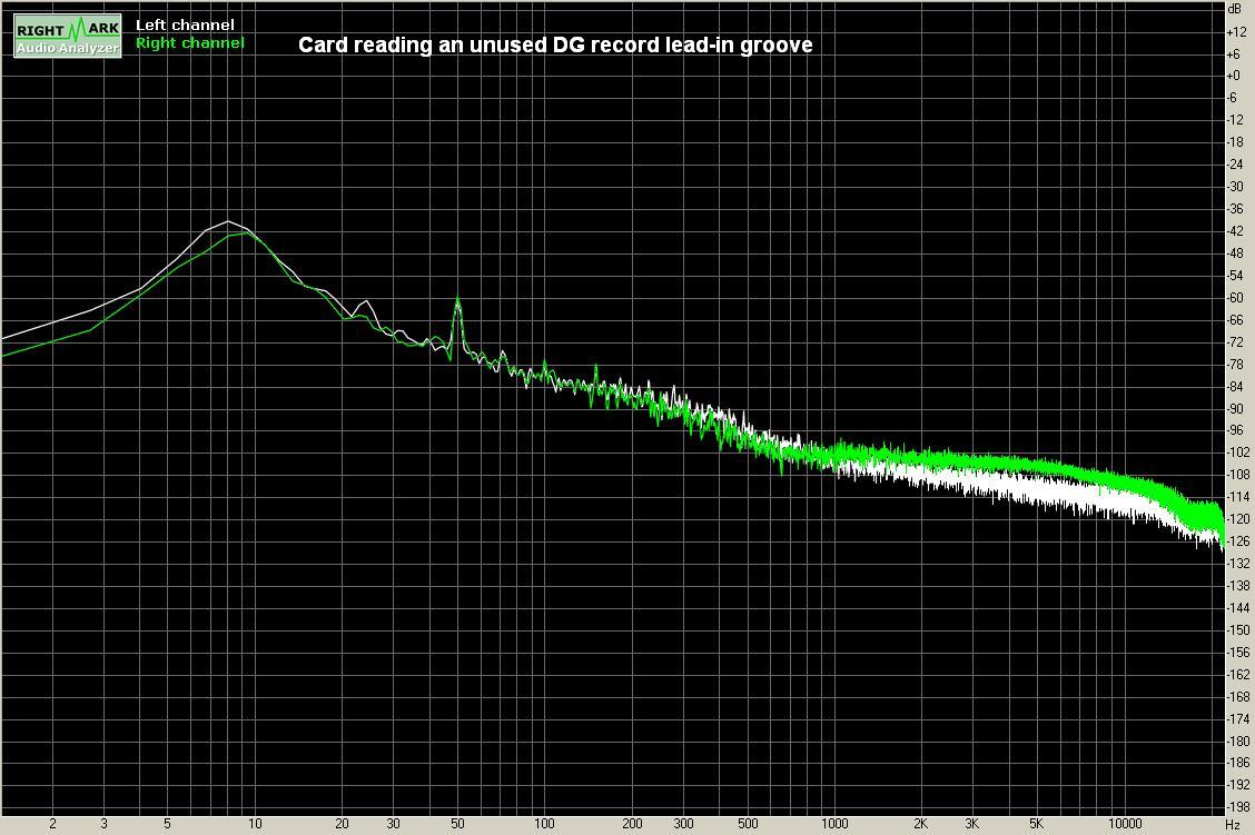

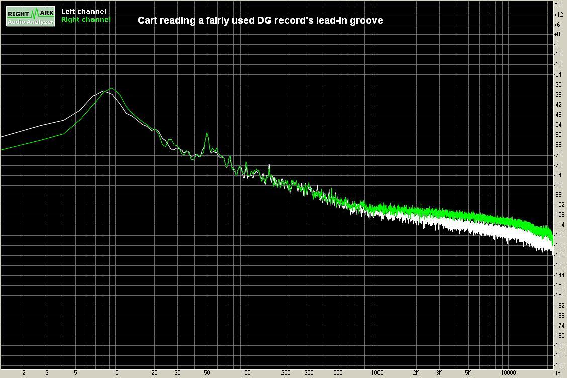

Now we are almost there! The next question should be easy, what is the impedance of the phono cartridges? Or in other words how many nv/sqrt(Hz) will the cartridge produce?
Re arguments (*) 😀
Re noise
Ed see att.1.
SY is right (L affect cartridge noise a lot) but I see your point at post #53555.
I would be with you but as I’ve said, for me this noise is of no importance (**) when a cartridge is reading a groove.
Rest attachments (pls see the broadband spectrum, not the 50Hz related peaks): DENON DL103 plus a 23.5dB head pre (***), plus Hagerman Buggle RIAA pre (40dB/1kHz), plus passive volume control. 0dB=1.286Vrms

(**) Not only due to it’s low amplitude compared to record surface noise but due to it’s smooth spectrum. Our head (mine at least) doesn’t notice it.
I would consider it a problem when it starts to modulate, that is when the cartridge sees a heavily varying preamp input impedance. This leads to my third pre amp criterion Stable input impedance. See how Dimitri is dealing with this problem for the last 25 years or so

Ed see att.1.
