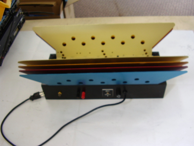

John,
This was my package for a high end amp, I did not proceed though.
ES
