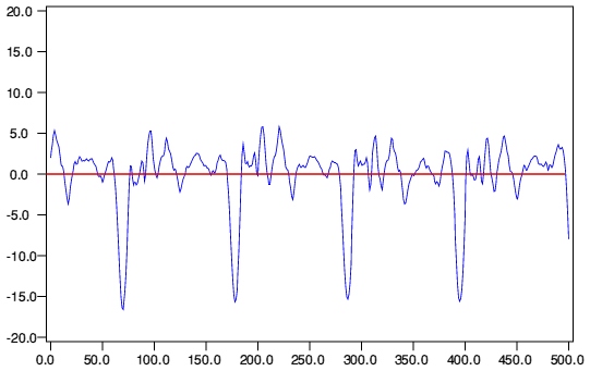

There's some nice examples of asymmetric musical waveforms here: Asymmetric musical waveforms
e.g. The pic below is Miles Davis' trumpet.
Seems it's not unusual for positive peaks to be three times the size of negative peaks (or vice versa).

To detect asymmetry, one could use something like a peak-reading VU-meter circuit, but measuring positive and negative peaks separately and comparing the outputs. It shouldn't take more than a couple of diodes and caps and some resistors to make a simple detector.
