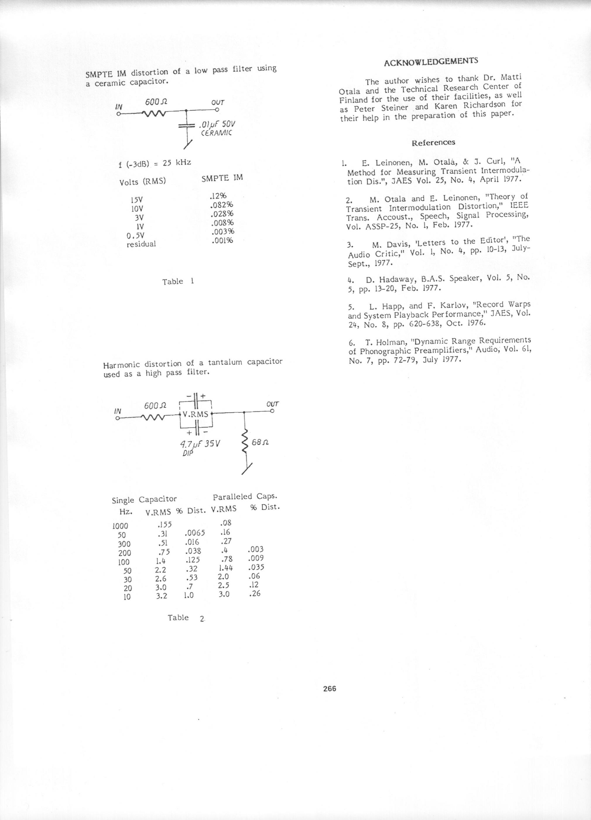

Folks, my 'fashion choice' this last week was distortion in Tantalum and Ceramic caps. Now, I knew that it was there, but did every one of you? It was just a simple test that I can count on, while I learn to use and trust the test equipment. I am also finding the distortion baseline under various conditions, such as different frequencies, etc. It is important to learn your equipment, before getting more 'exotic'.

I am trying to teach the amateurs, PMA. I published this cap distortion back in 1978. What were you and your associates doing then? Also, Groner thinks that he was the first to develop the paralleled, polarized cap distortion 'improvement'. You should send him my 1978 paper, which precedes him by about 30 years that shows the same thing. Do you have his contact info?

I doubt he claims invention, but you could PM him he is a member.
