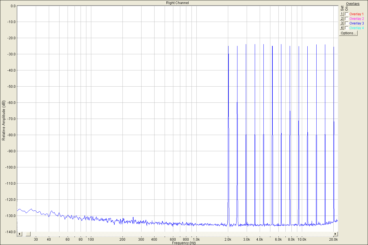

That's valid for a speaker in a space. It tests for reverberation and distortions that would obscure the details in speech. For electronics it only makes sense if the system has a reverb/eq in it. On most of these tests, including the full spectral contamination test I have yet to see even a medium grade sound card that can't pass it with without distortion on a loopback test. I don't have a single ended 3W triode amp to try with it but even an LM3886 can pass it at full power with no significant degradation.
I don't think it would yield much in decent electronics. We need to look elsewhere.
I use the Belcher test all the time. Also notched noise and TIM square.
Problem is that it does not reveil anything new in linear electronics that a conventional measurement does not show.
For codec´s and speakers it is very usefull though.
Here you can see some shots i made from the bespoke AD797 intrumentation stage i mentioned. There is some life under -120dB but if that is audible i do not know.
The first picture is the noise notch, then the Belcher test and then the TIM square method.
The last picture shows an open loop JFet phono input. Here you can see some distortion and also a lower noisefloor then the AD797 ( paralleled ) stage can manage.

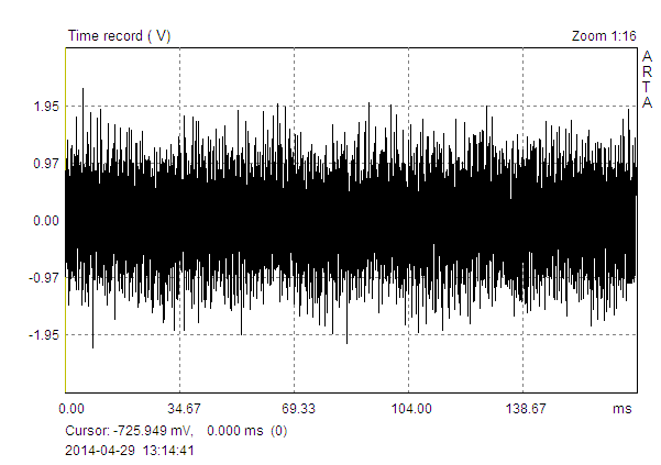

I appreciate your input, and I have similar experience. With multitone, notched noise or FM modulation tones I have never found anything unexpected and, more important, the methods have had not enough resolution. A conventional CCIF 19+20kHz spectrum and THD spectrum at different frequencies and amplitudes have revealed more than the 'special' signals.

What do You mean, what kind of signal is it ?
