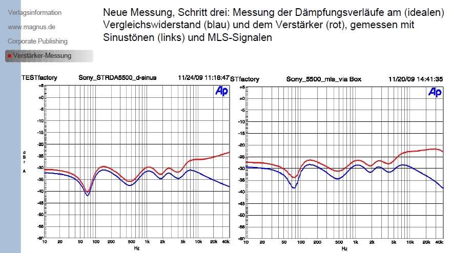

Trying to read through the article (my German is zilch) I think they say there is a difference between sine wave and MLS measurements. That is true and easily explained- the sine wave measurement uses a wide band detector so harmonics will add with the fundamental, the MLS is intrinsically narrow band, it needs to be to derive the individual frequency response. Further the MLS system is band limited by the A to D and D to A conversions.
After that I really could not make sense of the article.
If I can understand their measurement process I could duplicate it and see if I can get the same results.
My German is (slightly) better and I *think* I understand what they try to do, based on the pic below. It appears they excite the speaker with an MLS, and 'ground' the return side either through a resistor to gnd, or through the Zout of an auxiliary amp (that assumedly is not driven) via the switch. If the amp is ideal, there will be no signal to the analyzer. However, the amp is not ideal; for one it will exhibit rising Zout with freq which shows up as a rising curve on the analyzer.
In case of the resistor, the 'Zout' of the resistor is constant with freq so the curve is flat.
What I am not able to find out is the value of the resistor, and that is crucial. By manipulating that resistor value you can get almost any curve you want. Especially later when they normalize the curves to the resistor curve, not knowing the actual R value makes the results pretty meaningless.

Then why does the top line read : 8 Ohm resistor instead (statt) of the loudspeaker.
Replacement (ersatz) resistor would imply just that : 8 Ohm.
I know Jacco, that I don't understand either. If we would assume that they load the amp with either the R or the speaker, driving the speaker with the MLS doesn't make sense, at least to me.
It is also not absolutely clear to me how the switch is connected; what is the pole, what are the throws? It is ambiguous for me.
This is probably one of those presentations that really need the narrative to make sense.
jd
If you look at slide 17, it seems to imply that they drive the speaker at one terminal, and at the other terminal terminate it with either an R or the Zout of an amp. That then gives the two curves. It would make sense if the R was, in value, comparable to the amp Zout, but certainly not if R was 8 ohms.
Anybody can enlighten me here?
jd
