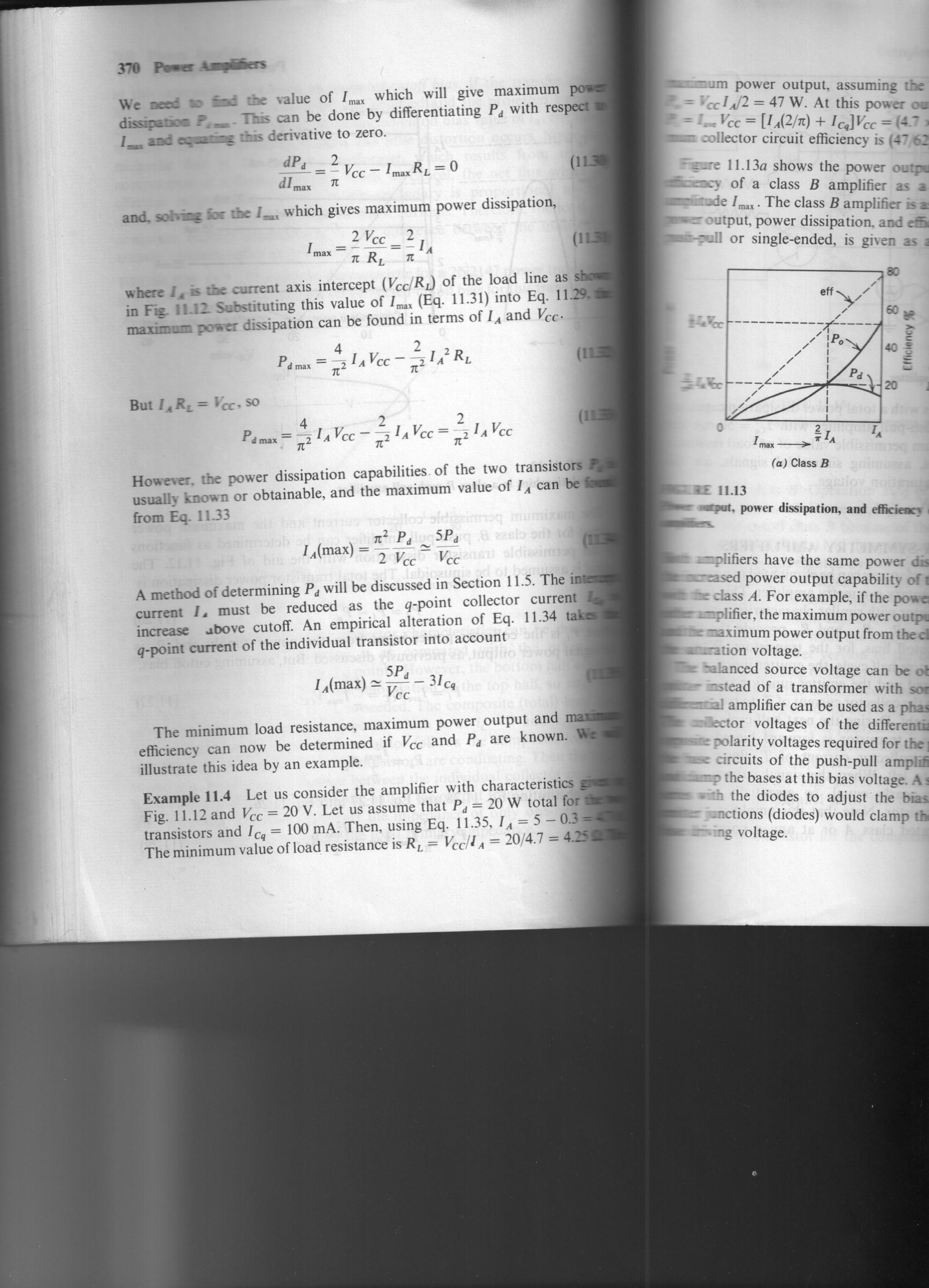

If I may, I would like to talk a little bit about the history of 'preconditioning' the power amp. In general, I think that it is too stringent a test, except for PA. It was put into the standard by a manufacturer who was in direct competition with Phase Linear about 40 years ago, and they used bigger heatsinks in their product, so they knew that they had an advantage. They used the inexperience of some of the other people in the standards group to put in this seemingly 'harmless' requirement. I heard this directly from the people who did it. Here are the equations:

Equations for deriving maximum power dissipation in a Class B amp:
