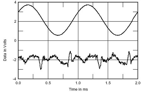

It's interesting to compare the measurements of the Mac to the Parasound JC1. Not that the imperfections in either of them are anywhere near the threshold of audibility, but you can see why there's resentment shown here for a product that looks, feels, and electrically performs better. Competition is tough.

I doubt that the Mac's distortion measurement would show the similar shaped curve as in the other amp's measurement. IIRC, with crossover distortion present, distortion should be higher at lower output levels.Most likely the first graph looks the same in shape as the second one if it was only for the noise.

Since distortion is buried in the noise floor in this particular case, we do not know how the curve would look, therefore let's call those magazine measurements meaningless and, probably, close the topic.

At one watt, the measurements show something like 0.002% THD+N, noise dominated. Where did you get the idea that the distortion amplitude was constant with level?
Nothing posted allows us to make that assumption. We're all guilty of assuming a monotonicity that real amplifiers don't have. The mechanism that causes crossover distortion is especially non-monotonic, and even its inverse.
As I and PMA have suggested, tests should really be made at 0dBW and +10dBW as a bare minimum for usefulness. -10dBW and -20dBW would contribute very significant information.
And, as John Curl has tried twice to make us accept, extrapolating from the given tests at +25dBW is foolish at best. The most useful part of the given tests is the picture of the distortion component vs. time, fig 8 IIRC.

Apparently not. This measurement shows gross crossover distortion at less than 200mW output.So you think the Mac guys didn't figure out the trick where you run an amp in class A at low power levels?
I agree. It is ugly.
To hell with gm doubling - I always over bias so the first 0.5 to one watt in an AB is class A. And I'll do more if the heatsinks allow it.

Man, there is some BS'ng going on here ... that "terrible" waveform above is missing the labelling, that says:
A little bit of integrity helps ...Fig.8 McIntosh MC501, 4 ohm tap, 1kHz waveform at 480W into 4 ohms (top), 0.00075% THD+N; distortion and noise waveform with fundamental notched out (bottom, not to scale)
McIntosh MC501 monoblock power amplifier Measurements | Stereophile.com
Fig.8 McIntosh MC501, 4 ohm tap, 1kHz waveform at 480W into 4 ohms (top), 0.00075% THD+N; distortion and noise waveform with fundamental notched out (bottom, not to scale).
Measured at 480W, not 200mW
