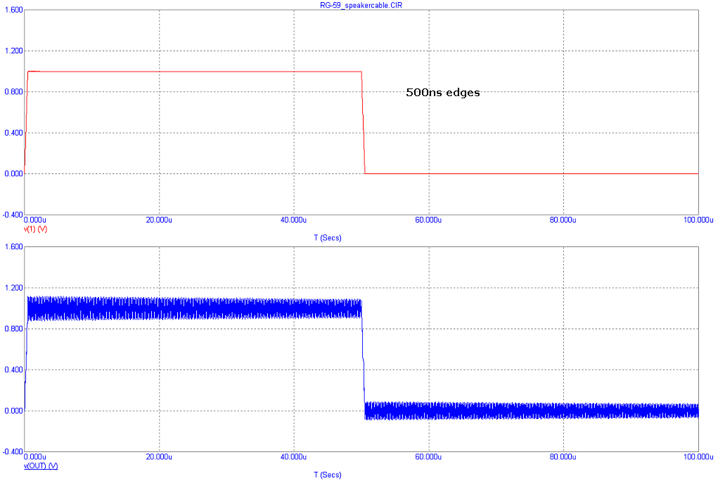

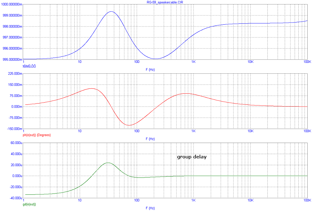

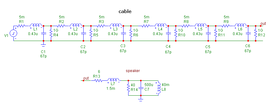

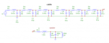

Tried some simulations. I can see nothing but lumped circuit dependent low frequency amplitude deviation (5/1000 of input amplitude) and corresponding phase and group delay deviations. Sorry, no reflections for 10kHz wave. But yes, when such circuit is driven with square, we can se HF reflections, as expected. But such reflections begin to happen above 1MHz.
No, not 'despite' but 'because'. Obviously an LC circuit will have a frequency-dependent response if it is loaded with a frequency-dependent impedance.
Then I guess it's odd that using an rf bridge shows the reflection at 10Khz, no?? You know, actual hardware??
Be careful of GIGO sims.
Go back and look at what Scott did. Then examine the graph I posted a while back..

One odd note: Why is the 200 unit sim lowering it's ring frequency with time, and why is it becoming less damped with time?
jn
Don't know, I made a subcircuit and cut and pasted 200 in series (actually was quite fast). Our simulator allows turning off all variable saving except a few chosen, most of the simulator time is in saveing all the variables as C++ objects (in our case adi_waveforms).
It looked weird. I've been racking my brain trying to think of any physical reason why the ringing freq and damping would change over time. The most I could think of was that the wire resistance is lowering the slew rate of the leading edge, so the energy hitting the discontinuity has lower frequency content...and the lower freq content doesn't get controlled as fast, hence the lower damping rate.
My expectation is that as time goes on, the lower frequency attributes of the cable will change the waveform because the characteristic z is rising with time. Something I will continue to ponder.
If Scott wants to change the inductance value a little in all the 200 units, run the sim and observe the ring frequency’s change with time, and it’s damping with time (after Heaviside Vol. II para 238)

I think this is length quantization errors, if I halved everything and made 400 sections this ringing frequency would double. In the limit it vanishes.
