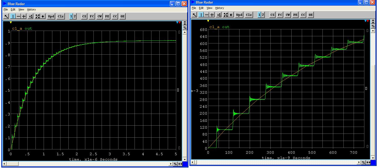

I entered Mr. Bateman's 200 unit simulation and compared the step response with the lumped equivalent of all 200 at the source. I used 10k as the frequency his 14 Ohm line and 1 Ohm load. Note, in general you can not do a simple transient response with frequency dependent components. Still this is sort of what I expected, kind of a conservation of energy thing.
In a funny way I think we are all agreeing, I'm just saying the Tline as a bulk component gives the same time constant/phase behavior.

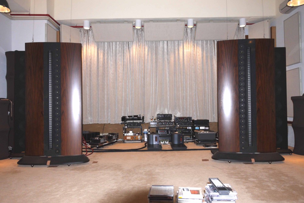

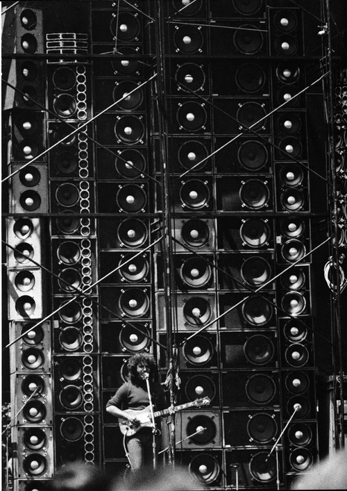

3 and 4 way systems reduce this to a none issue IMO John, the issue with box speakers is getting enuff enclosure volume to not allow dynamic compression , even in the mid range area, some guys still use too small a mid driver enclosure..
After which you run into the limitation of your 1" tweeter, it's why i moved away from such setups when doing SOTA system, instead favoring line-source type speakers ...

"Muddiness" is often due to lack of speaker stability, my earliest experiments focused on making modest bookshelfs very rigidly locked into place - I then found listening to demos of speaker of the Wilson 'calibre' quite laughable, the 'wooliness' of the sound meant that 95% of the speaker's worth was going straight down the plughole ...The WATT1 has a VERY SMALL enclosure volume, and it shows in the frequency response, but not in 'muddiness' that I normally associate Doppler with.
As I stated before, there are a series of tradeoffs, and you have to pick your choice. NOW, I listen at modest levels in a small apartment. Someone who listens at 'realistic' levels will most probably detect Doppler distortion from many speaker systems with limited cone area.
Realistic levels being done right is all about the amplifier working well - I've repeated this 'experiment' literally thousands of times and never had the speaker not easily do the job. Of course, listening to conventional setups, which get into trouble at very modest listening levels, makes it understandable that people point to an obvious villain - the speaker ...
