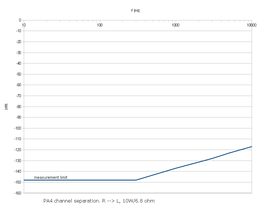

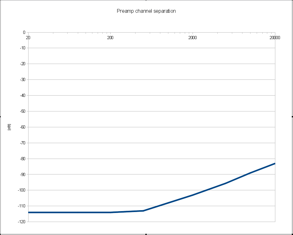

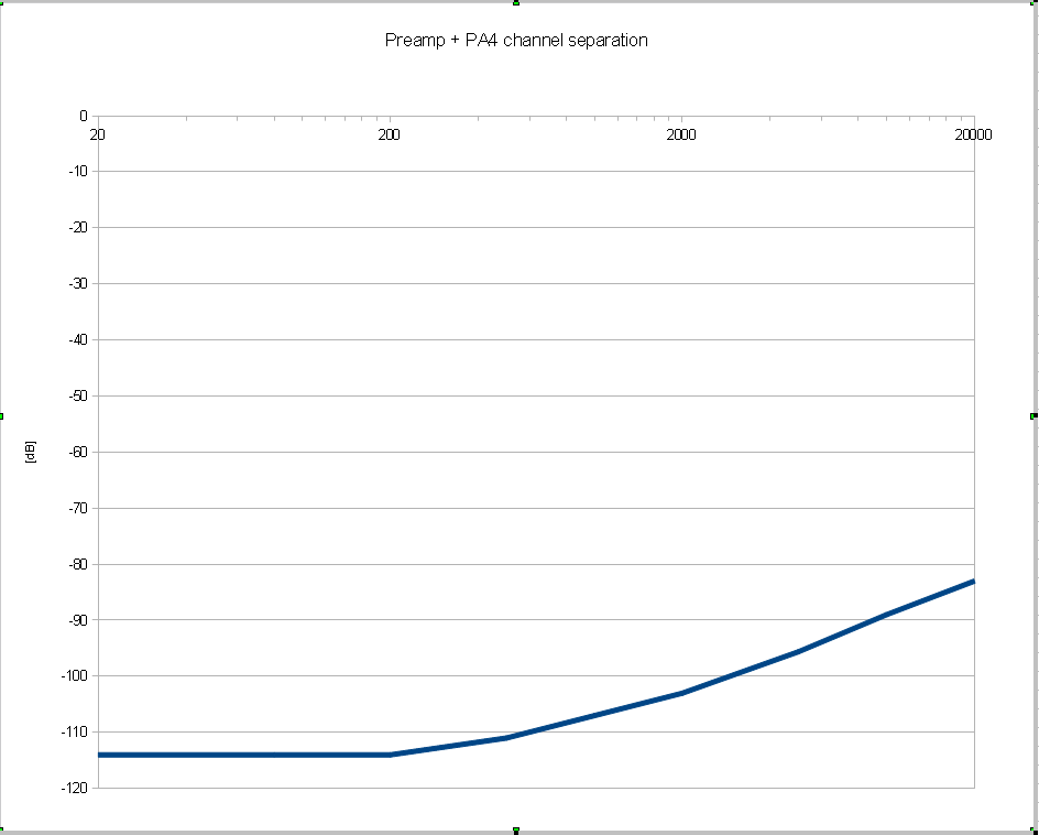

Channel separation measurement for JN
I have made one more channel separation measurement, especially for JN. Now, the whole chain of Preamplifier + PA4 power amplifier was measured. With cables and everything, of course. Then, a measurement of Preamplifier alone was done. One may see that the power amplifier has not changed the measurement result! Finally, as a reminder, channel separation of power amplifier PA4 alone is shown. The conclusion is that it is a preamp that defines channel separation, in case that power amplifier has a proper dual-mono layout and proper wiring.
