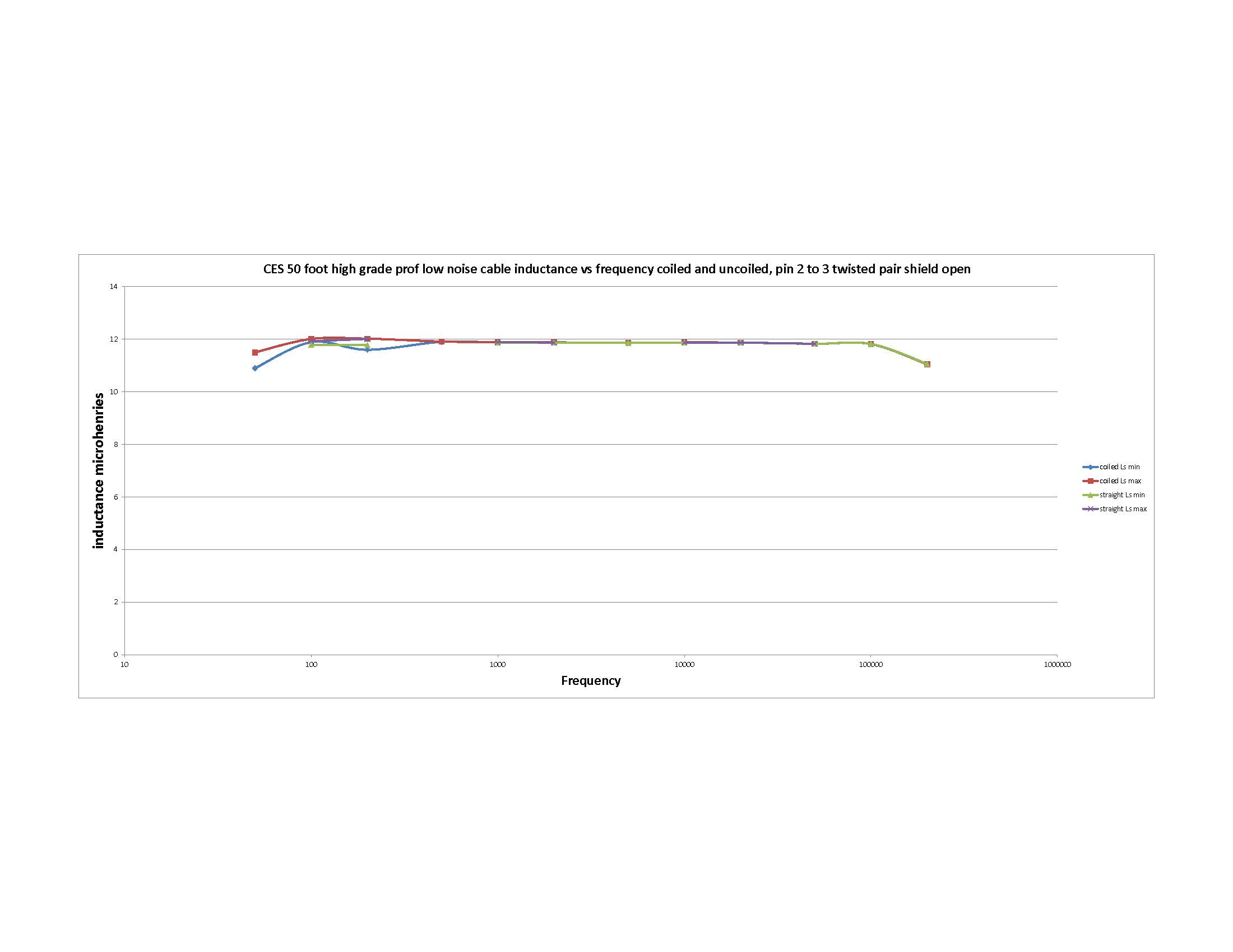

The first is the inductance of the cable coiled and uncoiled. The terms Ls min and Ls max refer to the upper and lower readings on the meter, it was bouncing around because it's at the lower limit of the machine's resolution and it's a noisy environment. I missed some data points in my rush to keep jc from wetting his pants.., excel doesn't draw a line through a missing point. Note that between 100Khz and 200 Khz, it starts to drop due to proximity effects on a 22 guage wire. Note that the bulk of the data actually is there. The values are so close that excel actually draws one curve over the others..

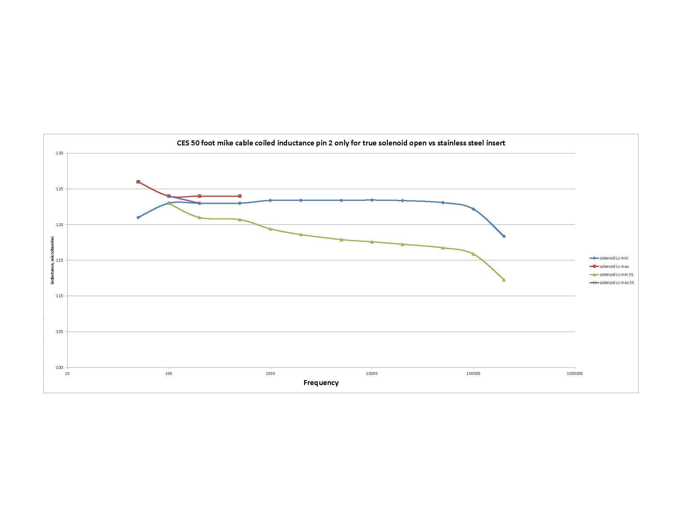

During this entire run, I measured the coil free air and then placed a 4 inch diameter 4 inch tall stainless cylinder in the middle to check for solenoidal fields. At no time did the reading change.

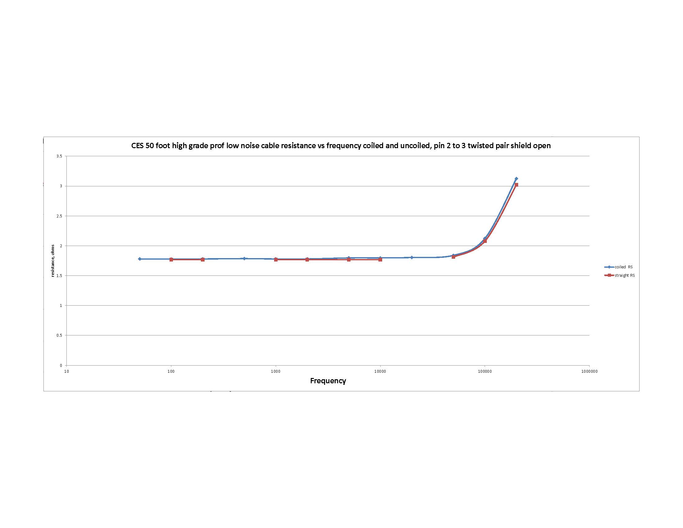

The second is the resistance comparison between coiled and straight. Again, no surprises.

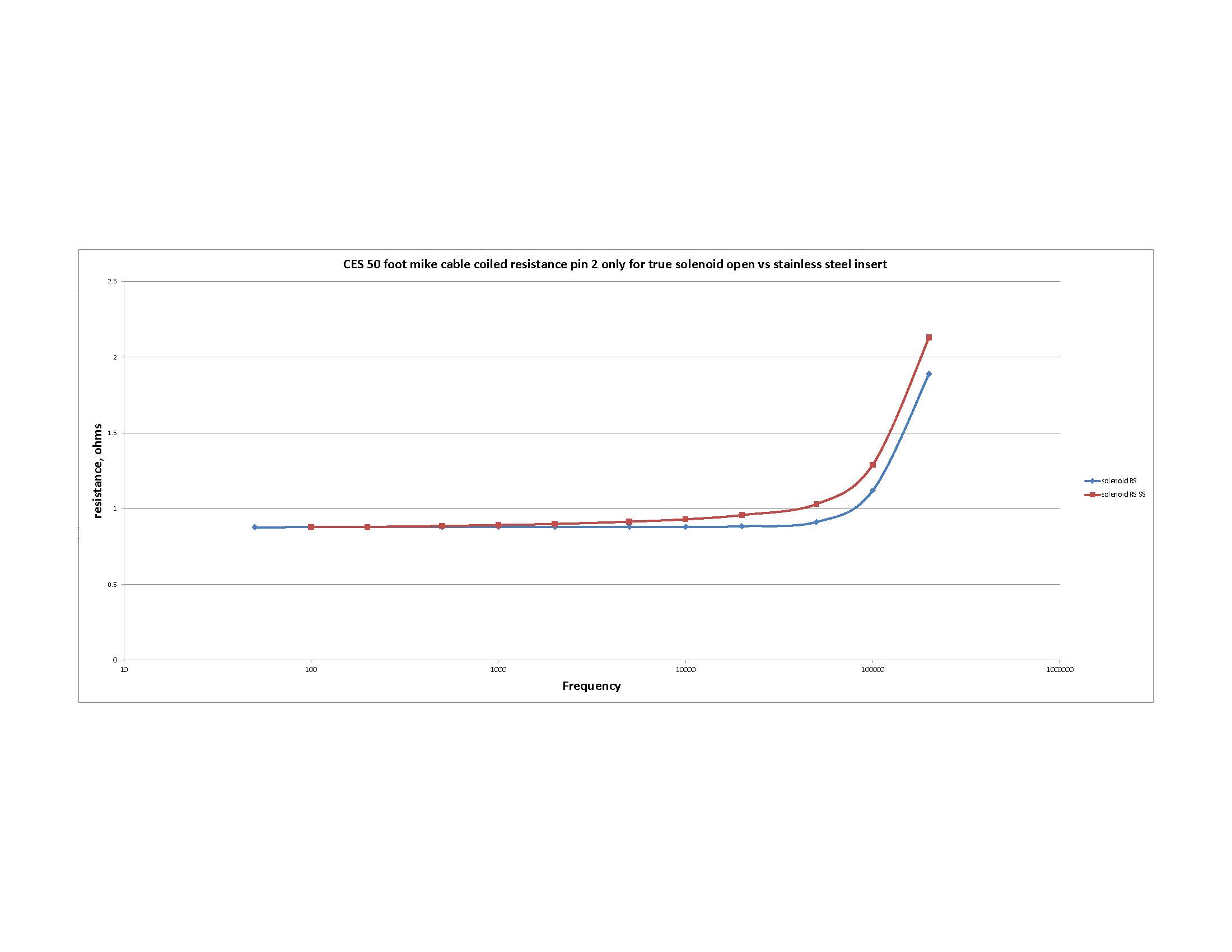

The third is a check to make sure that solenoidal fields can be detected within the coil via the insertion and removal of the stainless cylinder. For this test, I used only the wire in the cable connected to pin 2 of the xlr, giving me essentially a solenoid. The meter was sensitive enough to determine when the stainless was put into the coil, but only at frequencies above 100 hz. the effect of the stainless is to exclude the time varying field, so the inductance goes down as a consequence. Also, the resistance will go up as a consequence of eddy dissipation, shown in the fourth pic. Note the machine is incapable of determining eddy losses as opposed to proximity resistive increase.

CES 50 foot high grade prof low noise cable inductance vs frequency coiled and uncoiled, pin 2 t.jpg109.6 KB · Views: 245
CES 50 foot high grade prof low noise cable resistance vs frequency coiled and uncoiled, pin 2 t.jpg110.8 KB · Views: 238
CES 50 foot mike cable coiled inductance pin 2 only for true solenoid open vs stainless steel in.jpg111.9 KB · Views: 230
CES 50 foot mike cable coiled resistance pin 2 only for true solenoid open vs stainless steel in.jpg103.7 KB · Views: 233
