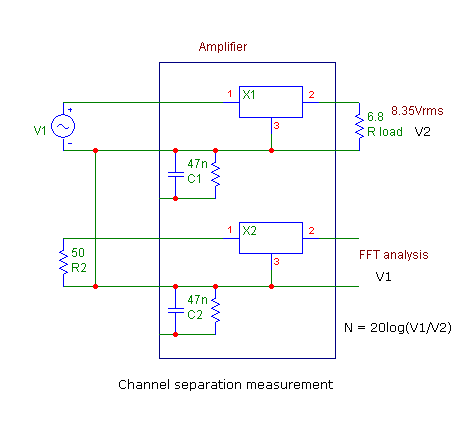

The prototype measured has only unbalanced inputs. It was measured the same way as when it is used for playback, pls see attached image. Regarding internal wiring - that's something I do not want to speak about in detail.

I have already shown the circuit, several posts before.
'Opposite sides' - you are referring to a final product with balanced inputs. In case of balanced inputs everything is easy - XLR body is on the chassis and pin 1 should be there as well.
The measurement I have shown was done on the prototype, which has SE inputs only. They are connected through RC to the chassis. R is only to discharge C, so it has high value. Chassis is connected to PE. There is no direct connection of analog grounds to the chassis and there is no LF groundloop. There is no chance to get crosstalk, so the channel separation is as high as it is.
In case you argue that analog ground should be connected directly to chassis, I say not necessarily - there are many laboratory power supplies in metal case that is connected to PE, but all DC outputs are floating.

I was referring to the overall chassis, you provided a picture of the whole thing.
It has the inputs far apart from each other on opposite sides of the back panel, and the outputs directly below the inputs.
You mentioned connecting the input ground to chassis, so I asked which one, or both?

Once again, the photo provided is the final product (with balanced inputs), but today I have measured a prototype that has SE inputs (I have no final product available). These SE inputs have bodies tight to chassis through C//R. The final version has balanced input with XLR's (both) directly on chassis.
