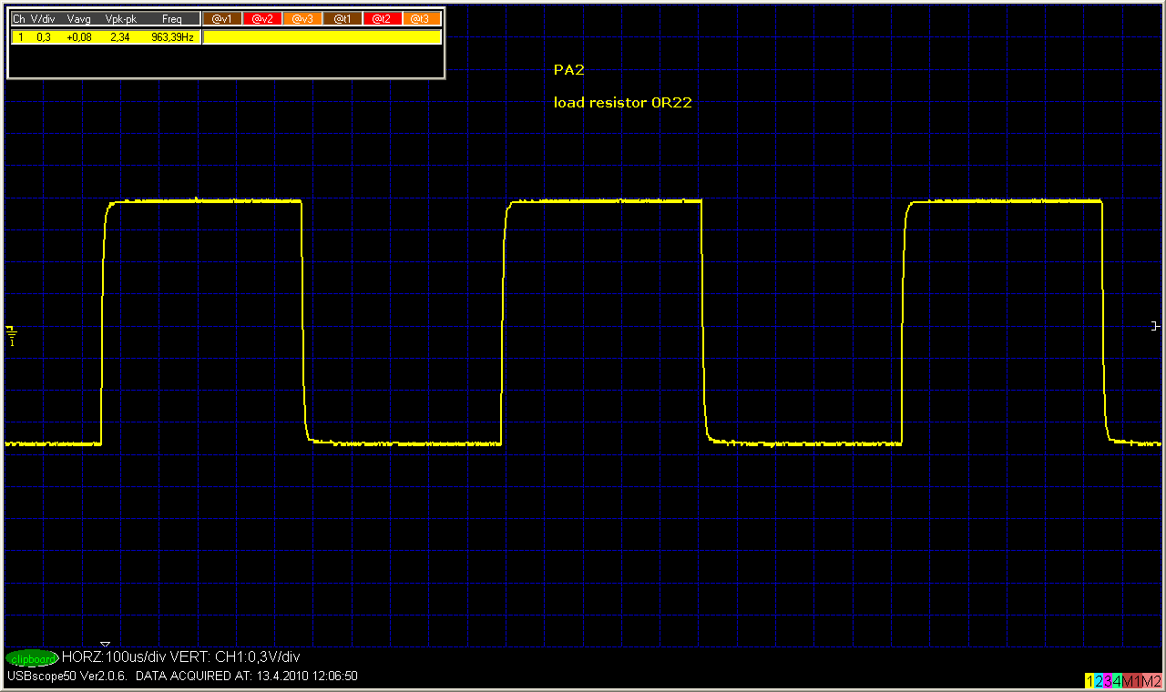

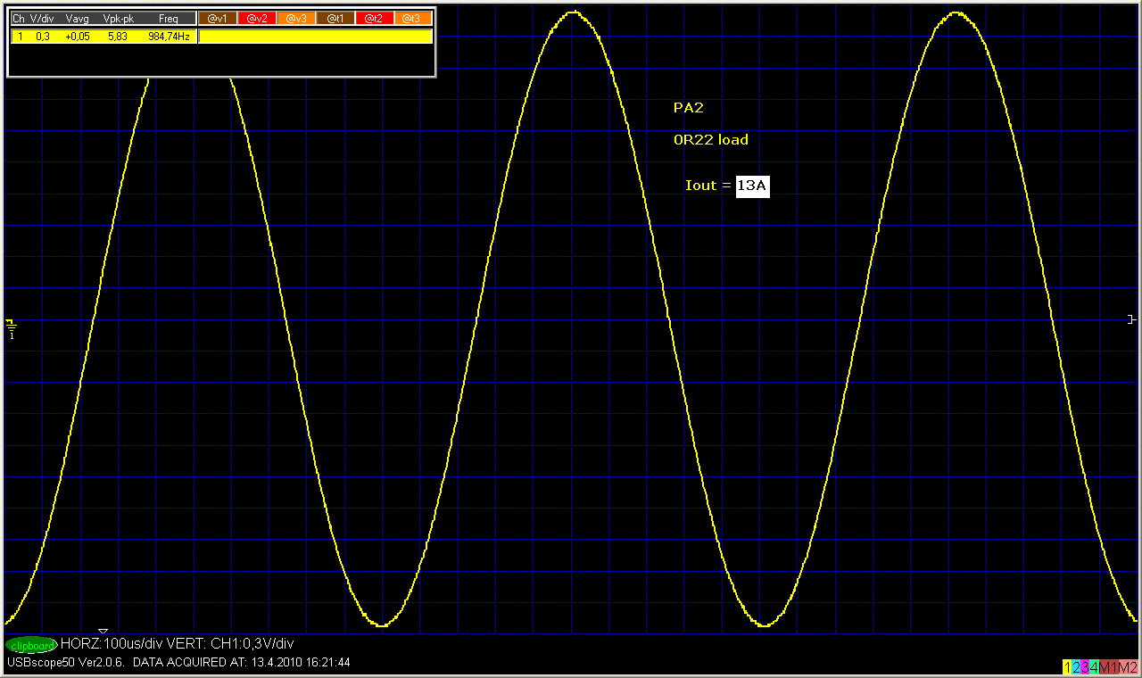

This is the test into 0.22 ohm load, smaller version with only 2 output pairs 🙂

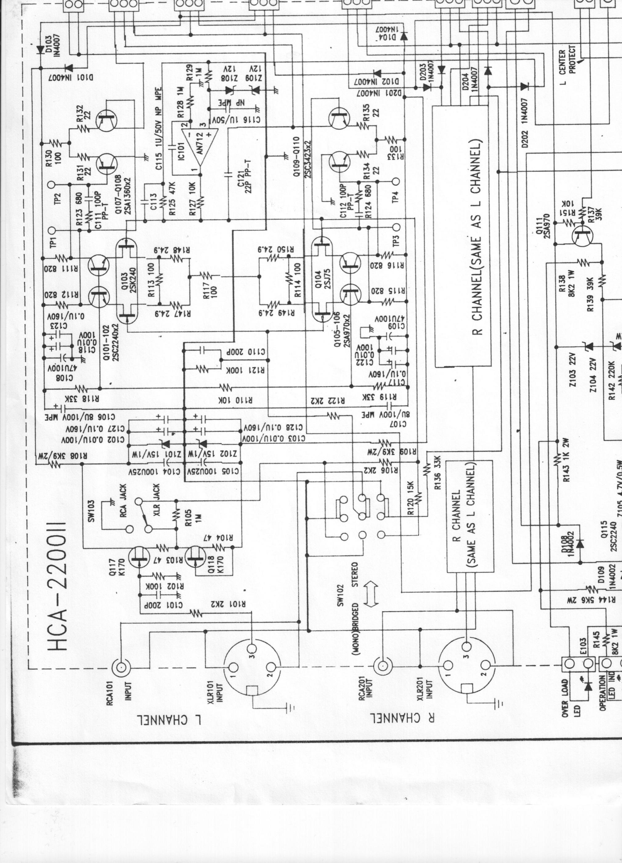

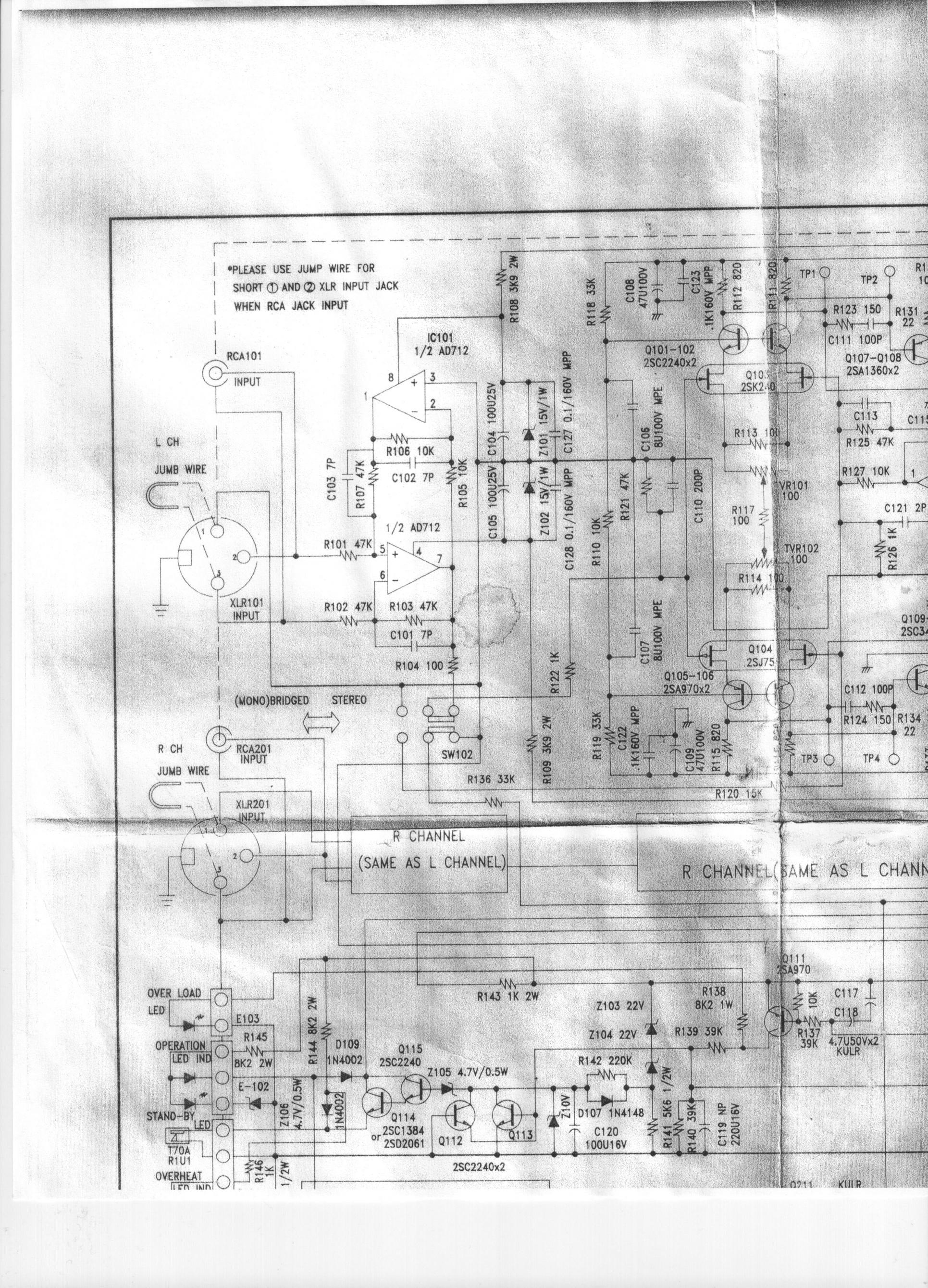

It was David A. Rich, Ph.D. who wrote a criticism of my removing the AD712, and using a discrete replacement consisting of a pair of 2SK170 fets per channel instead. He was right, IC's measure better! However, what he ACTUALLY measured was a design change made in Taiwan without my knowledge. We sorted this out internally, when I showed written evidence of their mistake that caused excessive 2'nd harmonic distortion from the jfets.
What happened is that I specified a V part, 10ma-20ma, and they used a GR part 3-6ma. NOT GOOD, when the bias resistors that I designed in were for the V part. The resistors starved off the GR parts and distortion was added. Of course, I was not informed by Parasound or the magazine until the review was published, and I was not asked to comment on it.

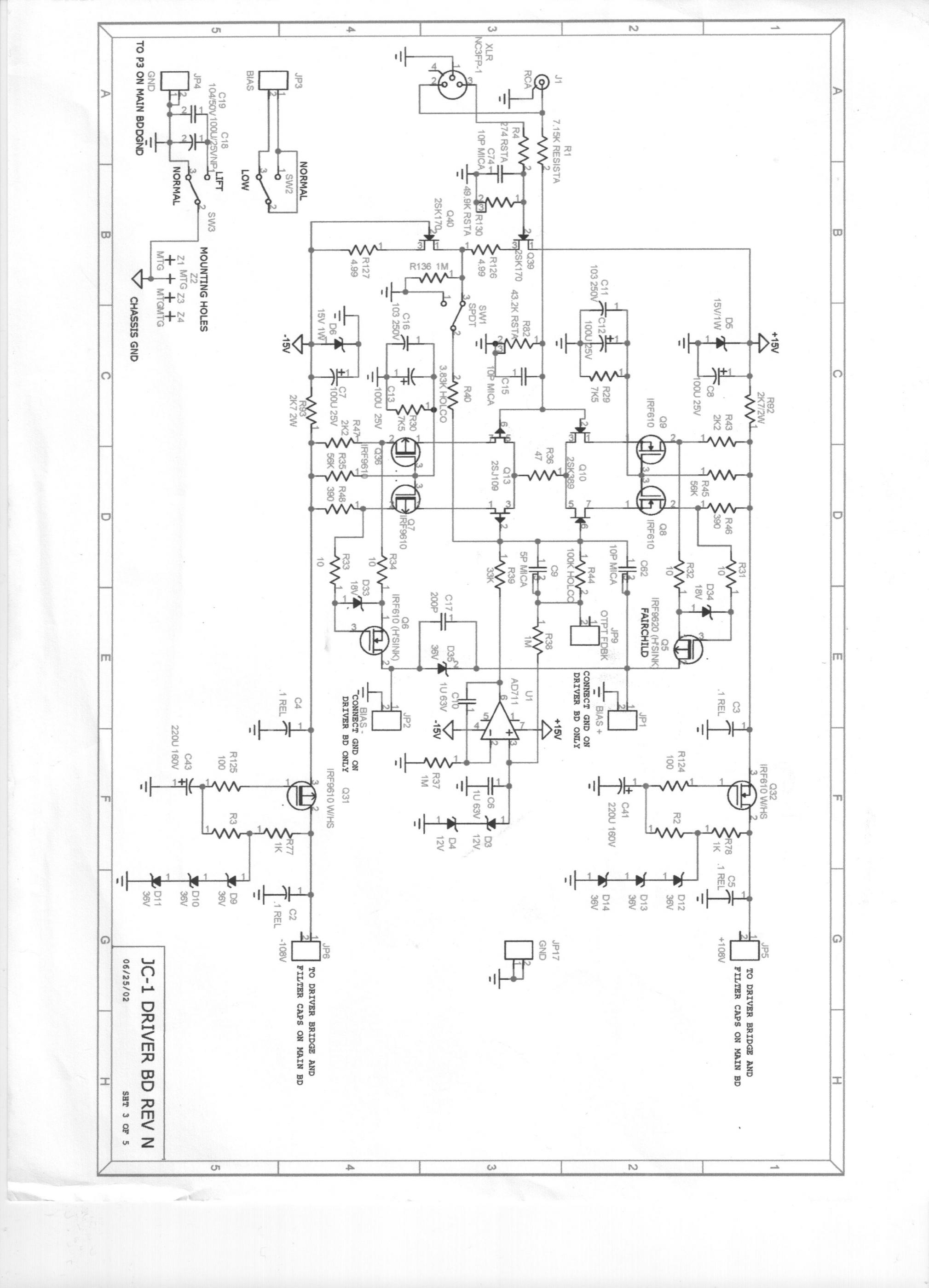

OK, let's look at what happened: Here are 3 schematics, the first being the 2200mk1, the second being the 2200mk2 (with the mistake), and third a JC-1 input stage (fixed).

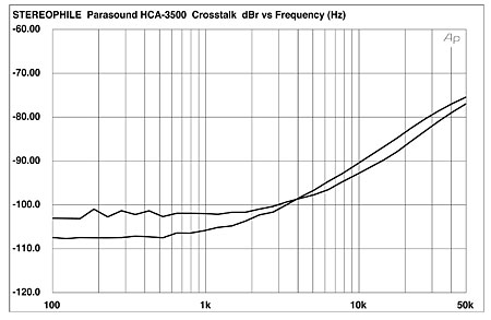

All of the JC series is personally done by my associate Carl Thompson, who also did the layouts of the Vendetta Research phono, Constellation phono, and even the CTC Blowtorch. (He is the T in CTC) He is an expert in layout and he also cares more about crosstalk than most designers. I have little control over the layouts of most of the Parasound products. They just get a 'simplified' schematic from me and everything else was generated in Taiwan, often by people I never was contacted by. It could be really frustrating at times. Here is the crosstalk of the HCA 3500. It is not perfect, but more typical of what I usually expect.
