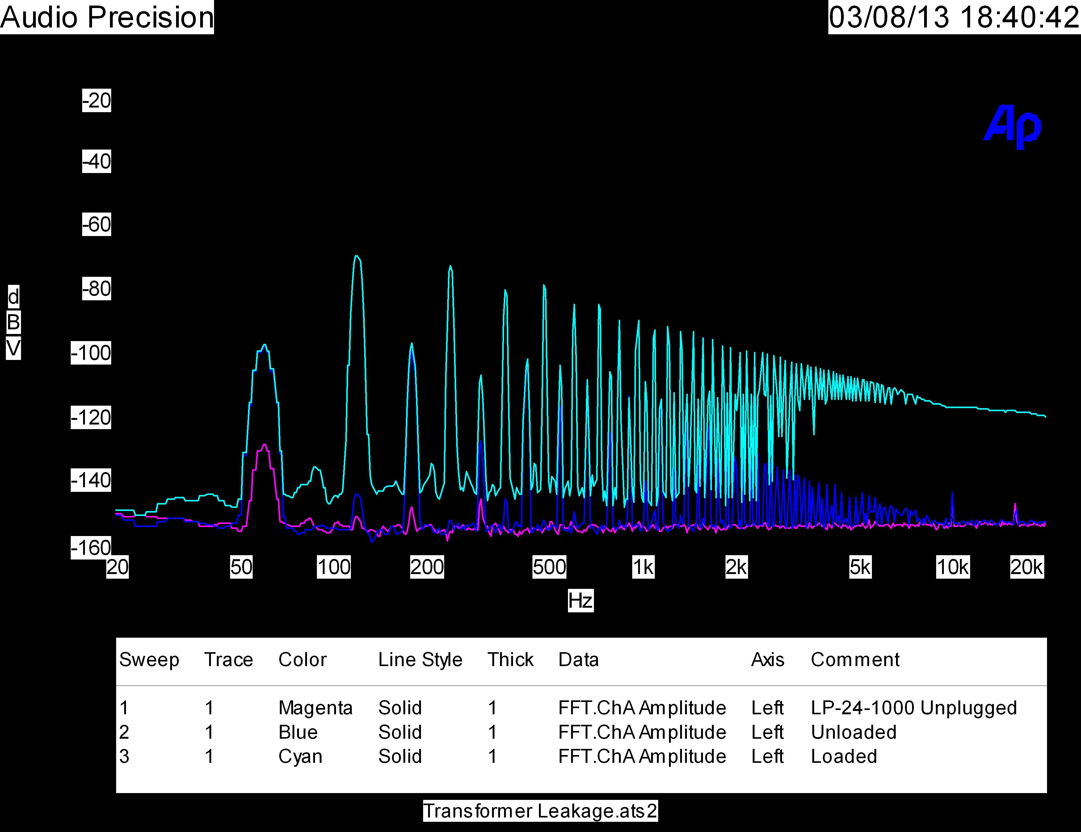

Attached is how...no further explanation given... no more fodder for trolls.

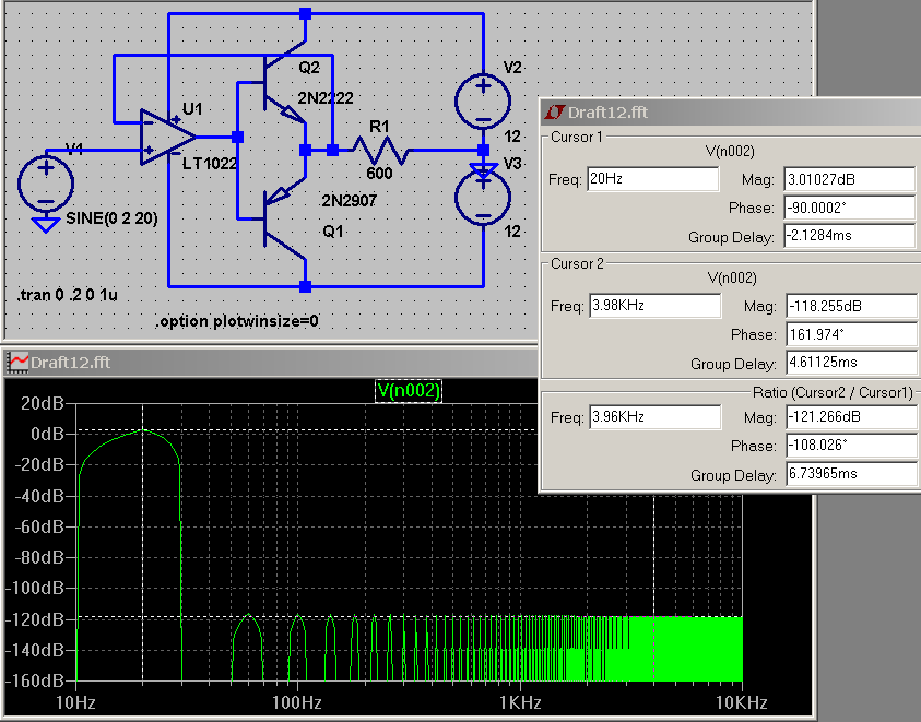

you have to be kidding or smoking the good stuff - the only way I can see for (really, really terrible) audio amplifying electronics to create 200th harmonic is to deliberately introduce a deadband/clipper
for instance a >20 year old fet op amp, one step up from TL07x, wrapped around a Unbiased complementary follower stage:
and that incredibly badd example's spray is >120 dB down from even consumer line level:
you have to kidding - the only way I can see for (really, really terrible) audio amplifying electronics to create 200th harmonic is to deliberately introduce a deadband/clipper
for instance a ~ 30 year old fet op amp, one step up from TL07x, wrapped around a Unbiased complementary follower stage:
and that incredibility badd example's spray is >120 dB down:
