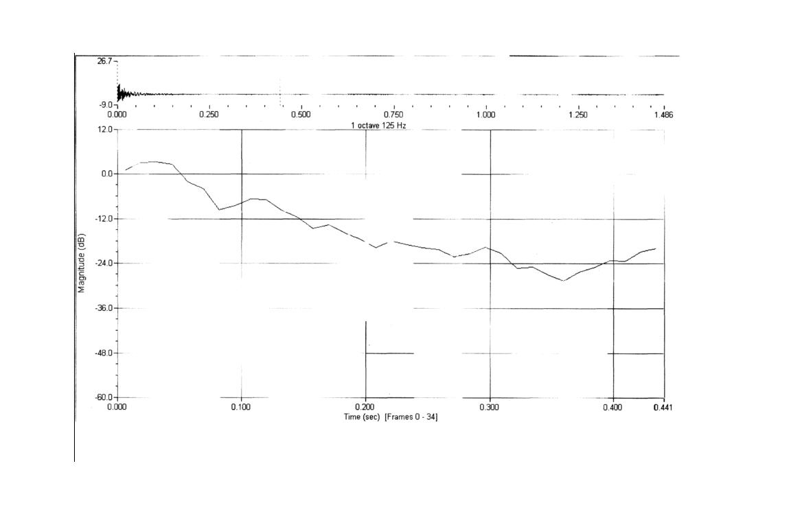

So now I present a classic acoustics problem to illustrate the point. Attached are before and after reverb time curves of a church with 565,000 cubic feet of volume and 63,000 square feet of surface area. So how many sabins of absorption at 125 hertz are in the room before treatment and how many after?

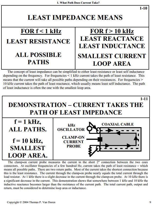

How about everybody getting more serious on this thread? Cables are problematic. That is our experience. Why, specifically, is sometimes debatable, BUT they do not always follow the simple model that most engineers like to use. This is being shown here today. Let's keep on target, so that we can be more aware of potential problems.
So then, what we should be discussing is the bottom drawing of page 9 of the 2004 Tom Van Doren lecture series. It details how the ground current goes when two paths are available to it, one being a coax shield.
I couldn't seem to copy the single drawing of the pdf, perhaps George could?
Thanks, John
Thanks, John
http://www.ewh.ieee.org/r5/denver/rockymountainemc/archive/2004/October/Experimental_Demo.pdf
