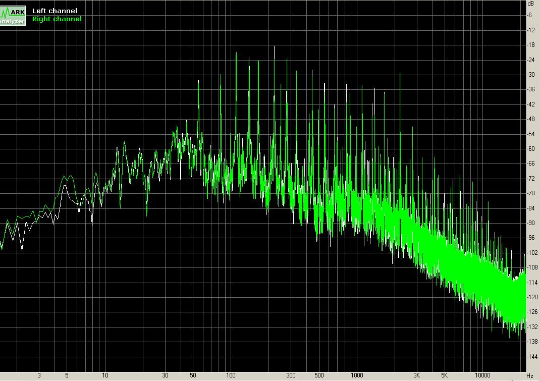

It is the content of the music that is played through these speakers that don’t go low, so your brain tries to synthesize the lower frequencies but it fails to do it appropriately as there is a lot of low freq that doesn’t come out of the speakers .
As you saw on the waterfall plots I posted earlier, the very low frequencies modulate at different rates from the low frequencies and these at different rates from the mid frequencies.
The synthesized in your brain fundamentals are wandering and assigned a wrong amplitude.
See the attachment below for the FFT of the whole file.
How much energy lives btn 20Hz- 100Hz ?
Notice the relation of the higher harmonics with the peaks below 100Hz.
See the peaks below 20Hz. These are the signatures of modulation.
The left channel distorts more as it is hotter than the right channel.. It reaches –3.0dBDFS at the frequencies that your speakers boost (100-200Hz)
You say that it is the whole audio system that matters. Yes but you fail to include the music content into this system.

PS. Build a set of LP electrical filters which will fit the acoustical LF behaviour of your PC speakers in freq, slope and Q. Play this organ file through these electrical filters with large speakers and notice what you hear.
George

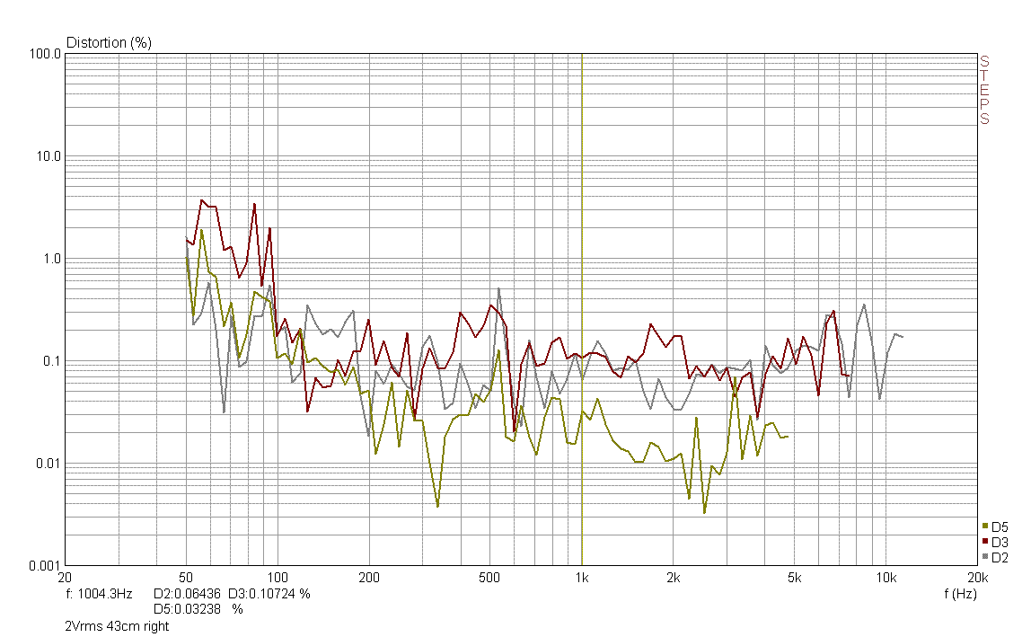

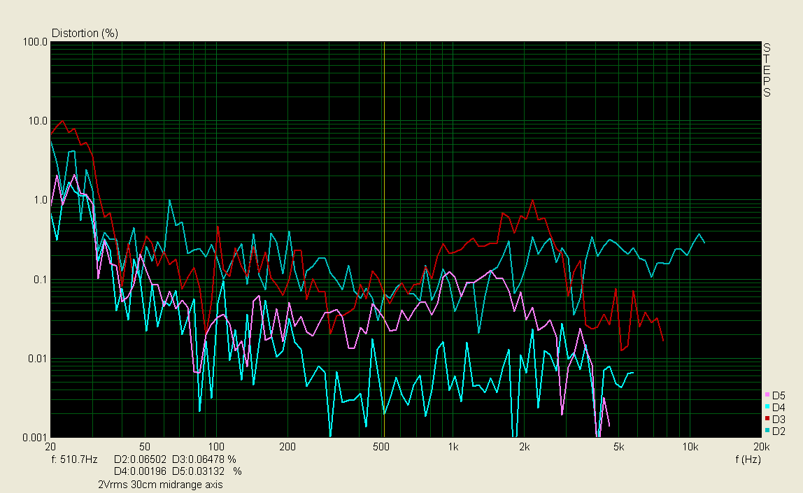

I appreciate what you're saying, George, but again note I am emphasising that this type of musical signal will be such to expose the limitations of this type and quality of speaker.
The left channel problem is 100% an issue with my particular examples of these speakers - I've generated ramped, pure 100Hz tones, and listened to how the speakers handled this test signal. Excess distortion harmonics produced by these drivers at the bottom of their useful range will do plenty of damage to the tonality of the organ note, let alone modulation of sub-100Hz fundamentals being inaudible.
I'm not quite sure what you mean by "you fail to include the music content" ...
Those electrical filters could be largely mimicked by doing software equalisation of the sound file to roll off the bass content. And I feel it still would differ because the superior, larger drivers would have quite different harmonic distortion behaviours in the 100-200Hz range, compared to the PC units ...
Which units are distorting the most with that test signal? These at the satellites or at the sub?
Did you check if it is the embedded amplifier that is overdriven/distorts and not the drivers?
Have you performed freq response sweeps on this set? At what output dB levels?
