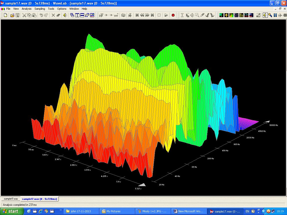

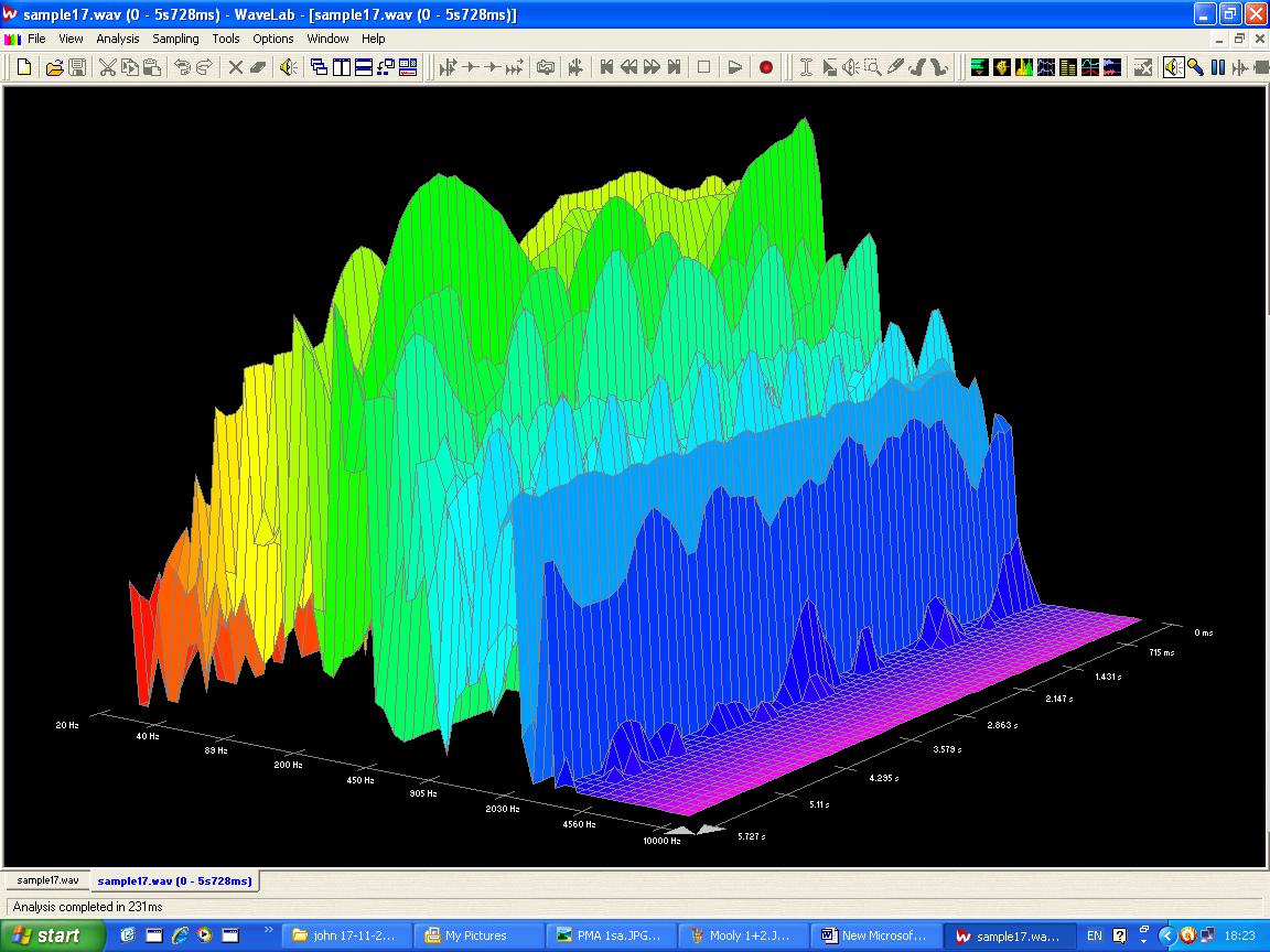

I'm curious what are the spectral characteristics of a single note on a real piano? The FFT's need some massaging to separate AM and FM or extract instantaneous frequency. I suspect a real piano is more AM than FM and the LP is both +.
I first thought I could take a look what acoustic piano sample CDs we have in the studio, but then found this link:
Free Piano Samples!
Analyze as much as you will 😉

I expected that. Now can we discuss how the attack varies with frequency. George has already mentioned sustain.
Ed
Assuming that you are interested on the physical phenomenon itself and not how we perceive it, there are many factors that come into play (too many for a barely meaningful answer
In a broad frame, the onset transient of the various instruments spreads from 10 to 300ms (statistically frequent case 100ms)
There is then the individuality of each particular instrument type.
Further on, each particular instrument (and for each fundamental tone) builds-up every individual partial with a different rate and final amplitude.
Then, it is the kind of blowing, touching, fingering, bowing by the player.
Then it is the onset and reverberation properties of the performing room.
Last but not least, it is the position and distance of the listener or the microphone from the instrument.
Ed, there is a good reason why I have posted the organ file.
http://www.diyaudio.com/forums/anal...ch-preamplifier-part-ii-4504.html#post3705560
Pavel,
I brought up the organ for what I thought were obvious reasons. But only you and George seemed to get it.
As George had covered the basics of the envelope of a note. I think it should be clear that just looking at a single time sample spectrum does not contain enough information.
Where this is headed is that in the original synthesis what was addressed was pitch and amplitude. Newer techniques used FM. Synthesis. Looking at the spectrums you showed had base spreading hinting at FM.
You also mention one fault of a tuned port in that it causes a sharper roll off. Another issue is that the resonance lengthens the sustain period.
Looking at note synthesis and how it fails or succeeds points to important issues in perception.
