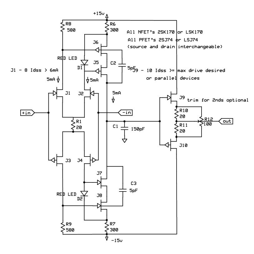

Hi Scott,
You posted this schematic a while ago and I am trying to make a mental sim of it, but I don´t get it quite yet.
The first question I have is with regard to J6..8. In the way it is drawn, wouldn´t it act as an inverted common mode amplifier? The only way it could work in my head is if J6 would be an nfet and J8 a pfet.
The second question is why the non-inverting side is connected to the rails through resistors R8 and R9, while J2 and J3 share a connection to the rails with the succeeding stage over R6 and R7. If this is to compensate for nonlinear behaviour in J5..8, can you please give a clue as to how this works?
I think this is the right schematic. Check it, those who can, there still might be an oversight somewhere.

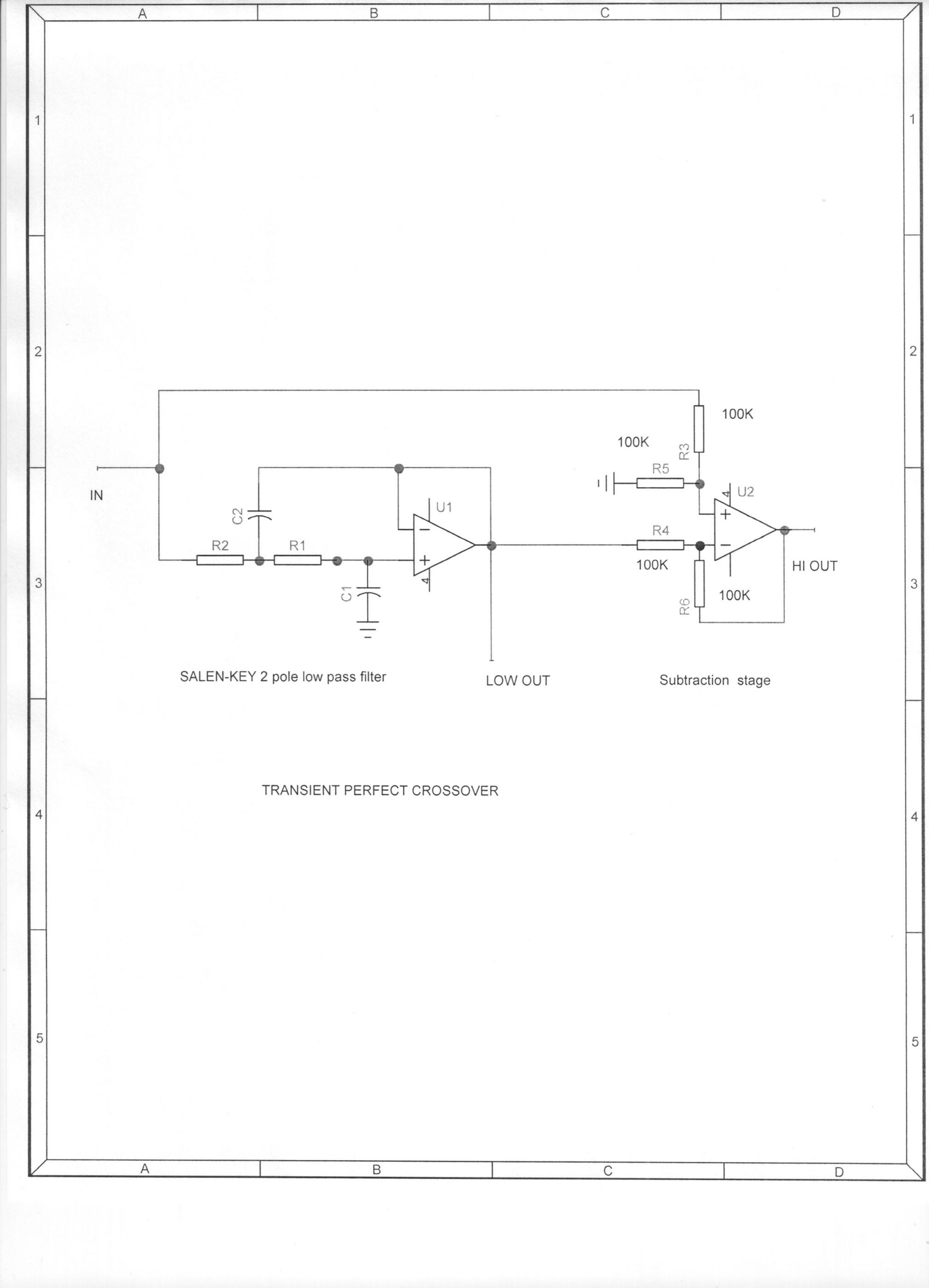

My guess why this never took off is because you substract the phase shifted signal that comes out of the low pass filter from the not-phase shifted original.
Perhaps it would work better if you would first run the original through an all pass network that generates an identical phase shift as the low pass filter, before substracting.
But, in that case, you could save an opamp by just using another Sallen-key high pass filter and forget about the whole substraction idea.
Sy, you are right.
What it boils down to in my eyes is that you ask from the high driver to correct the phase shift of the low driver. Is that good? No, besides the problem of achieving only a 6dB slope on the high section, this also requirs a bulge in the high filter response around Fx.
Translated into what this does in a speaker: on axis, the speaker may be flat, but at the same time, you will create a powerful lobe off axis around Fx.
Before too much speculation is put forth, the problem with the TP crossover is that it is difficult to achieve good enough ACOUSTIC SUBTRACTION to make the crossover effective. However it can work as a subwoofer to woofer xover fairly well. AND it has been used to frequencies of 4KHz and even higher with PROPERLY 'TIME' ALIGNED SPEAKERS, TW0 SPEAKERS (of the same speaker type) PHYSICALLY OR WITH A DELAY ADDED TO ONE SPEAKER, PLACED IN ALIGNMENT WITH EACH OTHER.
