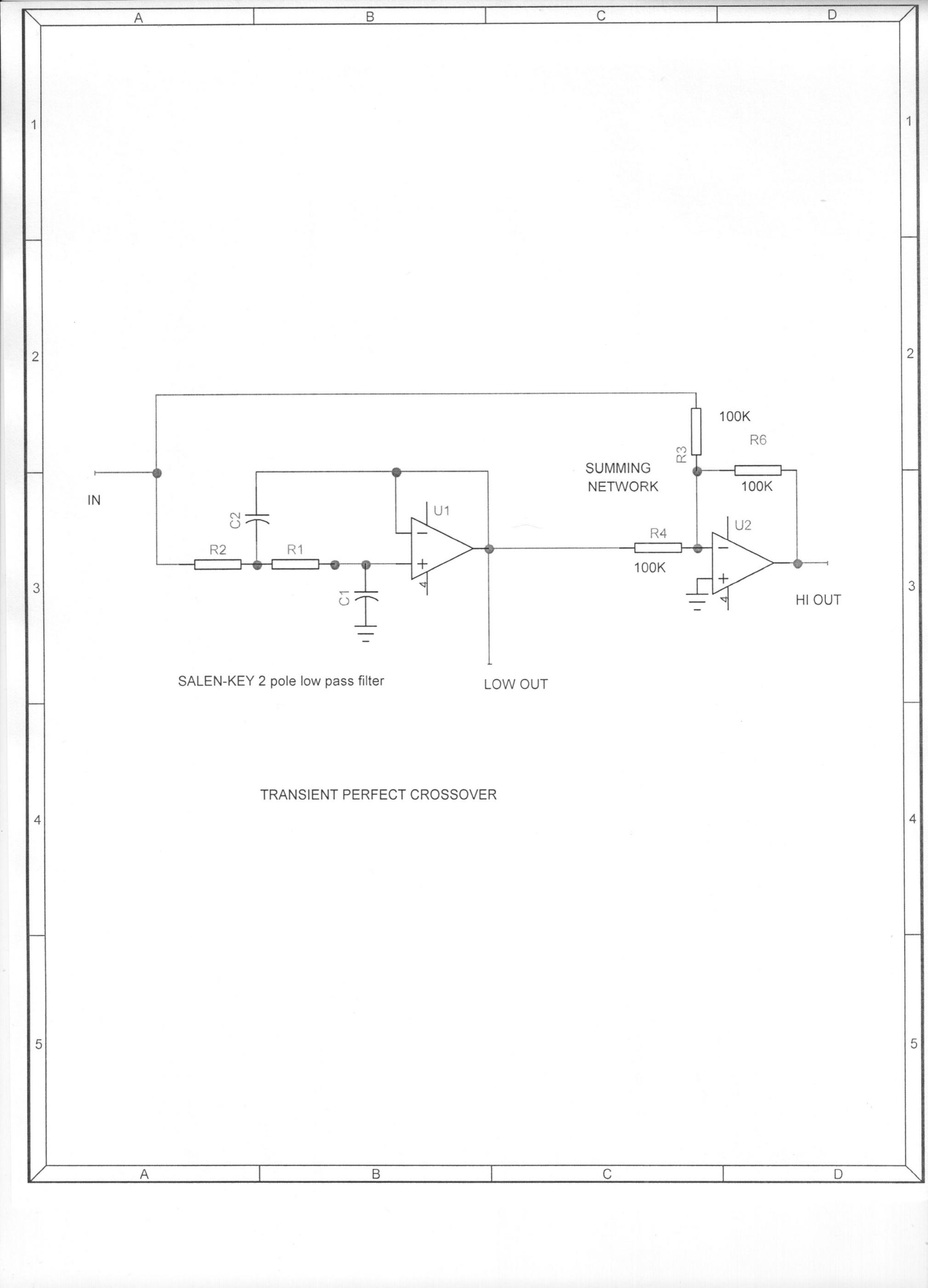

Wayne, this is a SIMPLE schematic of a Transient Perfect Crossover.
It was first pointed out in the AES by a Dr. Ashley in the 1960's. I learned about it from John Meyer (of Meyersound today), back in 1974, and we made a successful 3 way all horn loaded speaker with one, in 1974. It DOESN'T WORK for just any set of speakers, we can talk about where it really fails. However, IF you sum the hi pass and the low pass network back together, you will get the ORIGINAL SIGNAL.
It is SALLEN-KEY, not Salen-Key

I made one like that and someone sniveled
because the out from the subtractor wasn't
precisely 12 db/oct
It can't be, otherwise the summed output waveform would be different than the input. Subtractives always give you asymmetrical slopes except for first order.
That circuit isn't a substractive xover because it has an adder at the output, so it isn't substracting anything... 😕 😕
Someone forgot to invert polarity. 😀
