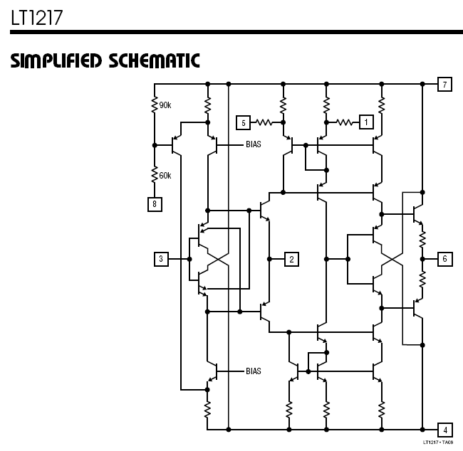

This one has no open-loop data but looks interesting...

aparatusonitus said:
Yes Pavel, AD844 is an great opamp (I'm using it as well)...but it has one big flaw...it's out of production, so availability, even for diy purpose, in future is questionable.[snip]
No, its the AD846 that is obsolete, the AD844 is in full production and will not be obsoleted in the near future.
You should try it: 2k from pin 2 to gnd, 10k from pin5 to gnd, input pin3. This is a gain of 5 amp, no global feedback, still quite linear with very low distortion. No IM due to feedback-components! Ol bw = cl bw = above 1MHz!
I agree with Dimitri that you can even improve this by an external buffer (from pin 5) instead of the internal buffer at pin 6.
Jan Didden
You are right Jan, it was the AD846
I think I've 2 pcs of AD844 left somewhere, so I might try them as per your suggestion as headphone amp with Allison type buffer, especially 'cos I've discover recently that non global feedback SS amp sounds extraordinary. Thank for the tip Jan!
One interesting option is to use a pot for the resistor at pin5. That attenuates also the noise ahead of that point if you turn down the volume, making the S/N ratio independent of level.
OTOH a pot before the 844 does lower the distortion when you turn down the volume.
It's a tradeoff, and depends on the line input level to the 844. If it is lower than a volt or so, the pot at pin5 may sound better.
