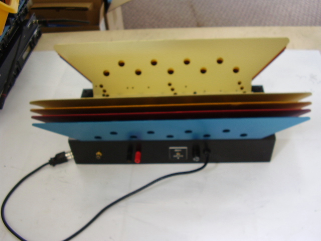

Attached is the picture of the setup. A current source of 1 amp was used and the voltage across the resistors was 7.32 and 7.31 volts. Both pieces are .125" 5052 aluminum 3' x 6" with the hole .125" centered. The finish was mill finish cleaned with a lye bath. Paint is Rustoleum Flat Black spray paint both sides. Temperatures measured using a bead thermistor in direct contact at the heatsink back just under the mounting bolt were 39 & 42 C.
Not a lot of difference IMO. I don't see 10-15% difference changing things enough considering a resonable overdesign margin.
Let us look at the costs! One square inch of .125" aluminum costs me about $.04. The cost to anodize it black is around $.02. So for heatsinks running under about 50 C the advantage is clear. For those running above that the advantage goes to a fan. But if a fan is not acceptable for either noise or MTBF then the advantage goes dark.

If I am reading this correctly and not doing the math here it would appear that a small increase in surface area would be cheaper than the black coating for the small 10% differential you would get with the black. If space is at a premium then the black coating may be required but if not simply sizing the aluminum a bit large would make a greater differential. That does not mean we shouldn't use the black coating, just that surface area would seem to be the driving force here. Correct me if I am wrong, I could just do the math and answer my own question.

Metal cost $.04 To get 10% better $.044
Anodized cost $.06
However anodized radiates better as temperature goes up. So as a heatsink gets to temperatures that one should avoid any human contact anodized becomes price effective. But a fan will keep such a heatsink cool enough to be safe.
So when a heatsink size is limited and you cannot use a fan then anodized is a solution. The other reason to anodize is that it looks good.
Shown is my Class A "Butterfly" amplifier.

Does the anodizing type play into the radiation properties here, soft vs hard, or is it just the black body principal that covers the radiation properties of an anodized surface.
Soft anodizing usually uses a dye to get the color. Hard is a natural black-ish color depending on alloy. So for cosmetic use soft is better. There will be slight difference in radiation properties, but as the hard color depends on alloy predicting it is not practical.
