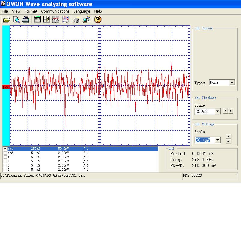

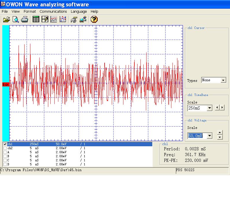

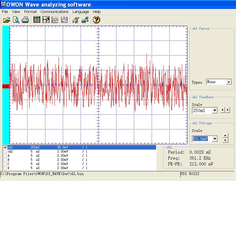

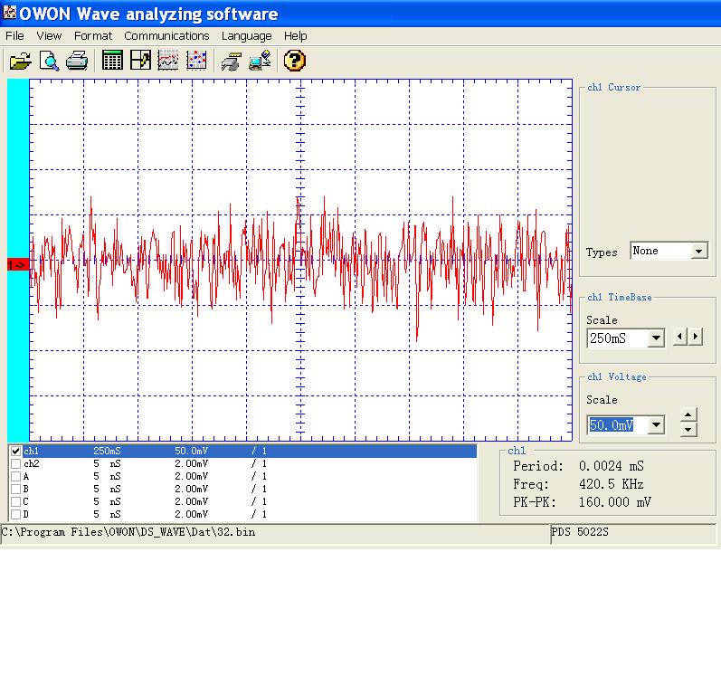

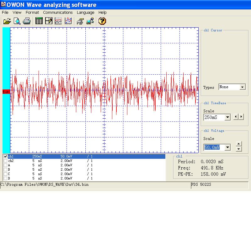

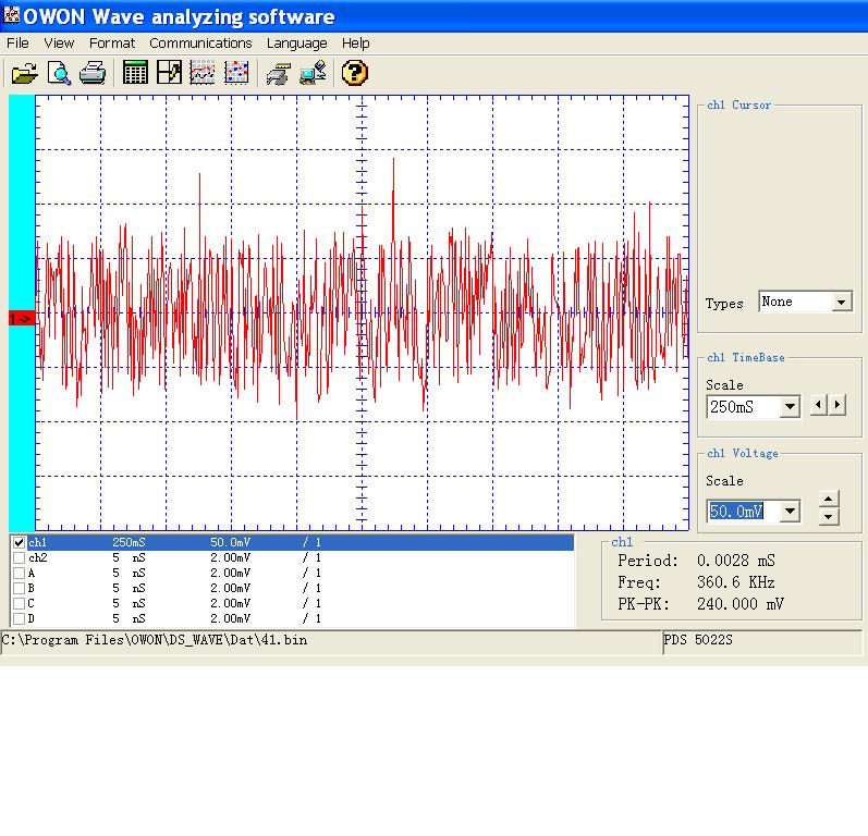

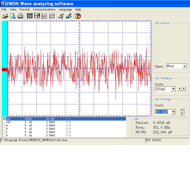

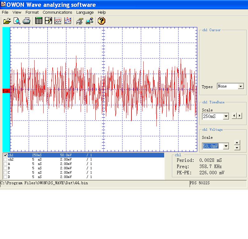

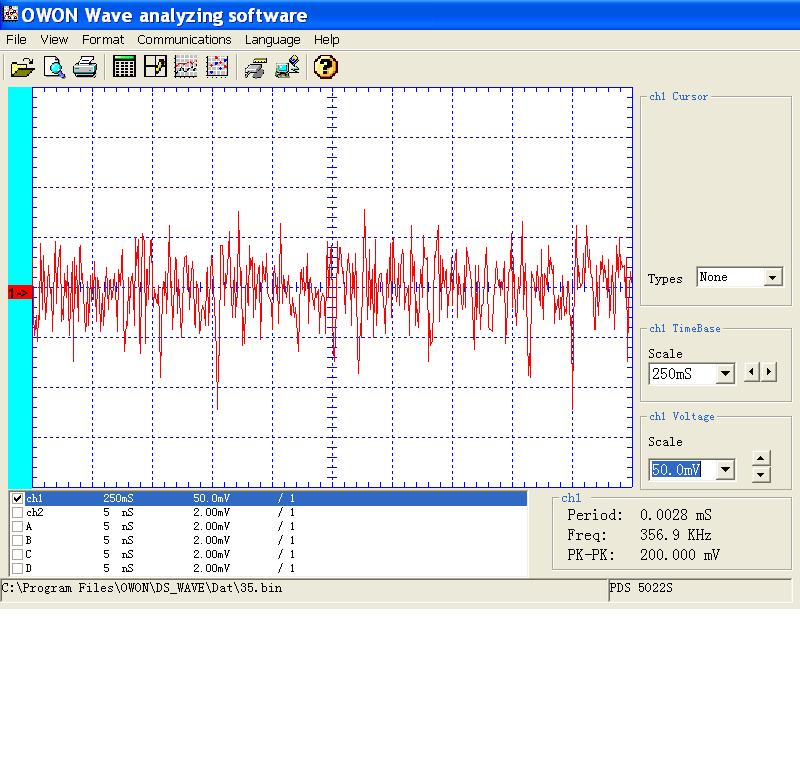

Well I slowed down the sweep speed, lowered the level and used a transformer to isolate the signal across the device under test.
Here are some of the results. It is easy to see the difference between the Bybee and a resistor of the same value. (+/- 5%).
First five are the resistor the second five are the Bybee.
All this proves to me is that you can tell the difference between a resistor and a Bybee. Peak to peak voltage averages 176 mV vs 226 mV for the Bybee.
I have on order more .025 ohm resistors of different types. If those change things I'll post more pictures.
ES
Your noise is still indistinguishable from desired signal and you are not testing the claims. If those waveforms were the low frequency content of a piece of music they should be the same.
EDIT - I tried to read "Want is Quantum Purification" again, it's such nonsense there is no identifiable claim, you can leave me out of this silliness.

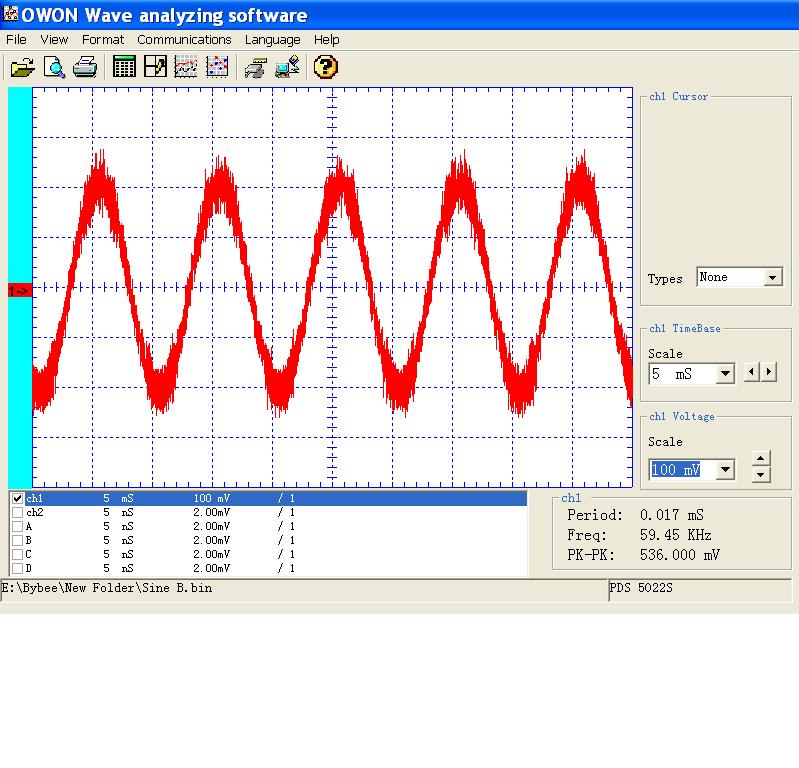

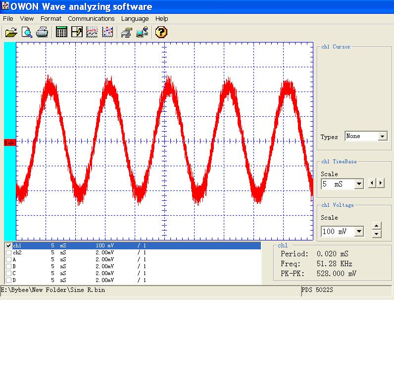

Here is the amazing part the traces using the same setup filter included but sourcing a sine wave with noise.
What is so amazing? Different Ls and different Rs.
Remember, Ls and Rs vary with frequency. Rs is a composite of element resistance and eddy losses. Ls is a composite of element inductance and lenz exclusion.
And your meter doesn't have the resolution to see it distinctly.
Sweep a sine while doing a differential measurement between the bybee and the resistor.

The inductance is not that different, and low enough not to matter for the 160 Hz low passed (12 db Butterworth) noise and test signals. The sine wave stays very close from 20 to 180 Hz. (Say 5% P-P)
I looked at the baseline noise in my system from the power amplifier etc, and set my noise level above that and then ran the measurements for noise and then repeated the process for sine waves. I have done about 100 data runs.
I have no clue why the results are what they are. They are interesting.
I'll let it sit for a bit and perhaps try something close but different.

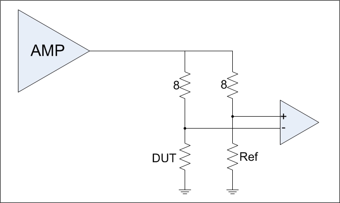

Sweep a sine.
Oh, and don't forget symmetry. The ground return current should be physically between the dut and ref, then physically between the two 8 ohm resistors, where you should use coax to get from the resistor pair to the amp to exclude external field from the drive wire. The vtap pickups to the IA should be tight twisted pair. Make sure the IA has sufficient CMRR for the frequencies of interest.
And Ed, your seeing vdrop across the bybee. It's either L, R, or a combination. Use a real test setup to determine the mag and phase of the difference vs frequency.
I will tell you up front, you are not going to be able to measure resistive difference at that value vs frequency. You can't control your test setup enough to do so. That is a big caveat to low impedance measurements..everybody gets bit by that. The only thing you can do is use the test setup I show. If you can get the setup to work well enough, we can discuss using two tone, what can happen in the non linear realm, and what it means.
jn

JN
When I get a chance I'll do the bridge setup into the AP and compare the Bybee to a straight resistor with the same R & L as shown on my GR test bridge.
I'll also FFT my noise source after the LPF.
My calibrator has been a straight wire. It does read lower noise than the R or B. Like I said the results are interesting. The B does seem to be a bit different than my reference resistor. That is why I may try a few more types.

You will not get correct results with the AP if the loss mechanism is rate of change dependent as eddy dissipation is. While the differential with sine plus noise is interesting, you most likely will not be able to develop an analytical relationship to describe the difference. That means that the chances are great that you will come to incorrect conclusions.
That is why I recommended sine first.
