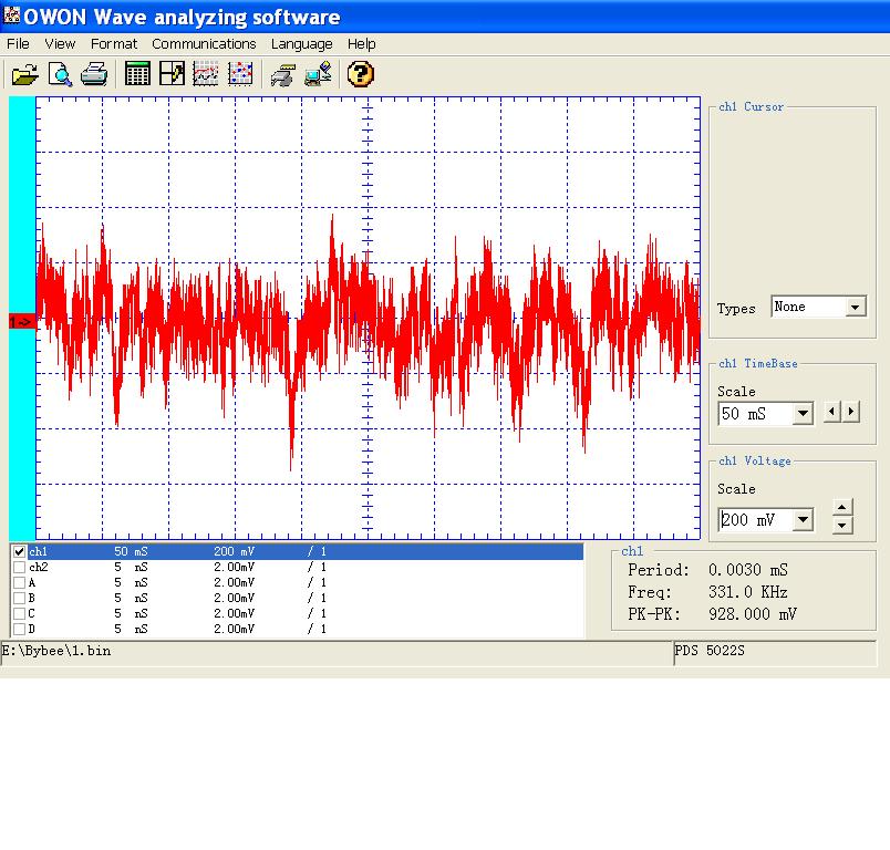

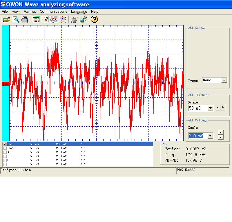

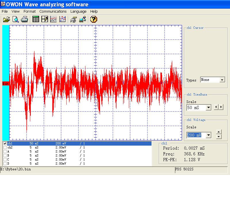

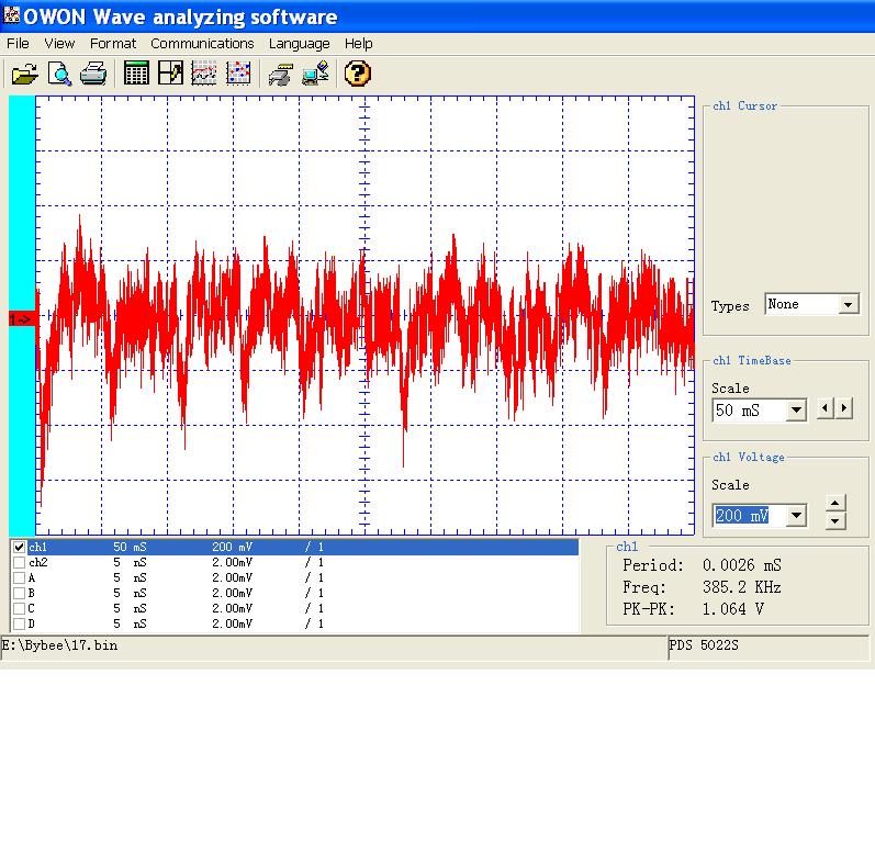

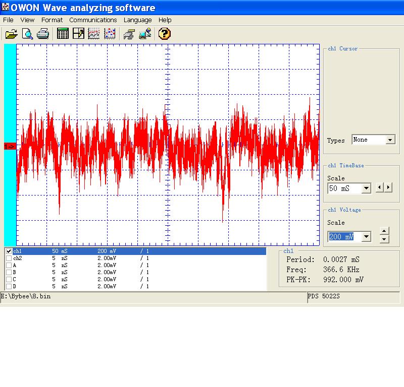

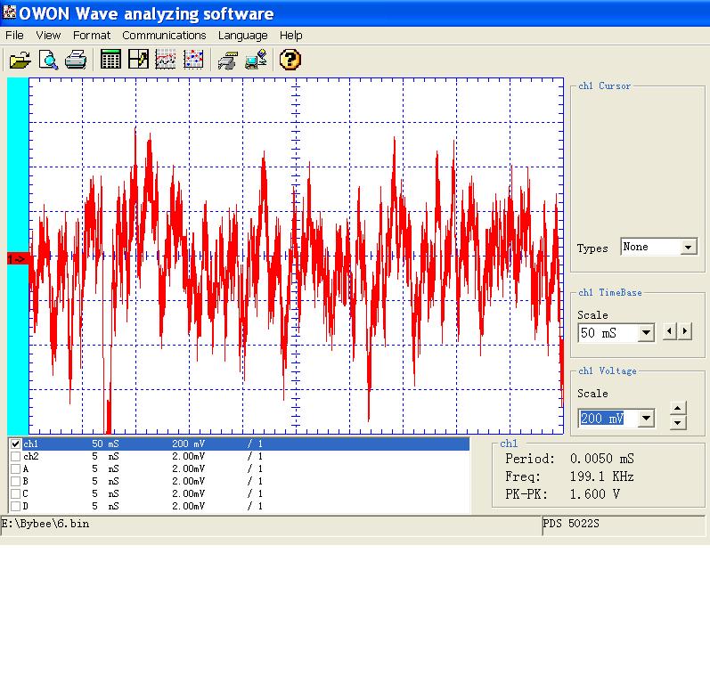

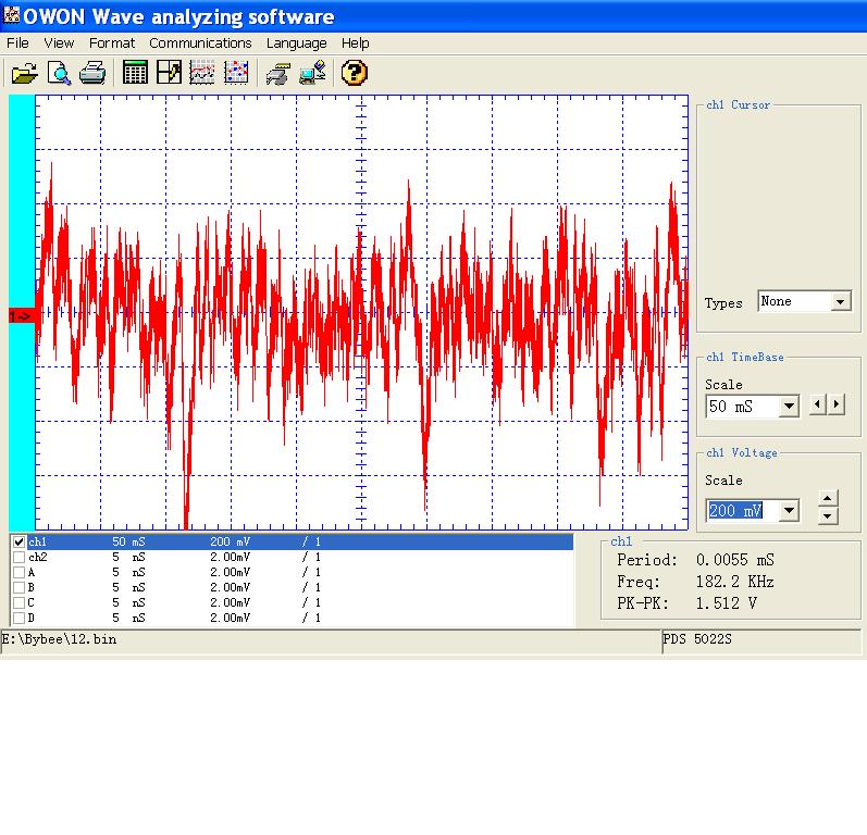

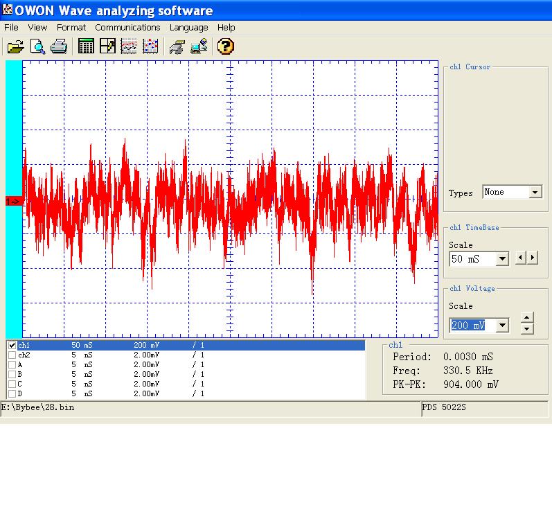

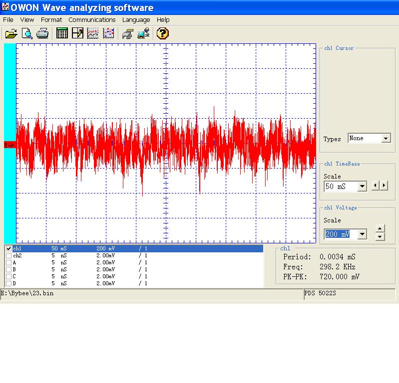

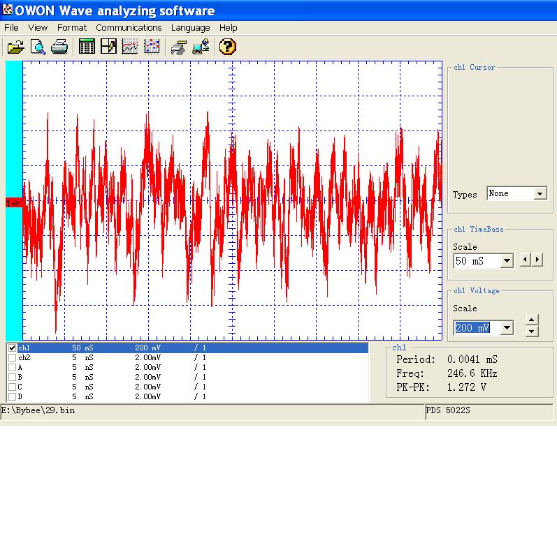

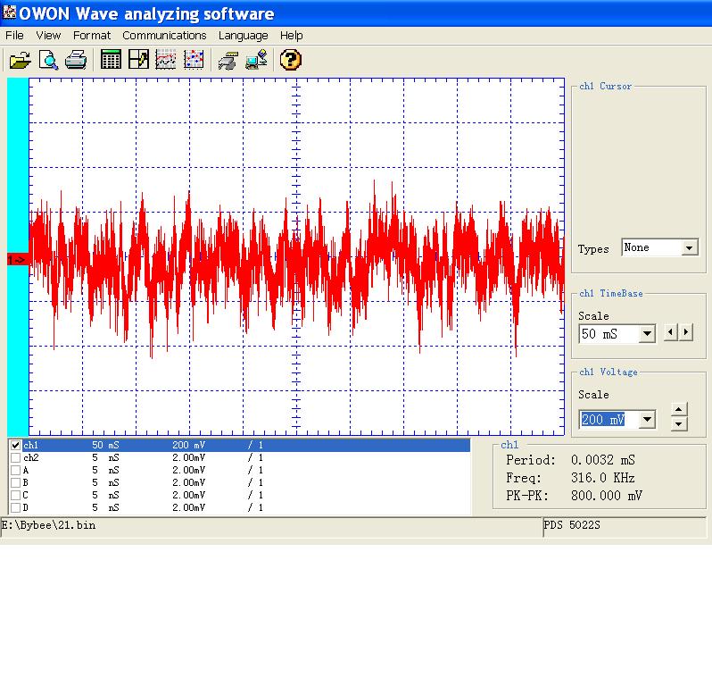

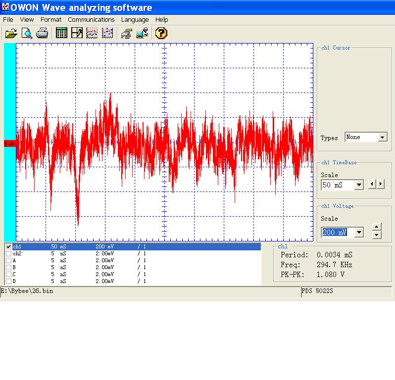

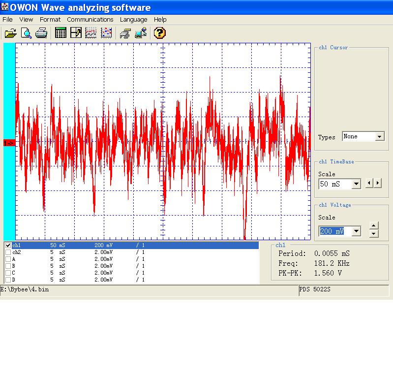

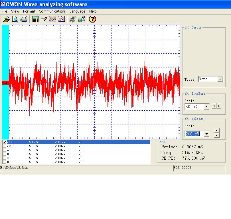

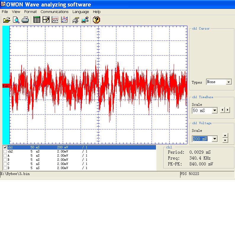

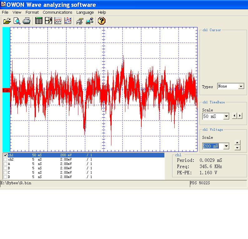

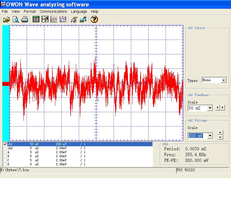

Well I took a white noise source and processed that with a two pole Butterworth low pass filter set at 160 Hz. This feed an Ashly NE2400 amplifier. The output went through the device under test and into an 8 ohm 450 watt load resistor. The voltage into the resistor was around 10 VRMS by my Fluke meter.
The pictures are shown looking across the device under test. Higher voltages indicate greater loss. I did 30 runs of various devices.
Attached are some of the shots. I'll post more after lunch.

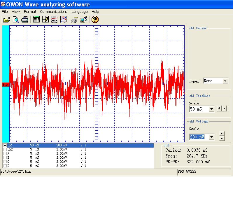

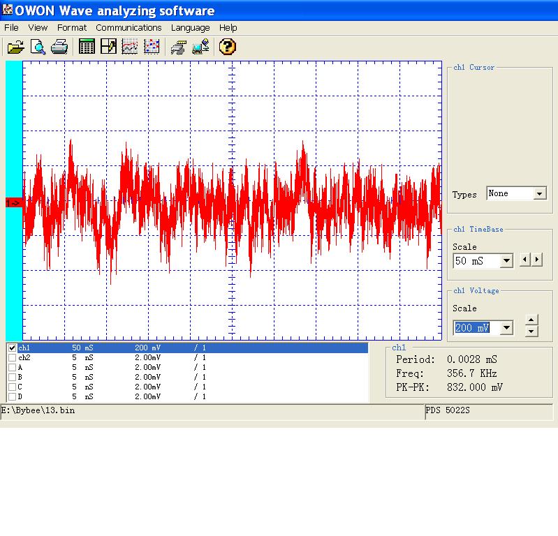

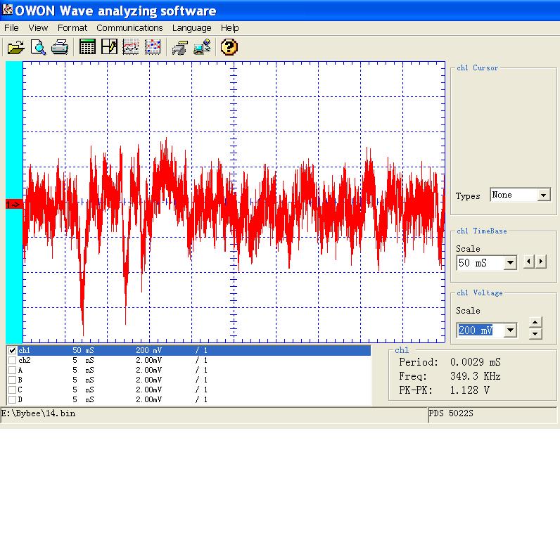

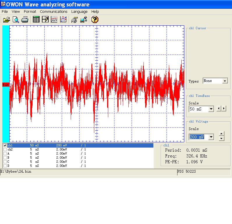

You've shown 20 scope pics, what specifically is the reason for them...what are you demonstrating?
jn
The voltage across the device under test. Sometimes it is my Bybee, other times it is not. I am curious as to the differences folks observe. Can anyone group the images?
In the lower left corner is the image number. Of course if you mouse over the images the name may also pop up.
